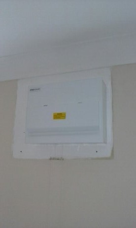

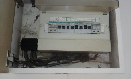

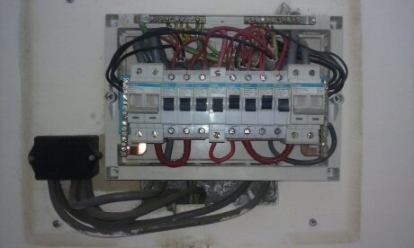

This is of a one bedroom flat, 3 MCBs on the left are night storage heaters, 5 on the right are the rest.
I changed it at change of tenant and change of agent to a single 14w CU for:
1) Create a single main switch which seems to have become an agents requirement.
2) Add all RCBO's for the 24H circuits.
3) Add RCD to E7 circuits.
The wooden enclosure was then cleaned, painted and replaced around the CU.
This is a low cost 'Pro-Elec' [CPC] at a total price of £162 at todays prices. I will always suggest a better quality unit like Hagar linked to for about £200 as the internal space is so much better than this, however this was chosen as it was one of the very few that fitted in the cupboard without having to extend any cables. E7 doesn't have to be 2 individual CU's
So yes I reckon your quoted materials cost of £600 is at least double what it should be.
