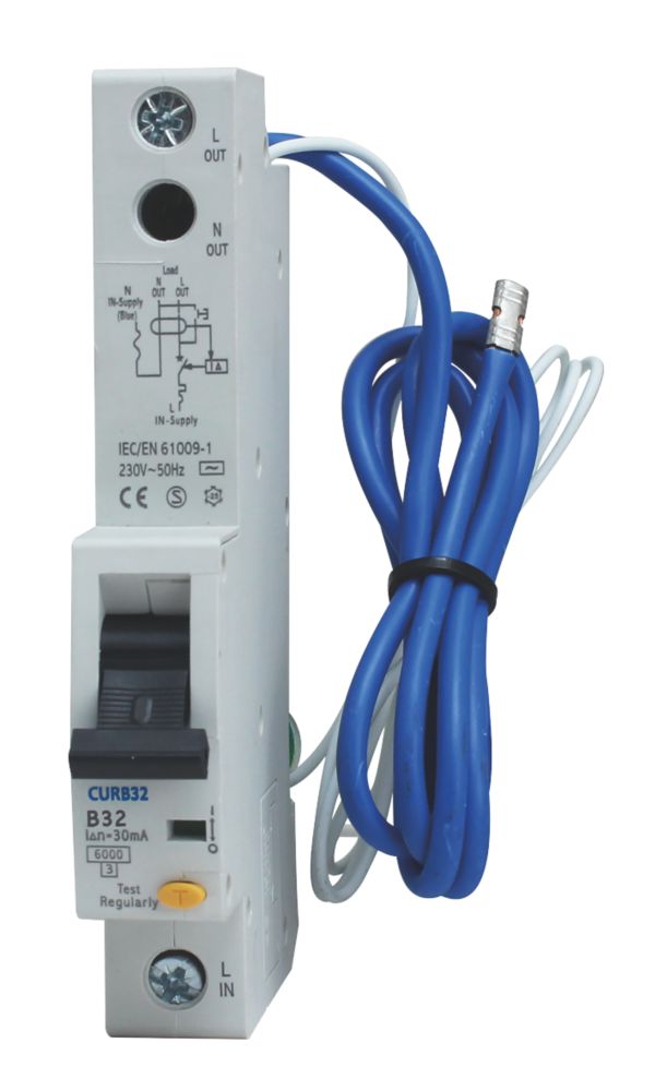

I have noticed that the live and neutral wires of the load circuit screw into the top of the RCBO unit. If the RCBO trips are the L and N disconnected?
thx
Live is always disconnected, the Neutral is only disconnected if the RCBO is a Two Pole device.
The Neutral has to pass through the RCBO in order for the RCBO to compare current on the Neutral with current on the Live and then trip if they are more than 30 mA different due to a fault somewhere on the circuit supplied by the RCBO
Thanks Bernard. A double pole RCBO in all slots on a CU is the ultimate then.
I suppose it would be, if one could afford it and could find double-pole RCBOs for the CU in question. Although I think there are some exception, I think that most DP ones are 'double width' at present - which could obviously lead to the need for a pretty 'wide' CU.
With single-pole RCBOs, a neutral-to-earth fault on one circuit will (if large enough in magnitude) lead to the circuit's RCBO tripping but, because that neutral remains connected to the neutrals of other circuits, under some circumstances other RCBOs could also trip.
Kind Regards, John
On the front of the Rcbo theres usually a schematic wiring diagram, it will as Bernard says likely show it to be Single pole
