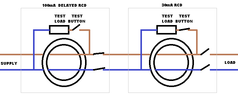

The 30mA downstream RCD should trip with the test button but that should never trip an upstream RCD
Where is the imbalance here?
Unles of course its one of the very old RCD's which used the earthwire for the test current.
Agreed - but I haven't noticed anyone suggesting otherwise. Have I missed something?
[Similarly, of course, pressing the test button on an upstream RCD should not cause a downstream one to trip]
Kind Regards, John
Only in OP.
Whoops, sorry, I missed that :oops: However, having now seen it, another thought occurs to me. As you say, eric wrote ...
... And in 2004 when we had a 10 mA RCD in the workshop, pressing test button also tripped the 100 mA S type.
I may be wrong, but I'm pretty sure that when we previously discussed this, and I did some experiments, we discovered that some/many/most RCD sockets and RCD plugs/adapters (all generally 'active' RCDs, the latter often 10mA ones) did inject a leakage to earth when one pressed the test button - and I think we decided that the most likely reason for that functionality was that it meant that the test would 'fail' if there was an inadequate earth as well as if the RCD was faulty.
If the 10mA RCD eric referred to was of that persuasion, it could presumably explain what he reported?
Kind Regards, John
Clearly the MK metal clad 10 mA RCD socket tests to earth not neutral. Unless it test the earth, you don't know if there is an earth to the socket, but 10 mA tripping 100 mA some one was not very selective in choosing the test resistor size. With the demo on RCD's not working due to being type AC rather than type A the test button is shown not to work, but had the current been 10 times the tripping current it would have done, I still have that socket some where, must see if I can find it, I had intended to use it for outside when my house only had two RCD's but never got around to fitting it, now with 14 RCBO's likely never will.
I know the test button was only to test the mechanical action, as clearly can't measure 40 mS with a stop watch, however I was not happy using the RCD tester on 400 volt, so where no neutral all I did was press the test button, which often did not trip either, as wired one phase to neutral, so would test phase to earth as no real option to do anything else. Common to find test button will not work when using a three phase and neutral RCD on single phase or three phase with no neutral.
I have seen the earth fly leads on RCBO's but not really worked out why they are there. Not sure how a RCD would work on an IT supply? Clearly since we must use RCD's in the bathroom and a shaver socket is an IT supply there is a conflict here. Seems 200 VA is OK in a bathroom but rest of house 30 mA is max? There seems to be an exception to every rule, and I know I am being pedantic and silly with the IT supply, however let us look at a real situation.
Yes, it's a big difference. I have no idea what test current the 10mA ones use, but I would not have expected it to be more than 20-30 mA (I think 30mA ones commonly use a test current of around 50mA).
Whatever, if (as I would certainly expect to be the case), that test current is less than 50mA, if it tripped a 100mA RCD thaen that RCD would have to be faulty ('out of spec') and ought to be replaced, wouldn't it?
