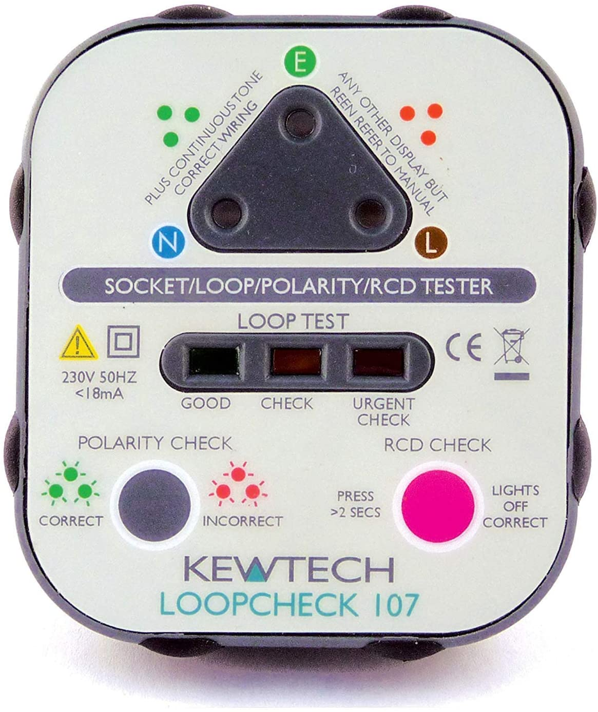

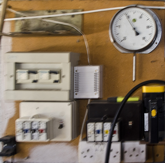

I'm not a REC, but I am checking a newly bought house with a generic circuit tester (it found bad wiring in another property). Plug in thing with RCD test button. Have two of them, different sources. Both do not trip the house circuit when I push the RCD button. I've not been able to get an electrician to call out. House has 63A ceramic fuse and old rotating meter.
Q1. Should the RCD tester trip something in the house?
Q2. Is there something specific to look for in the fuse box to confirm RCD is there?
Q3. Super simplicity please. What devices need an RCD at a minimum
Thank you. Just trying to find out if the place is safe while we find a REC.
Have you a link or photo of your tester? Beware of old fuse carriers as they can often contain asbestos.

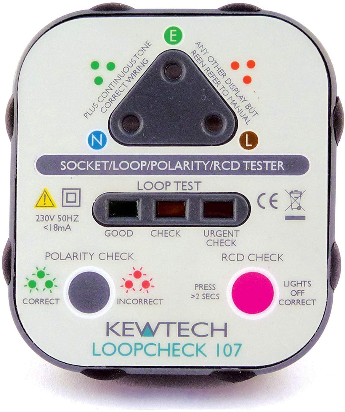

upload_2021-12-22_19-33-38.png For this model it says
If the LED goes out and the tone stops the RCD has tripped and is working.
If the LED remains illuminated and the tone continues, the test button has not been pressed for long enough to start the test. If the LED in the Loop Test bar goes out and the three LEDs in the grey triangle flash amber accompanied by a warble tone, the test current has been applied for 300ms and the RCD has not tripped. It should be investigated.

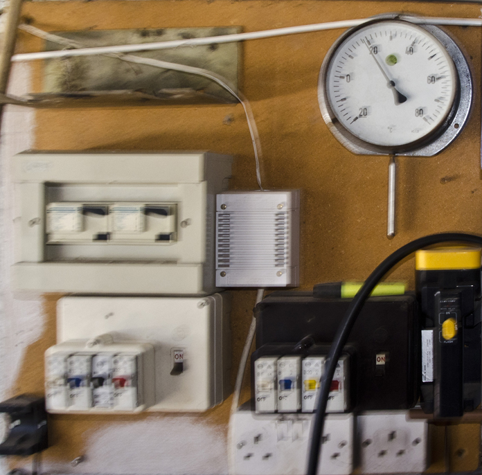

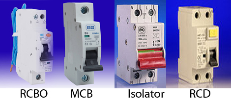

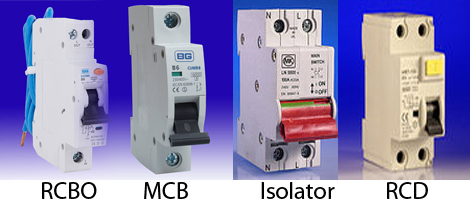

PartID_CU.jpg This shows what the devices in the fusebox or any other make look like. A RCD typically has a test button, the box containing them is called a distribution unit, the special type tested version used in domestic premises is called a consumer unit, we have not in general used actual fuses boxes for some time, you can get old fuse boxes with RCD protection Wilex-board-with-RCD.jpg but unusual.

If there is an RCD on the board is would be very obviously there. You’ll see a device labelled RCD (or sometimes the older ELCB terminology was used as a generic term on the handwritten labels).
It should be a wider module, with a test button and mention RCD or residual / differential and have 30mA printed on it somewhere. Usually they’ve a little circuit diagram on the module.
If it’s a very large device marked ELCB next to the meter, you’re likely looking at an extremely old TT installation which should be reviewed.
Diazed (ceramic bottle shaped screw in) fuses remained in common use in Ireland into the 1980s and some rather conservative electricians seemed to prefer them and took a long time to trust MCBs. So you can often find modern DIN rail boards with an RCD yet have Diazed fuse modules on the final circuits.
