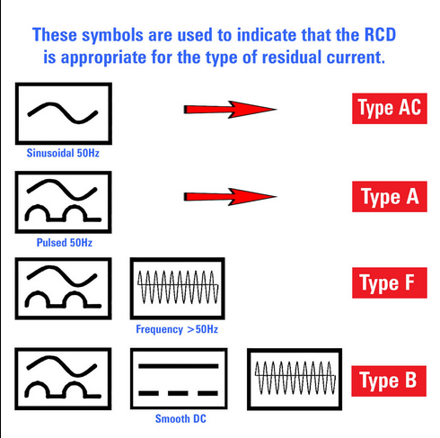

What type is the RCD? In the main to supply an UPS it needs to be type A or better, my UPS does not have a RCD on the feed, the RCD's are on the output of the UPS. Again type A.
It say 80A 30ma WRS80/2 which reading up is a type A.

That it's isolated is quite the assumption with anything modern, a number of them run in an ECO bypassed mode as switch mode power supplies are usually fine with the few ms of interruption, a number of designs also don't have galvanic isolation with the neutral referenced from the input:
I think using the symbols does cause confusion
but some of my old RCD's are that old the is no type listed on them. same goes for bi or uni direction types.
