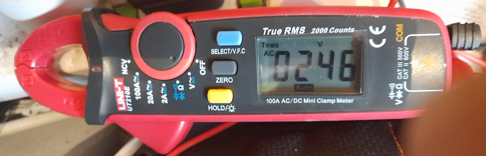

So the electrician may use his insulation tester and get a reading of many MΩ but he is testing with DC. Using a clamp on ammeter around both line and neutral we can measure the leakage, my whole house is around 24 mA, but since split into 14 circuits with RCBO's (a MCB and RCD combined) no circuit is near the tripping limit, remember 30 mA RCD must trip between 15 and 30 mA often they do trip at over 25 mA but it is acceptable to trip at 16 mA.

If you want to test an insulation tester VC60B.jpgand a clamp on ammeter Testing voltage.jpg both cost around £35 there are clamp ons for less, but not to measure down to 1 mA, so in your case best option is likely just to replace the pump. I think the one I got from Lidi was less than £15 and likely even if tested you will still need a new pump, so just replace it.
