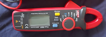

One should test background leakage, a meter like this

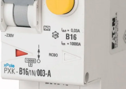

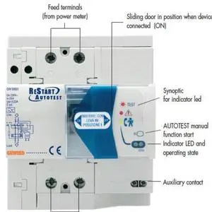

can be used to test leakage, however when I fitted the RCD's in the old house, there was no option of using RCBO's. So knowing the background leakage did not help, as little one could do anyway. The X-pole X-pole.jpg has a warning with the red arrow, but one is not going to sit there watching it, so not really much help. There are even auto resetting Auto RCD.jpgbut not permitted any longer with domestic, so it is really down to how much one is willing to spend to reduce the problem.

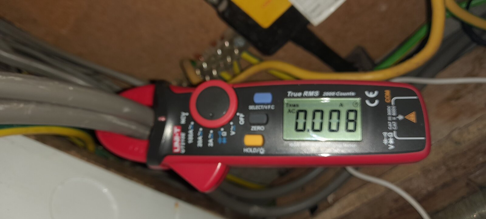

It is so easy to measure total earth leakage Diffrence line neutral 8 Feb 24.jpg getting the jaws around line and neutral into consumer unit is easy, showing my leakage of 8 mA, however to measure each circuit not as simple, as one needs to remove the cover from consumer unit to access line and neutral only.

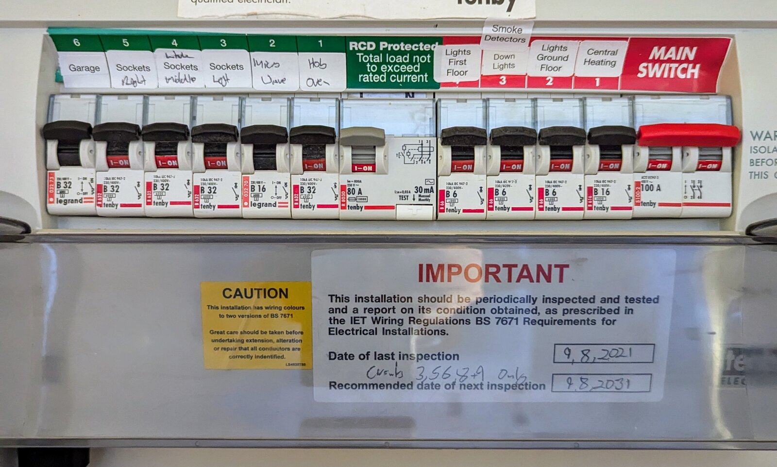

Five times 32 amps and one 16 amps clearly well exceeds 80 amps of the RCD. So I would look at the DNO fuse, it needs to be 80 amps or less, mine is 60 amps so would be OK. The cooker is a problem, turn it off at the isolator, and one loses the clock, same with microwave, so the idea of unplugging is not without problems.
Today, your set-up would not really be an option, one would want items like the garage to be on its own RCD, and having all three socket circuits on the same RCD does seem a little daft. But until 2001 we hardly used RCD's but by 2008 near everything had to be RCD protected, but regulations are not retrospective, and in the early days we could not get the single width compact RCBO's we have today, and we did not realise the problems having so many circuits on one RCD.

Eh, as far as I know the red flag on Eaton RCDs is a mechanical on/off indicator (green when tripped or off). For the Xpole MCBs I‘m certain it is, for the RCDs I‘d have to take a look at the datasheet. I live about 100 miles from the European Eaton HQs, so I see a lot of their products.
