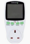

I did some years back have an extension lead with a section of outer insulation removed so I could used my clamp meter to see what items used, it has since been replaced with one of these 1719570276658.pngin fact also have two which connect to internet as well, however having an extension lead were one can get the clamp around line and neutral (the lives) without the earth, would seem a good idea to test leakage of items like the dishwasher, and washing machine.

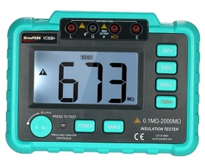

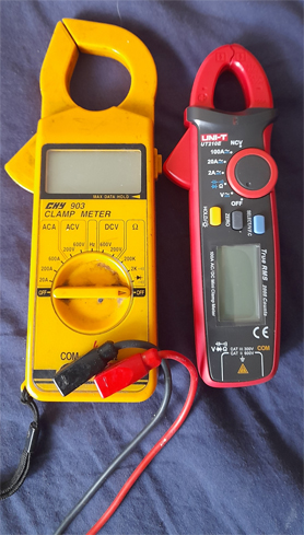

But still back to same question, what can @heliarch do to aleave the situation? I think the meter I got at £35 is about the cheapest to read in 1 mA incruments. I got the
as both 1 mA incruments and DC, maybe there is a cheaper AC only option, but price does seem to have gone up. My orignal meter Clamp-meter-small.jpg on the left only measured in 10 mA incruments, and that does seem to be the norm. It still works and measures frequancy so did not get the version of meter to right which could do that. But the other option was the same price VC60B.jpg and one needs to ask is it even worth measuring? He has a problem, showing what the problem is, does not cure it.
