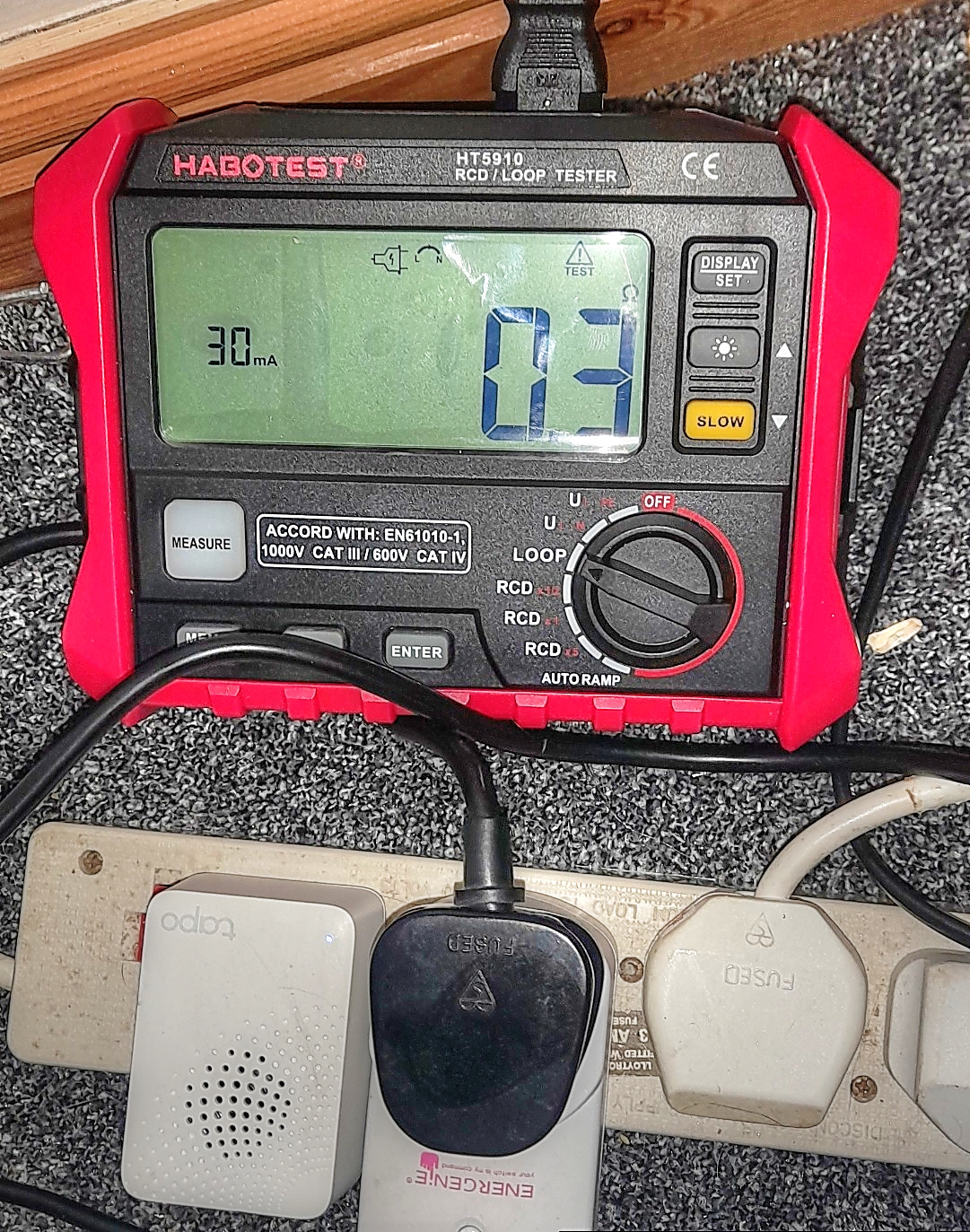

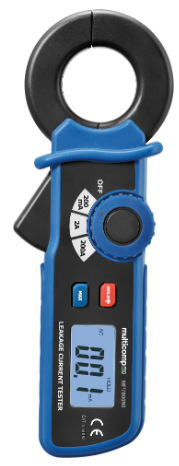

One can test the background leakage but, the meter cost me £35, 1740837691411.jpeg so not every electrician has invested in one. We are required to test tripping times, so most electricians will have an RCD tester, Loop-test.jpg mine also measures loop impedance, and will also have an insulation tester VC60B.jpgas the figures have to be entered in the paperwork raised, so can't get away without one, but for some reason I fail to understand, other than the model I have, most cheap clamp on meters will not measure 1 mA or DC, there was it seems to be a huge jump price to get a meter to test RCD leakage, this is changing, this first one1740838231479.png
goes down to 0.1 mA at £40, but no DC and rated at 60 Hz, the second one 1 mA £27.54, so prices are coming down, but if you already have a clamp on, it's a lot of money just to check background leakage when you are not required to record it, it should be no more than 1/3 of the RCD's rating so 9 mA, but if you have bought one of these
which cost an arm and a leg, over £100 one can see why they would not want to return to using a cheap meter, never really worked out the advantage of a open jaw meter, my cheap one (£35) does me.

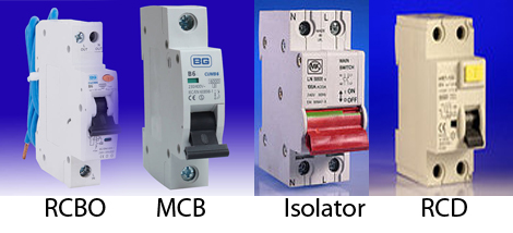

The Isolator is a simple two pole switch, the MCB is an overload, the RCD checks in and out match so unlikely any current goes to earth, and the RCBO combines both MCB and RCD together.
The consumer unit (CU)
has progressed over the years, today few would use RCD's the RCBO is now normally used, that means you gain 4 slots, although two often used for the SPD (surge protection device, but to change the CU needs to be current. The kit
costs £26 and although these can be got 1740865043822.png to get all the bits, will likely cost more than a new consumer unit. And a Powerbreaker IP40 White RCD Twin Switched Socket 10Ma - Passive Type A comes in at £38.32 the 30 mA may be cheap but not 10 mA.
