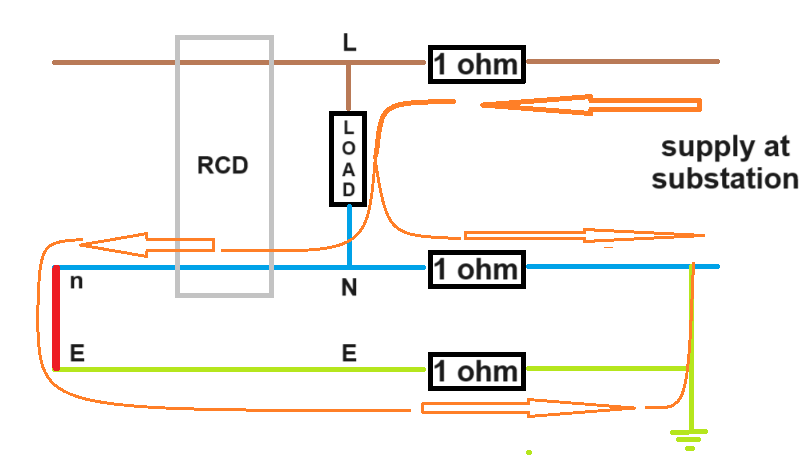

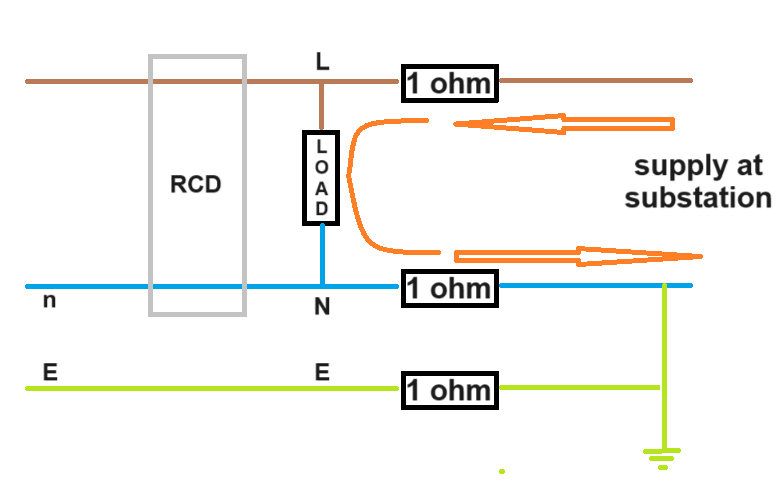

There appeares to be a little confusion going on here, hopefully I'll not add to the confusion.
The sketch is a fairly representative of many installations except I show an excessive loop impedance of 2Ω
Thr current in the load prior to the RCD is shown in orange, this may be the other loads in your own property on the other RCD in the 17th CU or in the neighbouring properties.
Lets say the load is drawing 20A and the source voltage is 240V, the volt drop across the 1Ω cables will be 20A x 1Ω=20V ∴ point 'N' will be at 0+20V=20V and 'L' will be at 240-20V=220V RELATIVE TO 'E'. Additionally the point 'n' will also be at 20V relative to E.
Shorting 'n' to 'E' will result in the current taking 2 routes back to neutral except the current will be shared by the neutrl and earth impedances, in this instance 10A each or dropping 10A x 1Ω (same as 20A x 0.5Ω as resisters are in parrallel) meaning there is 10A flowing through the RCD.
Obviously these figures are manufactured for the explanation and potentially excessive.
Thanks for the drawing @SUNRAY , no confusion here. Your drawing has the load on the wrong side of the rcd and your maths doesn't match up with it - the current is still returning to the RCD neutral bus but travelling back up the neutral and out through the earth. Really it's the difference of your ze/2 to your r1 r2 of the isolated circuit (neutral and cpc in this case).
No, the load is the correct side and nothing to do with the circuit being discussed (and possibly not in the same property). the op stated line is isolated, ( presumably the following MCB is switched off or line disconnected)
