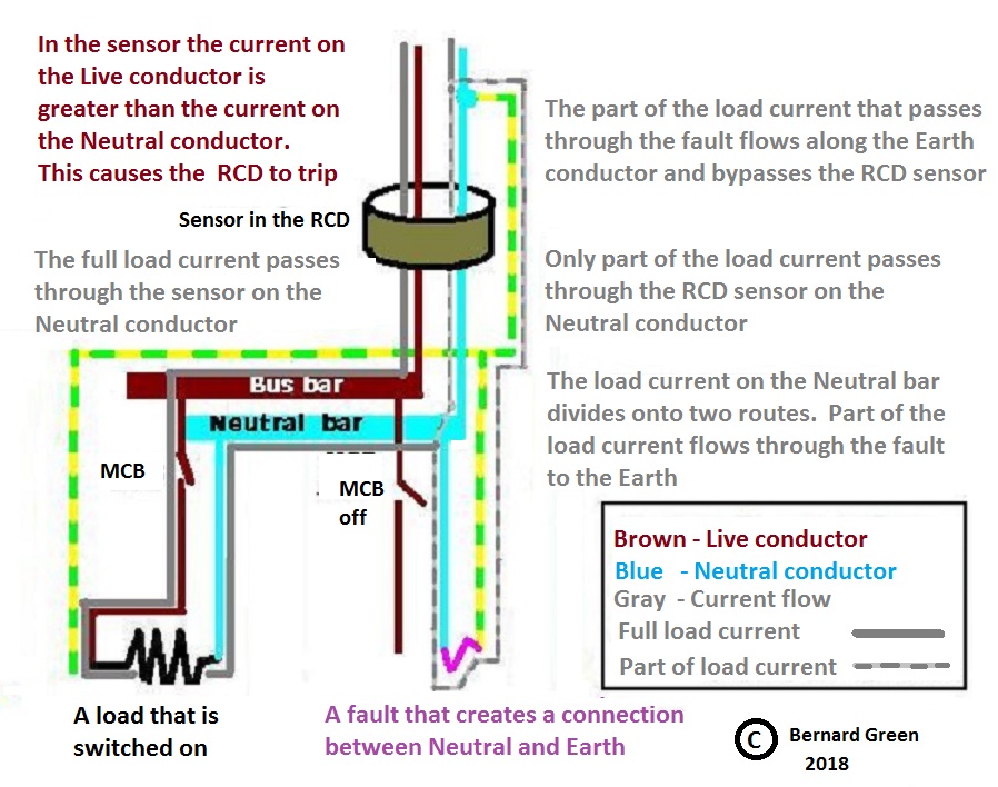

RCD tripping but not MCB indicates a neutral to Earth fault - is that correct

The MCB if switched off as you say only switches off the line, so anything with a neutral fault will still trip the RCD.
Neutral and earth with no load in a TN installation are the same voltage, only as you put a load on it does the voltage between the two vary, so it can be misleading where it seems some thing big causes the tripping.
However 30 mA at say 5 volt (difference between neutral and earth) is 166 Ω and at that a multi meter may detect it, it is worth a try. In the main we take a stab at likely cause, outside light is first on list.

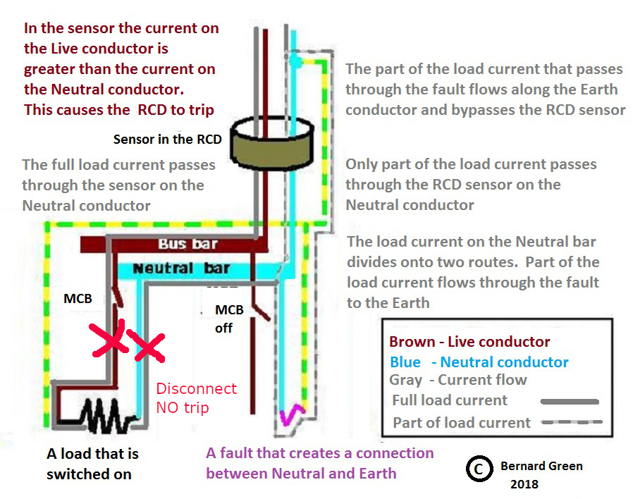

I am sure a L To E fault can often trip an Rcd without the Mcb, that fault can often be traced to a circuit via isolating individual Mcbs.
It basically takes 30ma to trip the Rcd, far less than to trip an Mcb.
Neutral to Earth faults can also trip Rcds, often with out an Mcb going off, these are harder to find, as The source current tripping the Rcd can be from ANY of the attached circuits and not necessarily the Circuit with the actual N to E fault, from experience i have often found N to E faults on lighting circuits have not tripped Rcds till Higher load circuits like cookers etc, are in use.
Only xmas was called to a house with a main Rcd going off when cooker was in use, told all started when so called electrician put up a pendant, when checked he had screwed through the twin and earth, shorting N to E, however the lights all worked fine as said, till the cooker was turned on. the customer was all prepared to bin the cooker and miss there xmas dinner.
My initial test, if no sensitive loads, is to do a global test of the circuits fom the Db and if low readings start disconnecting relevant circuits[/QUOTE][/QUOTE]

thanks very much for the drawing - edited showing where I'm breaking the circuit to solve the RCD tripping.
So it must be in that circuit as the Earth is still connected up - But cannot return on neutral as disconnected OR Live , as you mention some issues.
