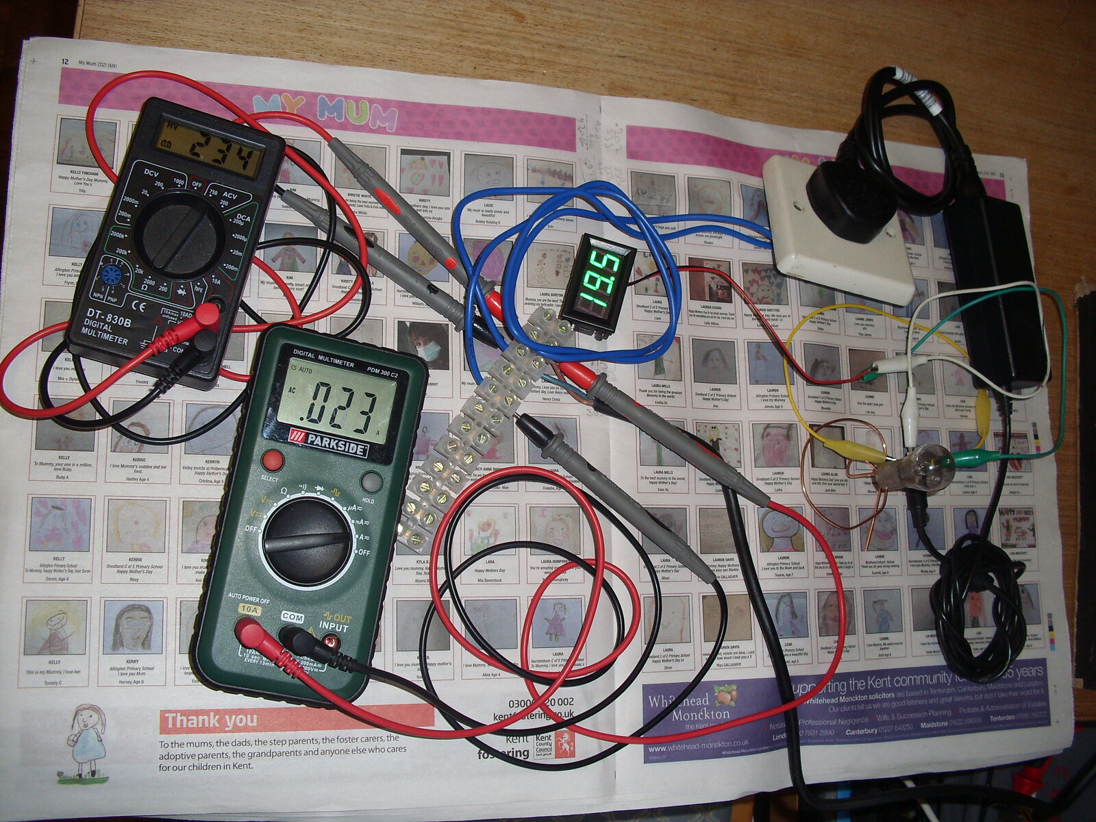

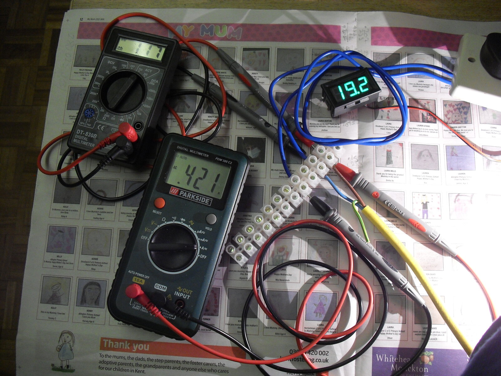

Hopefully this pic shows a mains supply [black cable at bottom of pic] and a volt meter [top left], an ammeter feeding a 13A socket via 2 blue wires. Plugged into socket is a laptop SMPS with LED voltmeter. Also showing is a 12V 21W car bulb but not connected.
234x0.023=5.4VA

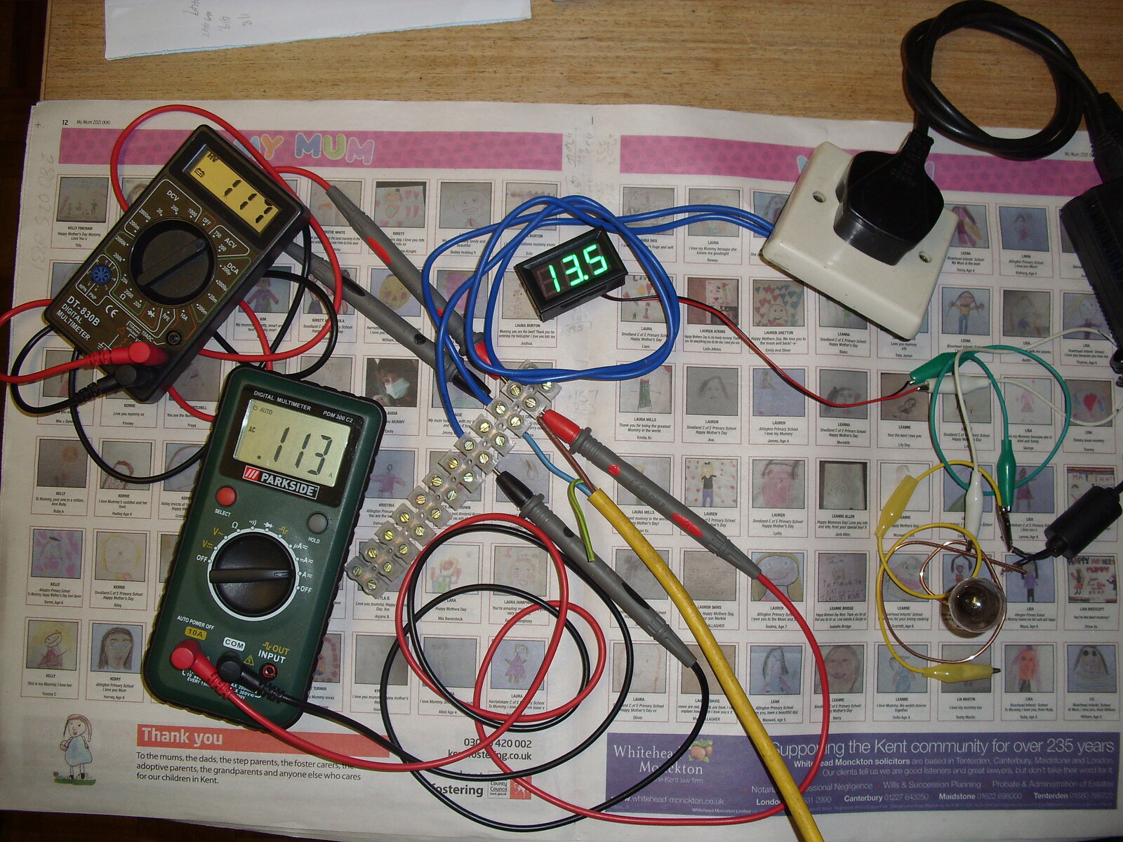

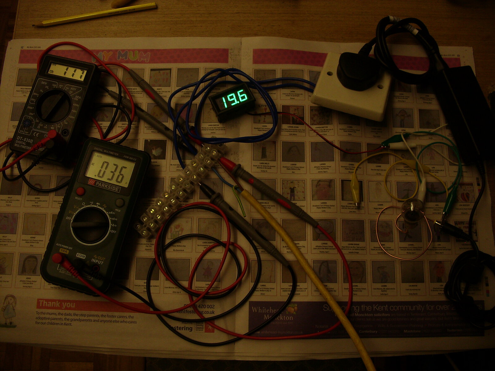

Same set-up with 110V supply:
117x0.036=4.2VA, demonstrating the SMPS is more efficient on the lower voltage with 2mA load [LED meter]

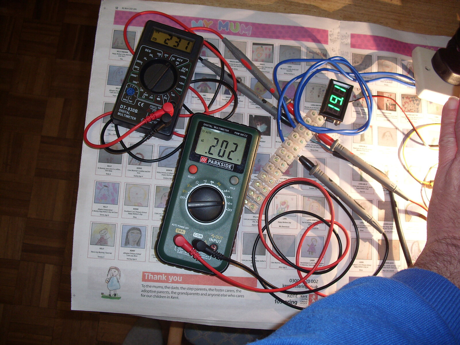

Connecting the 21W bulb:
231x0.202=46.7W

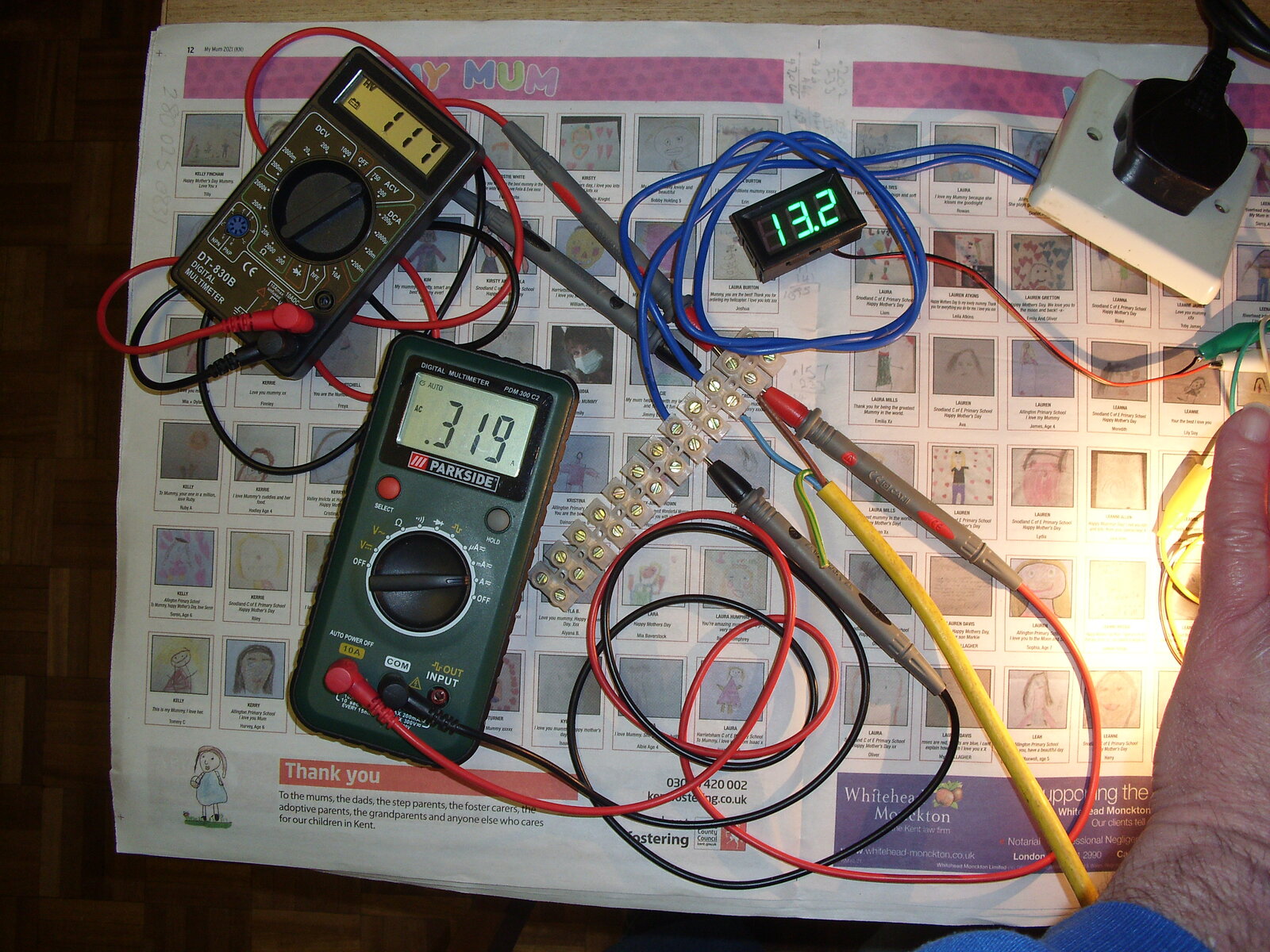

117x0.421=49.2VA demonstrating 5% less efficient.

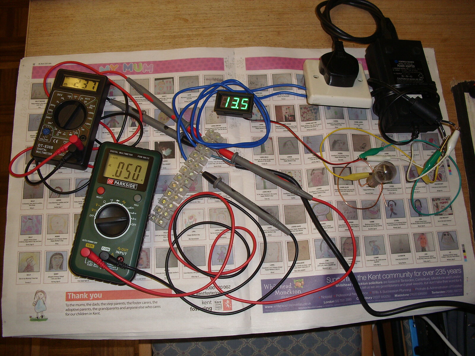

And another SMPS:
237x0.05=11.9W

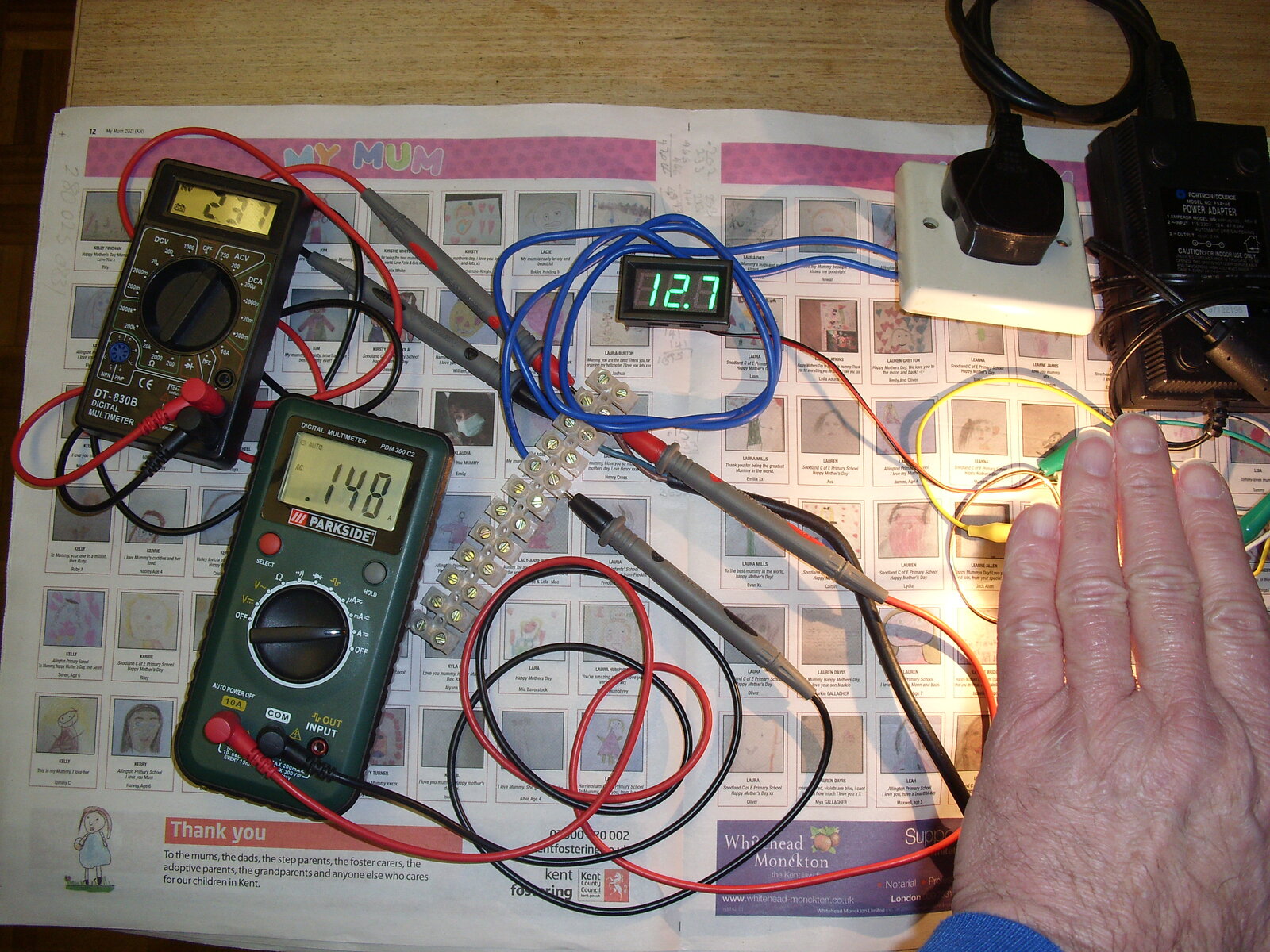

237x0.148=35.1VA

Your experiment does not measure watts, it measures VA. All that could mean is that the watts is constant but the power factor is worse. i very much doubt the power factor remains constant at different input voltages Thy doing it again with a wattmeter.
Your experiment does not measure watts, it measures VA. All that could mean is that the watts is [are] constant but the power factor is worse.I very much doubt the power factor remains constant at different input voltages Thy [Try?] doing it again with a Wattmeter.
