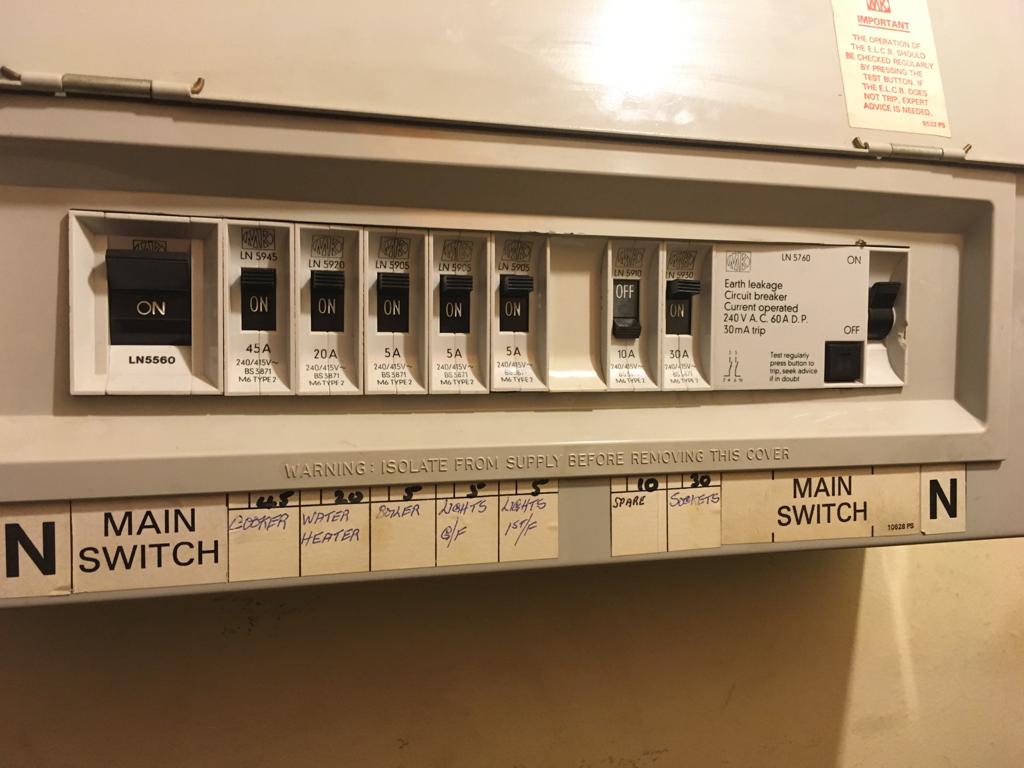

RCD Tripping emegency Electrician cannot fix
well, still not sorted, spent 6hrs on it yesterday , taking all the Cu leads off , sockets removed - lights and fans disconnected , they cant get a replacement RCD , but it tests all OK, and then randomly trips - 2 other electricians involved from the team
so now a new consumer unit is going on, New Ring for kitchen and other Rings sorted out ........
i'm sure this is something simple now - maybe a mouse laying in a cable after chewing but should show up on a insulation test , screw in a cable when the refitted the downstairs cloak room and shower - or a faulty RCD - BUT ........

Could it be a bulb on its way out, just a suggestion.
Who knows, but I've never come across a bulb/lamp of any sort behaving in that fashion. In fact, since bulbs/lamps invariably don't have earths, it's very hard to see how one could result in an RCD trip, no matter what was happening within them.

Just thought i would update to finish this tread
new consumer unit with spike protection and all RCBO's installed today - and they also found loads of problems with the kitchen wiring, when they took all the sockets off (which they do as part of th einstall - then take all sockets off around the house - and test ) they had to strip out all the kitchen wiring rewire, at least the message and photos sent.
they found 1 socket very badly wired - with exposed cables and poor connections , but none where good in the kitchen....
anyway - all sorted now
Makes you wonder why a meggers exist if you cannot use them to check parts of circuits.....
yep, my thoughts as well, i kept asking what the insulation test results showed - I would have expected a test at 500v should have solved - But anyway its all resolved - hopefully
