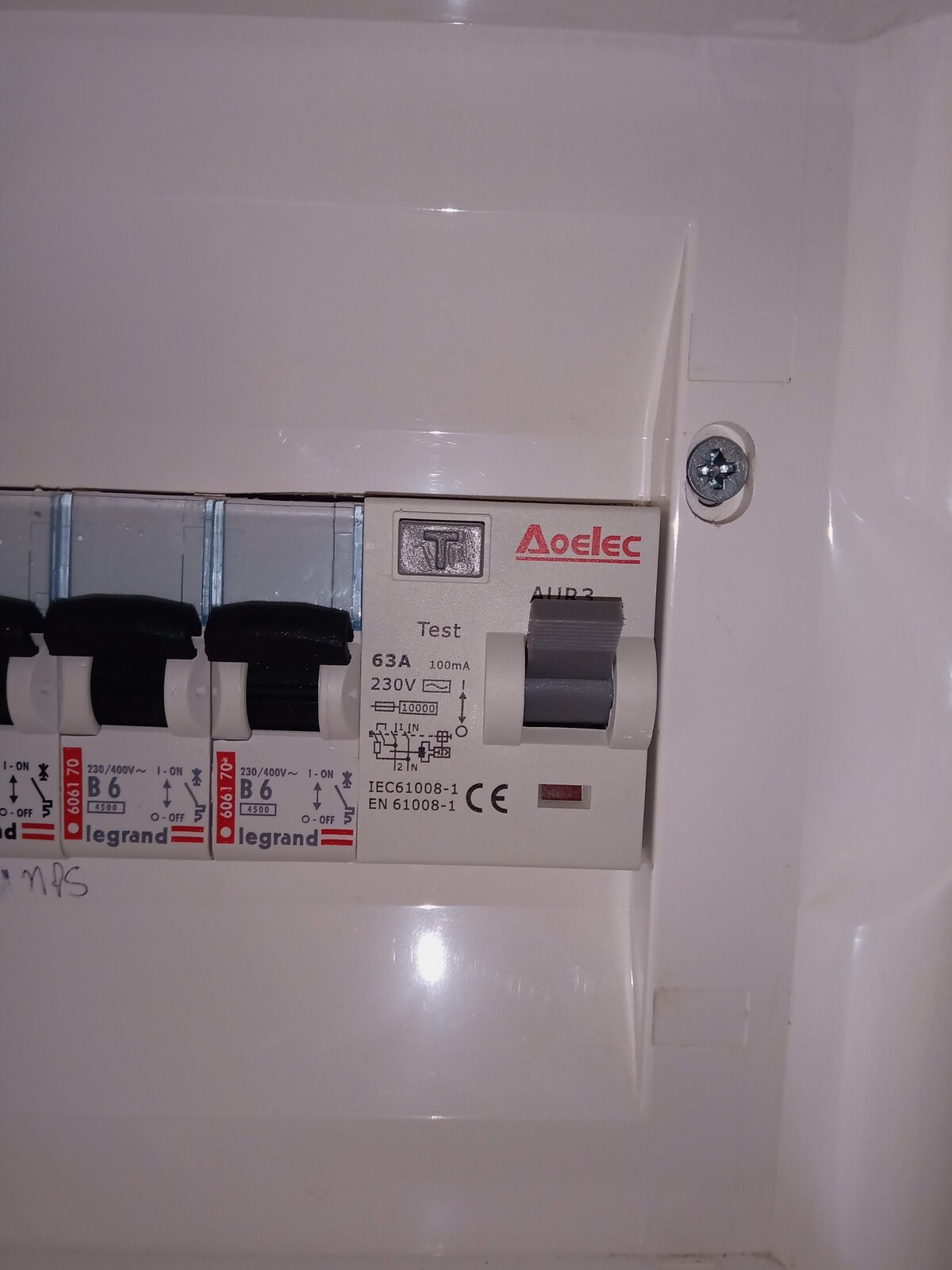

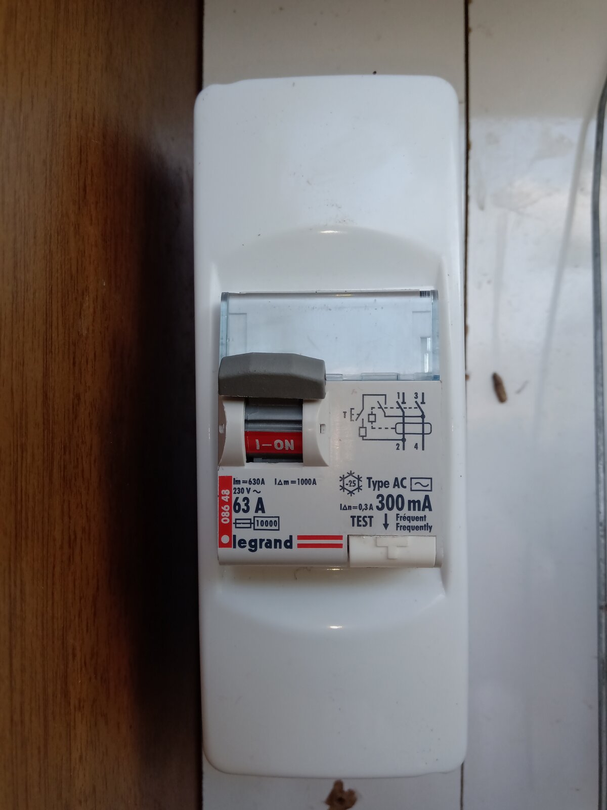

Hi guys,
I'm having trouble with a 63A 300mA RCD in my meter cupboard that is randomly tripping. I'm suspicious of the smartish meter that was installed not so long ago. The RCD covers my tails into my consumer unit which is around ten metres away. The tails are in plastic conduit under the floor. In my consumer unit there is a 63A 100mA RCD covering eight circuits switched with MCB's from 6 Amps to 32 Amps. The 100mA RCD doesn't trip. I've tested the tails and they are clear. It's a TT system with a couple of rods knocked down in the garden.
Any ideas anyone? I was thinking maybe I could replace the RCD in the metre cupboard with a double pole MCB but I don't know whether I would need 1P+N or a standard double pole breaker would do the trick.
I've just started taking note of when the trips are occurring. Three days ago it tripped at 10 am and it tripped today at 10.10am. I don't have any timers in the house and all breakers are live continually.
Cheers

post a picture of both RCD's.
Does the internal one have a marking S
Press the Test button on the internal one, and ensure it trips
Thanks for your response ericmark. The 300mA rcd is a Legrand 086 48. The rcd in the dist board is a Doelec AUR3 ( I think it must be Greek as I'm in Cyprus). Both units show 230v and an ac sinewave. I don't have a megger with me, just a crumby multimeter
