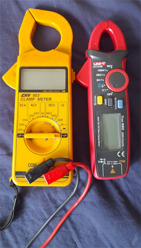

It should have not behaved like that, but it did. My old clamp on, bought in Hong Kong before take over, left Clamp-meter-small.jpg seen here with new one right, old one would measure frequency which new one will not, but new one also measures DC amps, and resolution 1mA rather than 10 mA with old one, and also has non contact voltage detection in 4 stages. 30 years between them old one 300 HK$ (approx £25) new one £35 things have moved on.
The old one never showed a fault with old house, but since the pass level is 9 mA and it did not register less than 10 mA not surprising.
New one so easy, as shown post #2 on incomers to consumer unit to read the leakage, and questions like borrowed neutrals so easy answered, if trips and not showing leakage on clamp on, clearly some wiring fault. But my failure to find any fault with old house, makes me realise an insulation tester great for finding fault when tripped, but not so good working out if there is a build up of leakage due to filters etc. As interference suppression capacitors and inductances will not show up with DC testing.

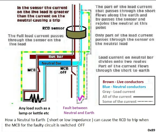

From the first time I started to work with RCD's on returning from the Falklands and working on the building of Sizewell 'B' I have said the big problem is we often don't switch the neutral. So to work out what is causing the problem we need to unplug, or turn off isolators. So cooker isolator clearly cookers don't unplug, boiler switch on the fused connection unit, drawing the fuse no good, same with immersion heater, and even then not all switched FCU switch the neutral.
This picture
posted many times on this forum not sure if @bernardgreen own image? Seem to remember the late Wesley use to post this image, but it does show the problem with neutral earth faults, which is not a borrowed neutral fault.
yes agreed
