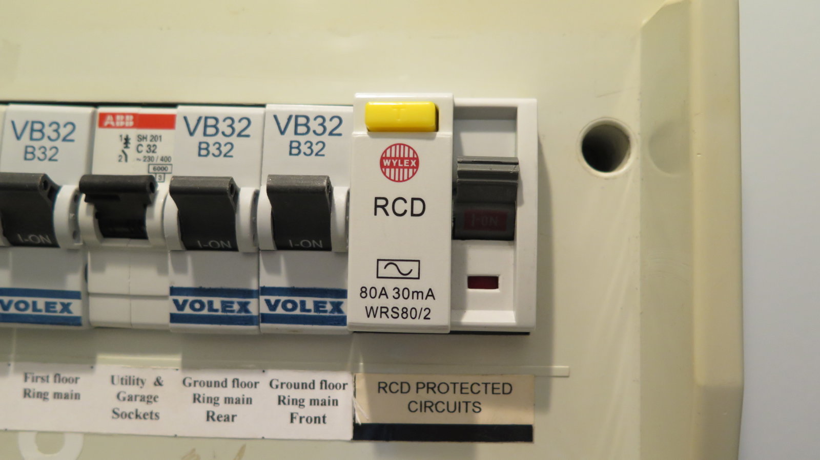

Post a picture of the device that trips, and some of the fusebox / consumer unit and general area around it.

This is the RCD that keeps tripping.

I always start looking at outdoor fittings, especially if it trips when it rains
