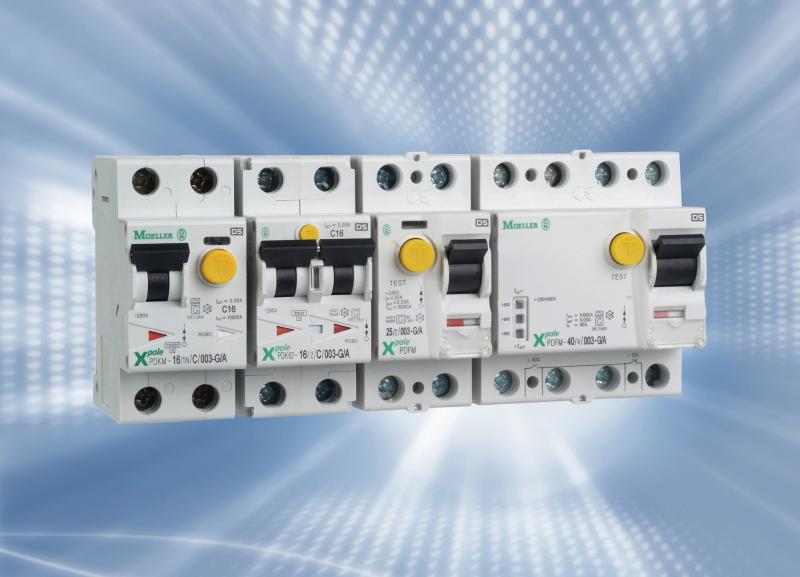

I saw in a trade mag a RCD with built in RCM which changed LED colour and started to warn at around 50% and did not trip until between 90% and 100% but can't find it.
Any ideas what make they are? And where to get them?
Thanks but not what I was looking for. The mag I read showed a RCD which had RCM built in so giving a warning that leakage was getting high. And instead of tripping between 50% and 100% as normal it tripped between 90% and 100%. But can't remember where I saw it or what make.

:evil: this :evil: :mrgreen: found me this on the first page of results....
Spot on it was what I was looking for. I had tried loads of googles but had not tried the phrase you used.
"The system is in a state of alarm and the digital RCD will only trip if the residual current increases beyond 90% of the IΔN." still complies with tripping between 50% and 100% so can't see a problem.
Anyway want for my own house so it's not for use of ordinary person so until I move it will comply.
Once you put me in right direction also found this but as yet can't find a price. I thought this
was great until I found the price at around £350 each I think I can walk out to garage and reset manually.

I think the device shown is only a monitor and does NOT provide disconnection of the supply
From the description
The PDIM residual current monitor, which is just four module units wide, is a remedial measure. If such a monitor is connected in series before or after a Moeller residual current device, it makes it possible to always monitor the current system status.
The reset applies to remove the alarm condition on the alarm contacts.

OK look the part but the B16 rating may present a problem would want B32 for ring main.
The other two seem to be 25A and 40A both a bit too low to use in a consumer unit.
But price is the main thing. What do they cost and where can you get them.
Moeller is Eaton/MEM so most wholesalers should be able to sort you out
