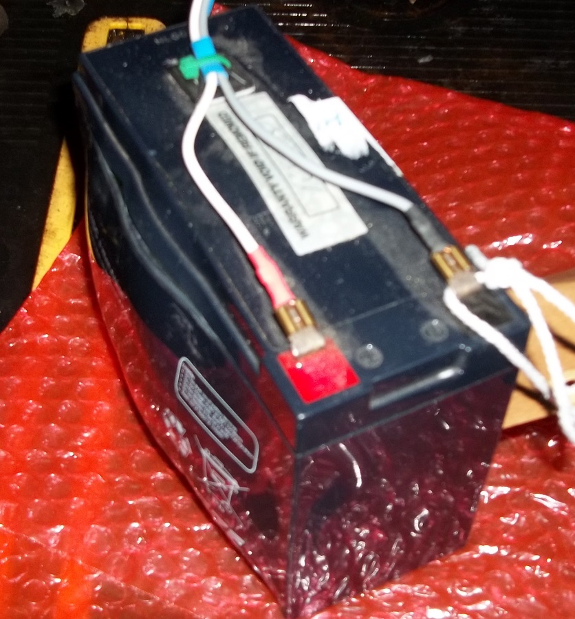

A stair lift has been unplugged, plugging back in the batteries would not recharge, quick cure new batteries, however I suspect the only fault with old batteries is over discharged.
Now I have an old unregulated battery charger, however 12 amp is rather over the top for a 7 Ah battery, but my smaller chargers seem to have a safety device built in which results in it displaying Err (Which I assume means Error) when I select charge.
I am using this Lidi charger however most chargers designed for small batteries are the same, in motor cycle mode limited to 0.8 amp designed for batteries 1.2 to 14 Ah.
Only way I can charge the battery is to connect it in parallel to my 75 Ah caravan leisure battery, it does not seem to want to charge them stand alone. It states Err shown if over 15 volt (or under 3.5 volt) now although 0.8 amp is not much, however for 7 Ah maybe still too high?
So what I am wondering is the battery simply faulty, or is the charger not suitable? As said batteries were working fine until stair lift switched off. But I have not really got much experience with such small batteries.
When a battery is over discharged the best way to recover it is a slow trickle charge over several days, preferably from a constant current source that will increase it's voltage as the battery recovers. Otherwise a variable voltage power supply with a suitable series resistor and manually adjust the voltage from time to time.
Forcing too much current to speed the recovery can have un-expected and potentially hazardous consequences,

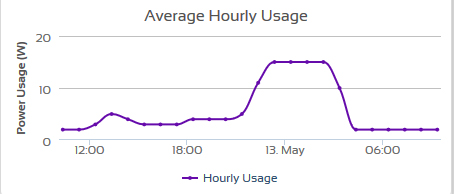

Charger is powered from an energy meter, so remotely I can monitor charge rate, at the moment two watt, at 84 watt/hour it seems likely it will take two days per battery, so it will take some time before I know if batteries have recovered.

This was a surprise. Although I have tried to renovate many sulphated batteries, I have not used this type of charger before or had a device monitoring the progress. The graph shows how I discharged both batteries then returned them to charge with the bump just after 12:00, this is where the charger was pulsing between 0.1 amp and 0.8 amp as the voltage keep rising and falling, it then settled at the 0.1 amp charge rate until 18:00, at this point the second battery of the pair started to accept a charge, at 20:21 (can read on monitor software exact times and input to charger) the charge rate started to rise 4W, by 22:21 (dot half way up) it was an average of 11W the charger was actually swapping between 0.1 amp and 0.8 amp it was the mark/space ratio which was changing. By 23:21 it was drawing 15W so charging at 0.8 amp which held until 02:21 after which again mark/space ratio changed and average current started to fall, 3:21 down to 10W and 4:21 dropped all the way to 2W.
To recap started to charge on Wednesday had to put batteries in parallel with a 65 Ah battery to get battery charger to hold on charge, as otherwise it detected over voltage and auto switched off. So the first 7 Ah battery to recover one could not see the graph as masked by the 65 Ah battery, it took two days to be able to charge just the two 7 Ah batteries, and neither could be charged on its own only charging two would the voltage hold below the 15 volt cut off point. Then one of the pair seemed to be working as expected, it would run a cool box used to load the batteries, so paired them up again to see if second battery would also come up. The surprise is the delay where I was convinced the battery was useless, then a sudden change where it accepted charge.
It has taken 5 days for the pair of batteries to recover, the major problem was any standard car battery charger could bang in 8 amp and cause the battery to explode, so wanted a battery charger with low output, however the safety features on the Lidi battery charger used (switched off once 15 volt recorded) stopped simply clipping on leads and leaving. Had I had a constant voltage power supply to hand then maybe that would have worked, but only way I could generate a constant voltage was the 65 Ah battery in parallel.
I would have not spent so long with an unknown battery, but I knew why they had failed, the chair lift had been unplugged, the stair lift in question did not have a manual method to return it to charging station, so needed a second pair of batteries to get it to charging station. I had intended to try recharging the batteries the next day, but they went missing. So it was not until my father-in-law died that they were found.
I would question the whole idea of a 7 stage battery charger claimed to revive sulphated batteries which needs 7.5 volt in the battery to see it as 12 volt and start the charge, although the pulse charging worked, with such a small battery it jumped from pulse to 0.8 amp but before it could drop to 0.1 amp it had hit 15 volt so switched off.
