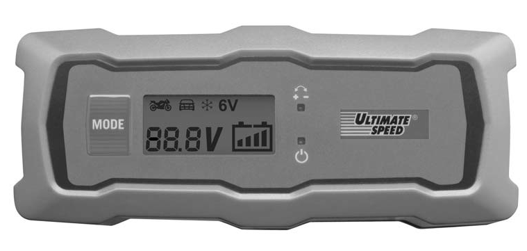

The point I am making is it takes a long time, with nothing to show anything has happened. I had this battery with around 12.9 volt showing on the charger display for three months, it seemed the battery was completely dead. With the Lidi Charger
I could not use the charger without another battery in parallel as at 15 volt it auto switched off, although it seems good that it will charge 6 volt as well as 12 volt, it also means the battery voltage must be within the range 7.5 to 15 volt, under 7.5 it thinks it 6 volt. The sulphated battery must have been taking some charge, but so little the charger behaved as if the leads were disconnected. So only way was a battery in parallel.
Although instructions don't tell you, it has three charging rates which it will auto change between, the first two 3.8A and 3A it will never auto return to, so voltage raises to 14.4 volt with 0.8A charge, then it drops to 0.1A charge and battery voltage falls, if it drops to 12.8 volt then it returns to 0.8A charge, however if it continues to raise as it hits 14.4 volts the second time it switches completely off. At which point the battery voltage starts to fall, once it falls to 12.8 then whole process starts again. So in the main I would walk into the garage and it would show 12.9 volts.
I had given up, I really did not expect the battery to ever come up. We as I say are talking about 3 months on charge, the battery was on a wheel chair, it was given to me without a charger, and the first Lidi charger did not have a voltage display, and it would put enough into the battery for around 1/2 mile, but then the charger failed and wheel chair abandoned back in 2013. When the 7 Ah batteries fitted to my father-in-laws stair lift recovered I thought worth a go with the 20 Ah.
From what has happened with the other batteries, once batteries fully charged I expect to see voltage at 12.9 volt, at the moment 13.4 volt so clearly still taking charge, once fully charged the voltage will raise to 14.4 volt, charger will turn off, and within a minute or two it will drop to 12.9 volt then slowly it will lose that last volt then charger switches on for a minute or two volt go to 14.4 again, and yet again it drops quickly, so 9 times out of 10 when you look a good fully charged battery shows 12.9 volt.

Now charging again using a steady 13W which will relate to 0.8A. I am really chuffed, I never expected it to come up.
By Wednesday current dropped to 0.1A at 13.8 volt and by Thursday volt up to 14 volt, at 14.4 volt charger will auto switch off, at which point the charging is considered complete.

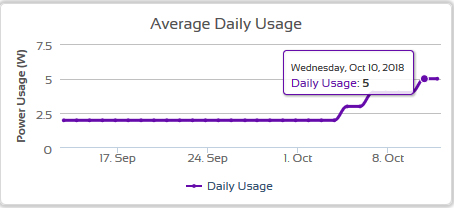

A surprise again, I expected the charger once the battery had absorbed a bit more to drop to zero output, however it has started charging all over again, all I can assume is the cells are recovering one by one, which would explain the steady 11 volt under load, it shows it using 6 or 7 watt at the moment which is not really possible, the charger gives either 0.1A or 0.8A so 2W or 12W the refresh rate is too slow for energy meter to show this, what is happening is at 0.1A the voltage drops to 12.8 at which point it switches to 0.8A and the voltage raises to 14.4 at which point it switches to 0.1A again.
