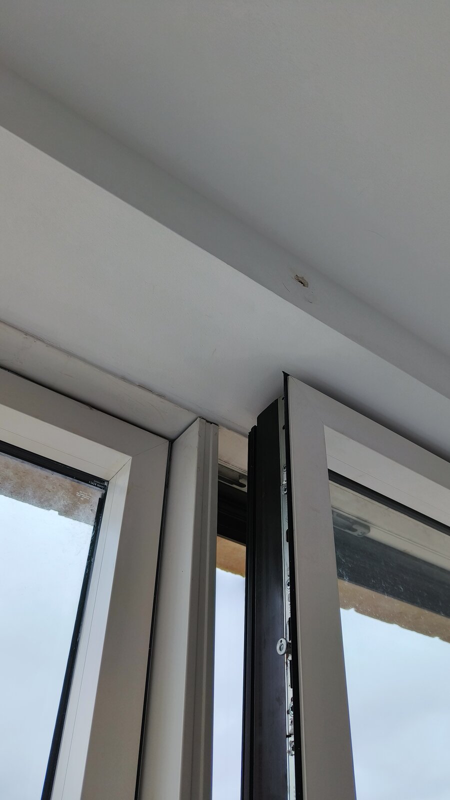

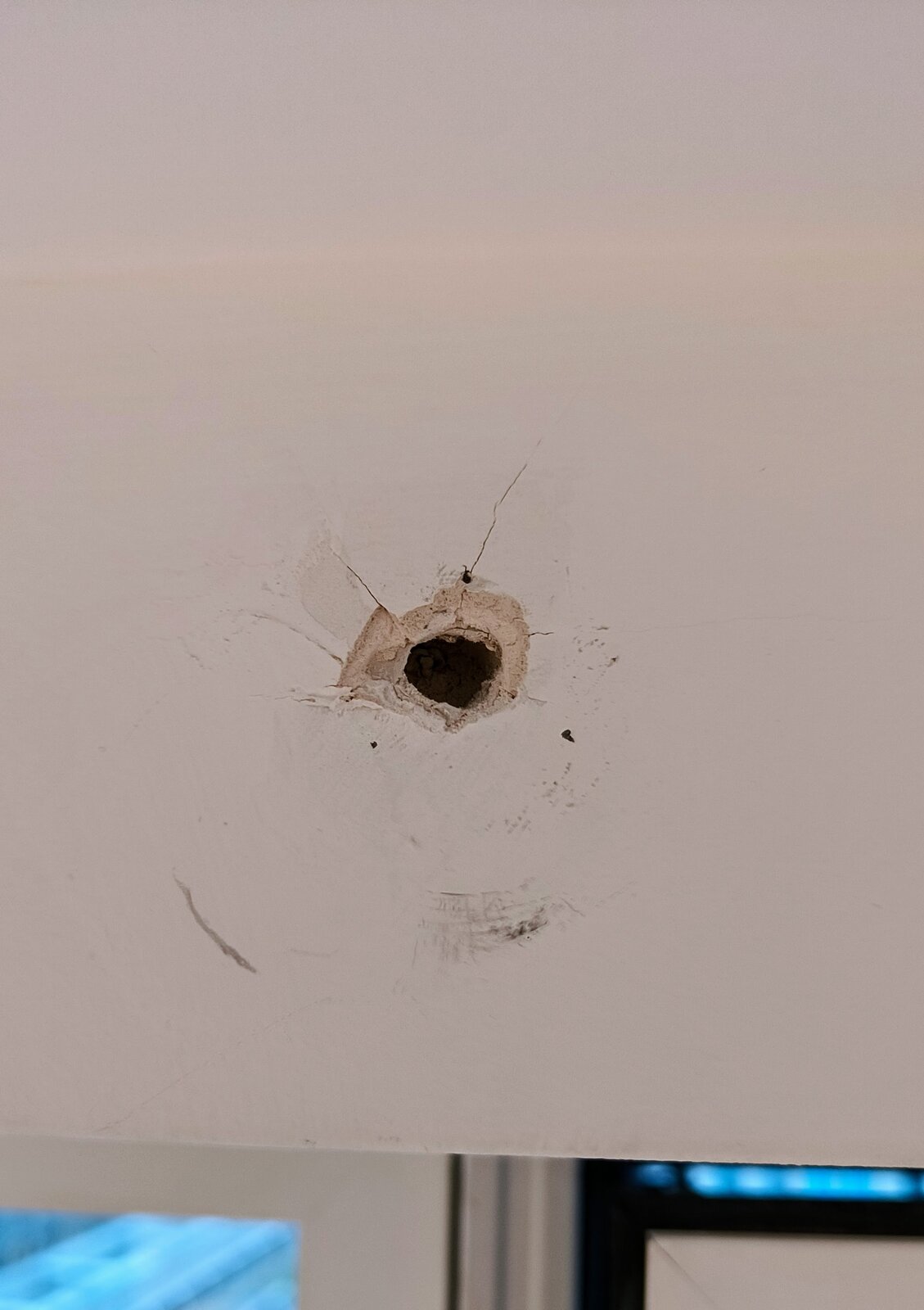

I need to put up 3 curtain brackets (Left, Right, Centre) above a floor to ceiling new build window.
Unfortunately previous owner drilled pretty big holes using Redidrive screws. The holes must have widened over time and I also want to use different brackets. The existing holes are about 8mm across. Annoyingly the flat is freshly painted but I didn't realise how loose they were until the painter put them back up, otherwise I'd have got him to fill them.

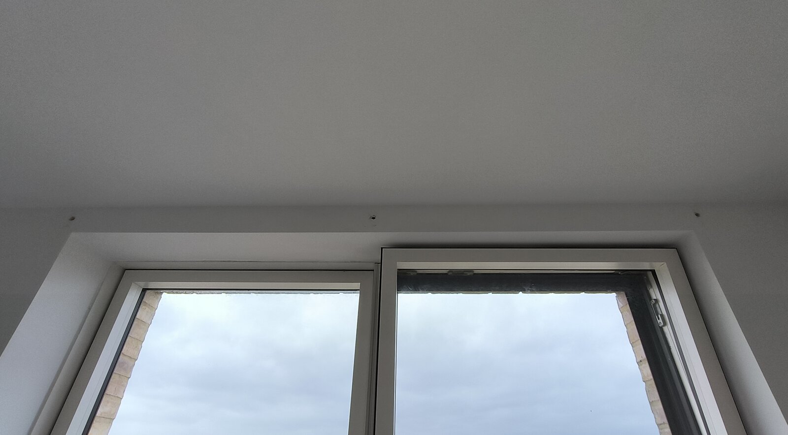

The outer ones are fine as I'm going to go wider than the original holes (so will just clean, polyfill, sand, and paint them). But I'll need to fill the central one before redrilling (see photo).

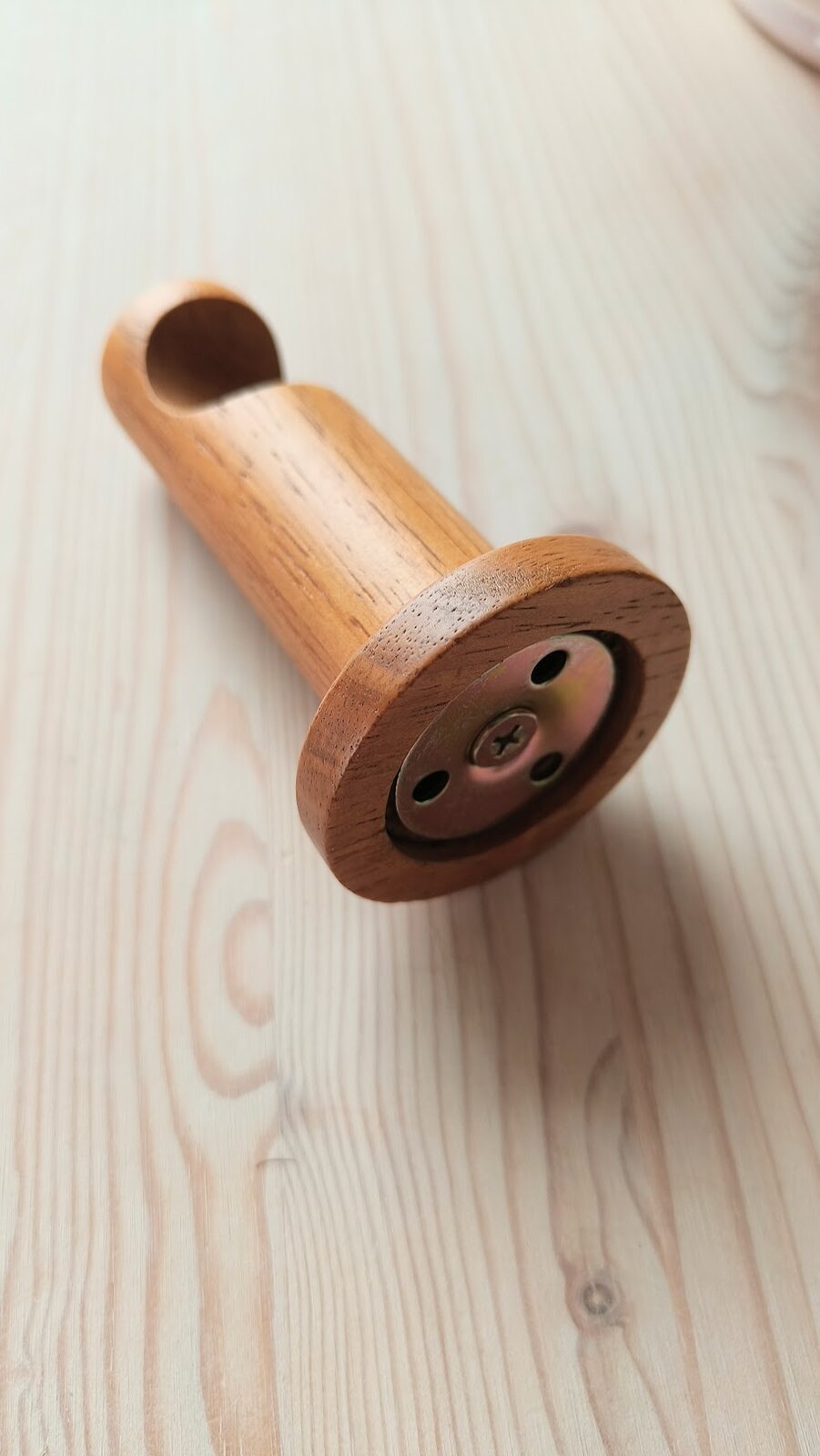

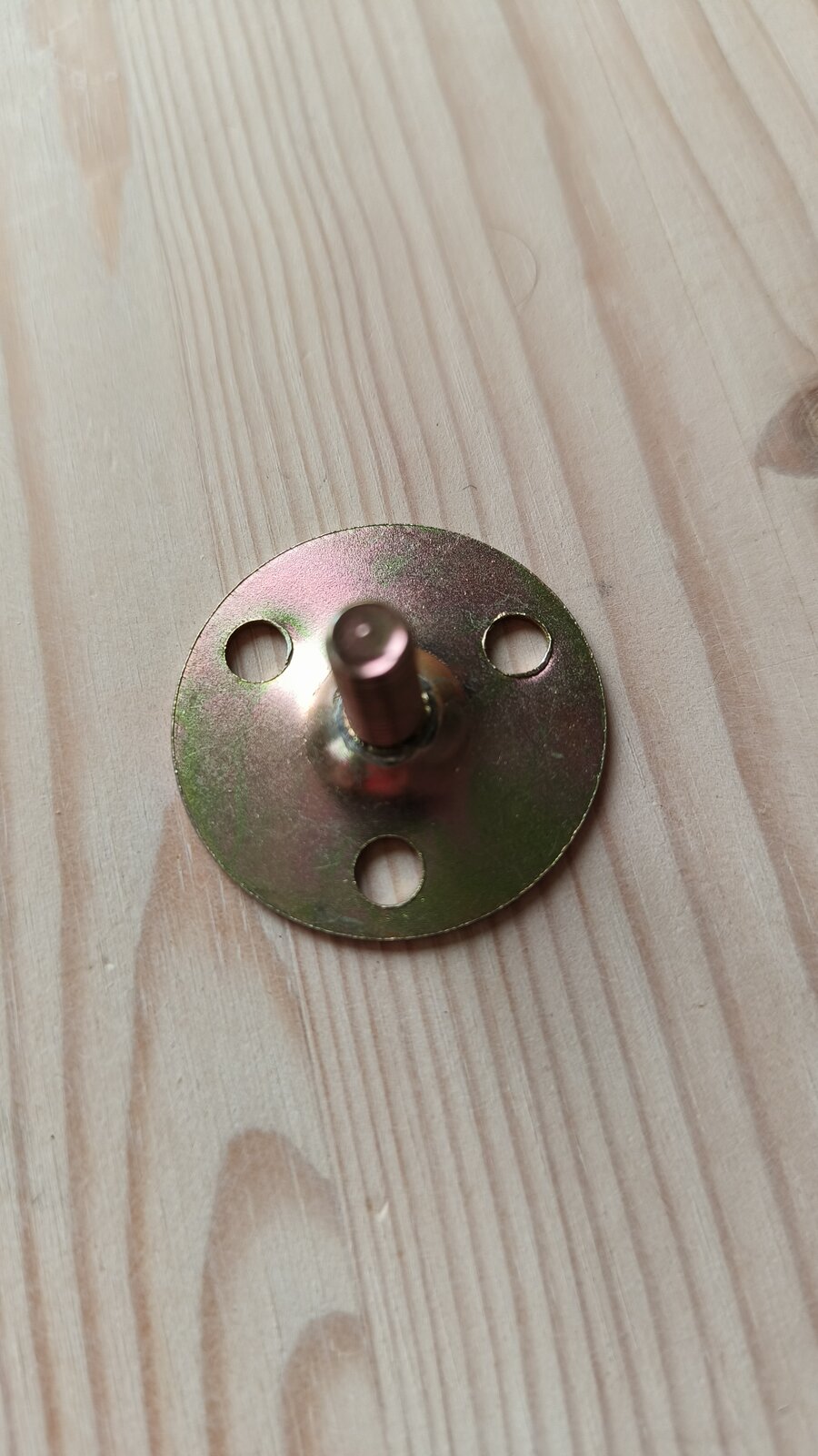

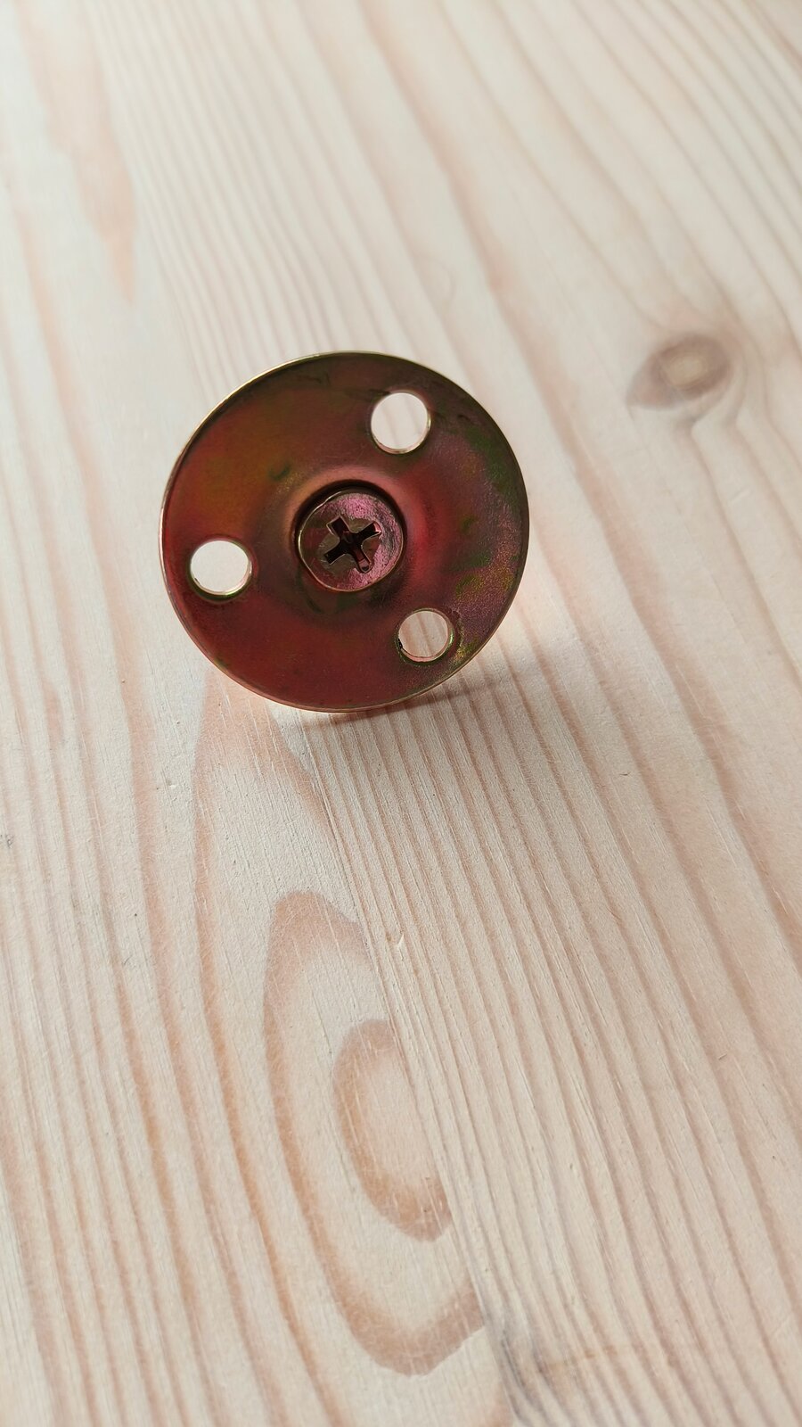

The new brackets I have (see photo) requires 3 small screws that will go around the edge of the original hole once filledn (you can see where I've marked the 3 dots).

Updates/Edits: Guessing it's plasterboard (see new images attached). Sounds like for plasterboard you need longer screws for this from a quick Google. The screws the bracket came with are about 3.5cm deep.
You can always use the old way, a length of slightly oversized dowel banged in, cut flush and then screwed into.
Yes you will be dropping/ rasing the curtain height by 1cm.. and moving the other two screws out of the hole area... or shunting the the bracket centre 1cm left or right.

@freddiemercurystwin Embarrassingly I don't know what it is above. The hole is probably about 2cm deep. Feels like it's just plaster in there. How would I know if it's a concrete lintel?
Some more photos below that might help...
@martygturner Not sure I can really shunt the positioning along as I think it will look weird being off centre? Plus there isn't really space to drop it down as that would mean the top screw would go into the middle of the original hole. Plus I need enough clearance to be able to open the tilt/door window.
Are you drilling into concrete, brick, steel or air?
It is no use trying to hang heavy curtains on plasterboard.
@JohnD please see photos just posted. I'm guessing it is plasterboard and that's why the previous brackets came loose...
At a bit of a loss as to what to do if I can't hang curtains on plasterboard.
There will be something behind the plasterboard.
If you don't know what it is, drill it and see what is on your drill tip.
Good idea. I might do it on the Left or Right holes just so I don't make the central one any bigger...
Thanks for this! Few questions:
1. Given the shape of the new fixing, will I be able to fit 3 Plasplugs / GripIt Plasterboard fixings in there?
2. What should I use to fill the central hole?
If you can drill and plug into the wall itself, a single screw would be enough.
The screw and plug need to penetrate at least 25mm into the wall, preferably 35mm. Disregard whatever is in the air or passing though the hole in the plasterboard or filler.
OK I think I understand this... To clarify:
1. You're saying I need fill the existing hole then drill a hole much deeper and buy some longer screws that go through the plasterboard layer into the wall and penetrate at least 25mm?
2. Am I ok to use the tube of Polycell Multi-purpose Polyfilla I have?
3. Also, will Plasplugs / GripIt Plasterboard plugs support screws that need to go much deeper into the wall itself?
