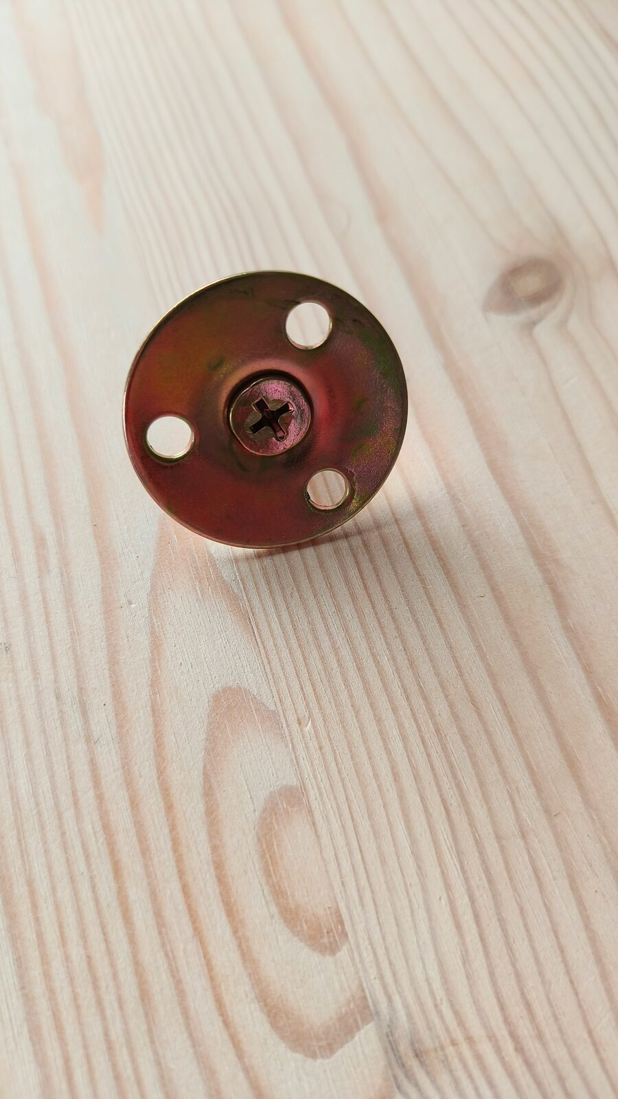

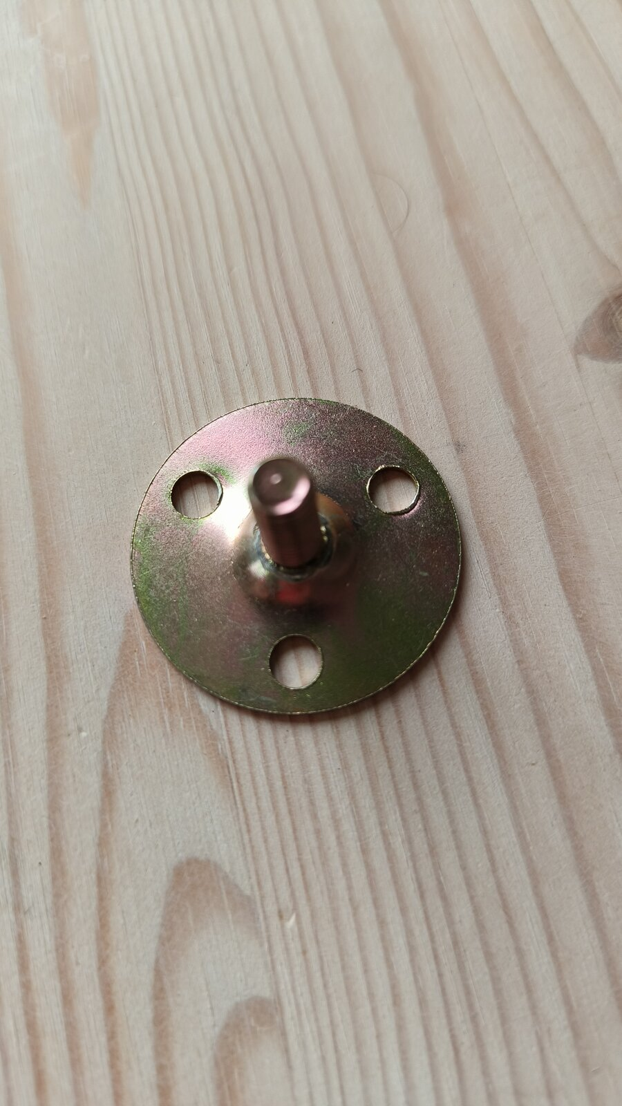

Fitting with three close holes are not ideal for plasterboard , I use just top hole to fix and a short screw into the remaining , screwed in slowly , these just prevent twisting but main fixing needs to be capable of holding the bracket alone.

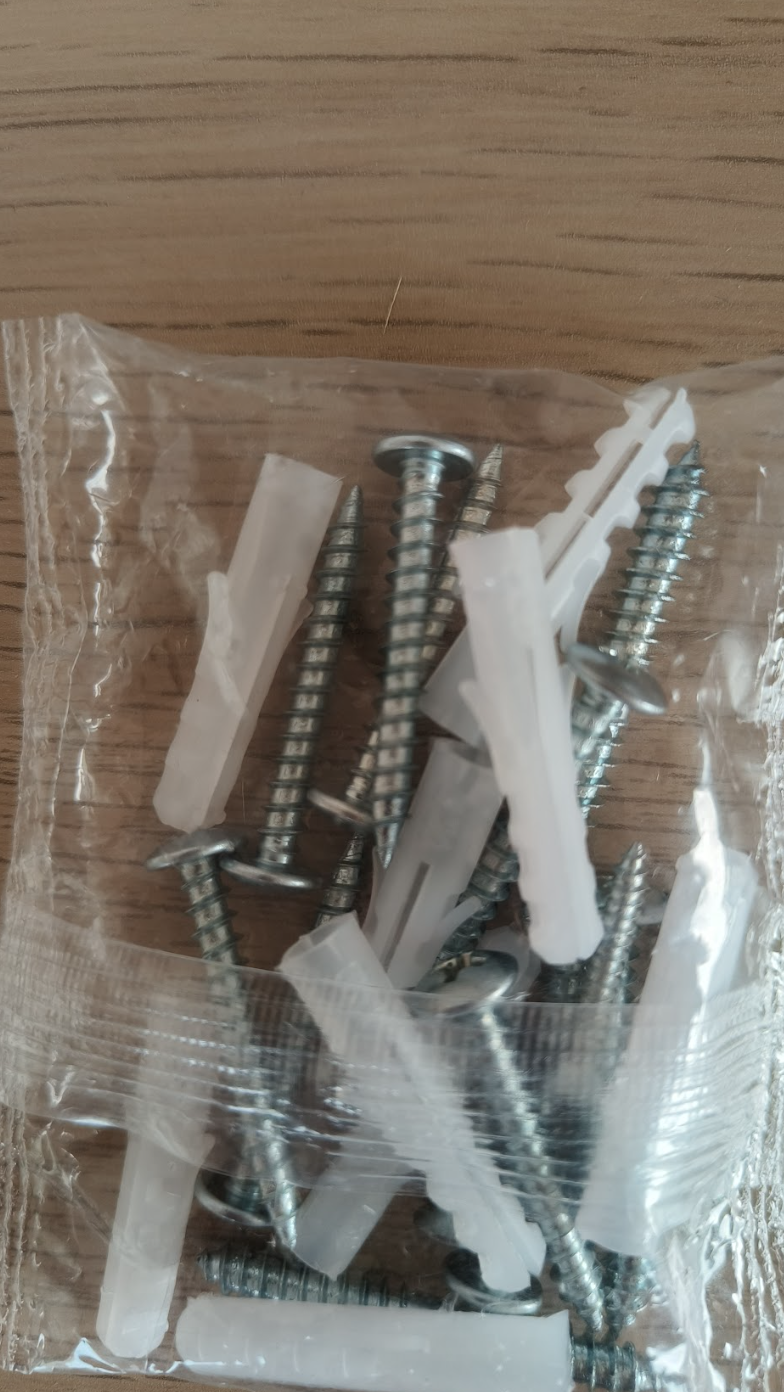

@JohnD On the screw lengths these are the plugs that came with the bracket. They're the same length as the screws.
Understand I need to get 7cm screws. But do I need longer plasplugs? Or can I use these ones and just screw into them so the last 3.5cm of the screw goes into the plasplug buried 7cm in the wall?
Yes.
But when I say the plug is buried in the wall, I mean the wall. I do not include the airgap or the plasterboard.
You can insert the plugs into the wall by putting a screw a turn or two into the plug and using the screw to push it into the drilled hole. When it is fully lodged, undo the screw.
Makes sense. I think I have the right model in mind. Just need to find some thinner 7cm screws than the others I have to fit the fitting.
Thank you so much for your help on this, @JohnD !
