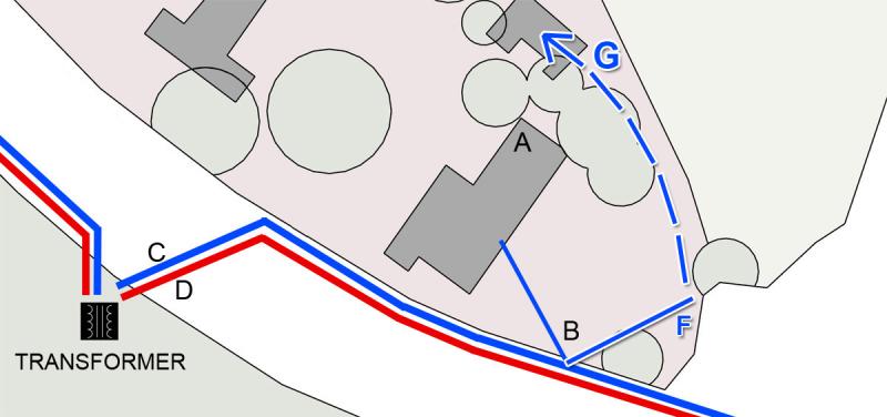

No gas on the property, so UKPN recommended at least a 100A supply.
I have tweaked the scheme a little - shown below, and I'll ask if this would change the quote for the work:
The difference now is that a new connection to a different part of the main won't be needed, but rather just re-route the existing connection to a permanent outside meter, then in the future just connect the meter to the refurbished / rebuilt bungalow...
thanks
Looks better as they should be able to joint onto the existing service cable and all excavation on private property that you can do

I thought I'd update you on this thread.
I got in touch with the Electricity company and told them that we wished to disconnect the supply. The bungalow will be demolished (and my dad is staying with us for now).
Therefore they needed to recover their equipment. There was no question of us paying for a disconnection, and they agreed to cover the cost of UKPN doing their bit with the disconnection.
That in itself covers about £800 of the quoted cost.
Then in the future we can make a new connection - which clearly we will have to pay for.
But, I am also in the process of asking UKPN if they can quote us for a "service alternation" whereby the meter is relocated to point F (from point B). This will not involve a disconnection or a new connection - so the cost may come out cheaper still.
The chap from UKPN said that their mains cable is 25mm but is not rated beyond 43m, before the voltage drops. However, from point F to the new house the distance will probably be about 50m.
He said that with a higher grade copper cable this should be fine...
