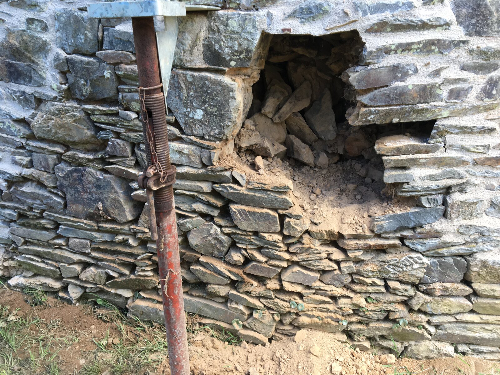

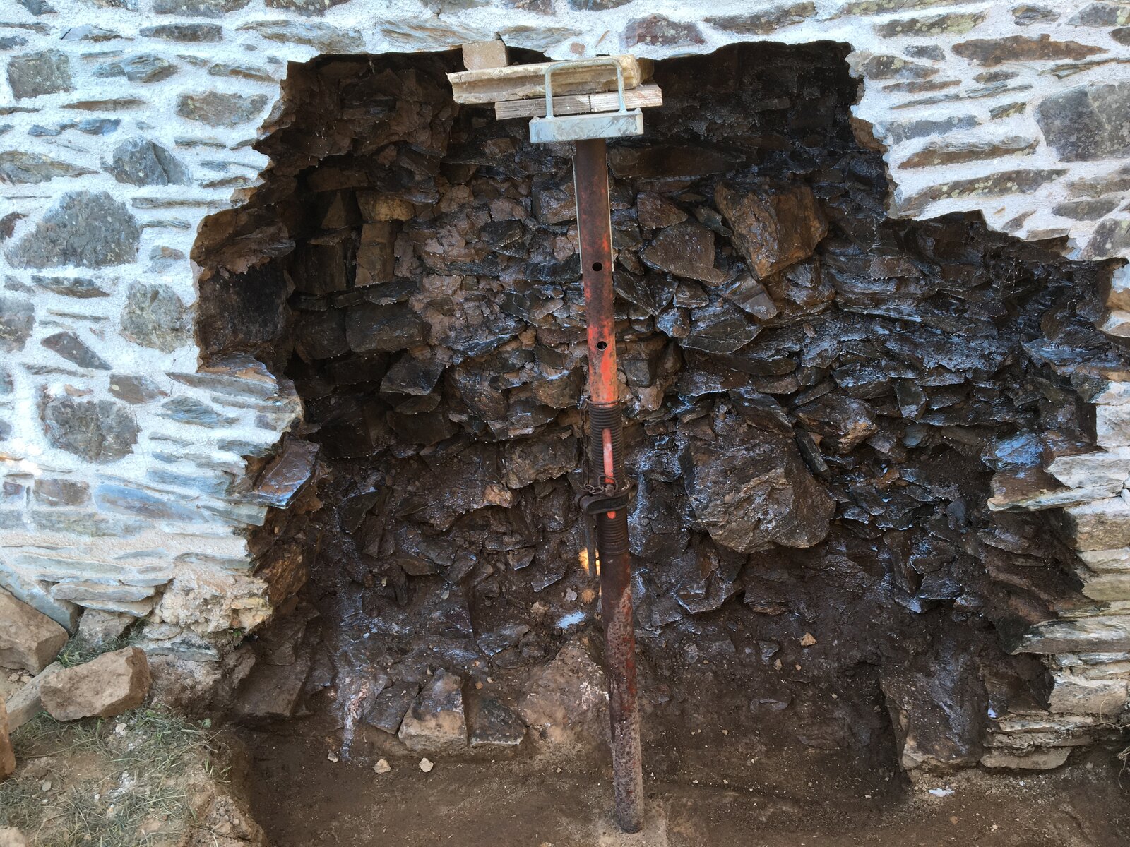

Well after trying to jack some stones back into line with little or no success. I've taken down some of the wall, and I'll rebuild it.
Some stones wouldn't budge, I can imagine the amount of weight of stone on them from above. The wall is about 3 metres high, and the bit I'm working on is the lowest 1.5 metres.
Some stones moved so easily that it moved all the cob mortar with it, leaving the stone ridiculously loose afterwards.
If I'd conrtinued I would probably have lost about 50mm in the cumulative height of those stones, and I'd have to remove them anyway to reset them properly.
I'l probably take a few photos as I'm going. It never ceases to amaze me how much stone comes out of a wall like that, and how much time it takes to take down a small section of wall carefully. I reckon I've also cleared away about a metre cube of cob mortar.
I've been at it for a day now, and I'm just at the point where I have to continually clear out the soil and cob in order to see and remove the last few 'courses', and that's just the outer skin, but a fair amount of middle rubble invariably comes down as well.

I said I'd post a few pic's on progress:

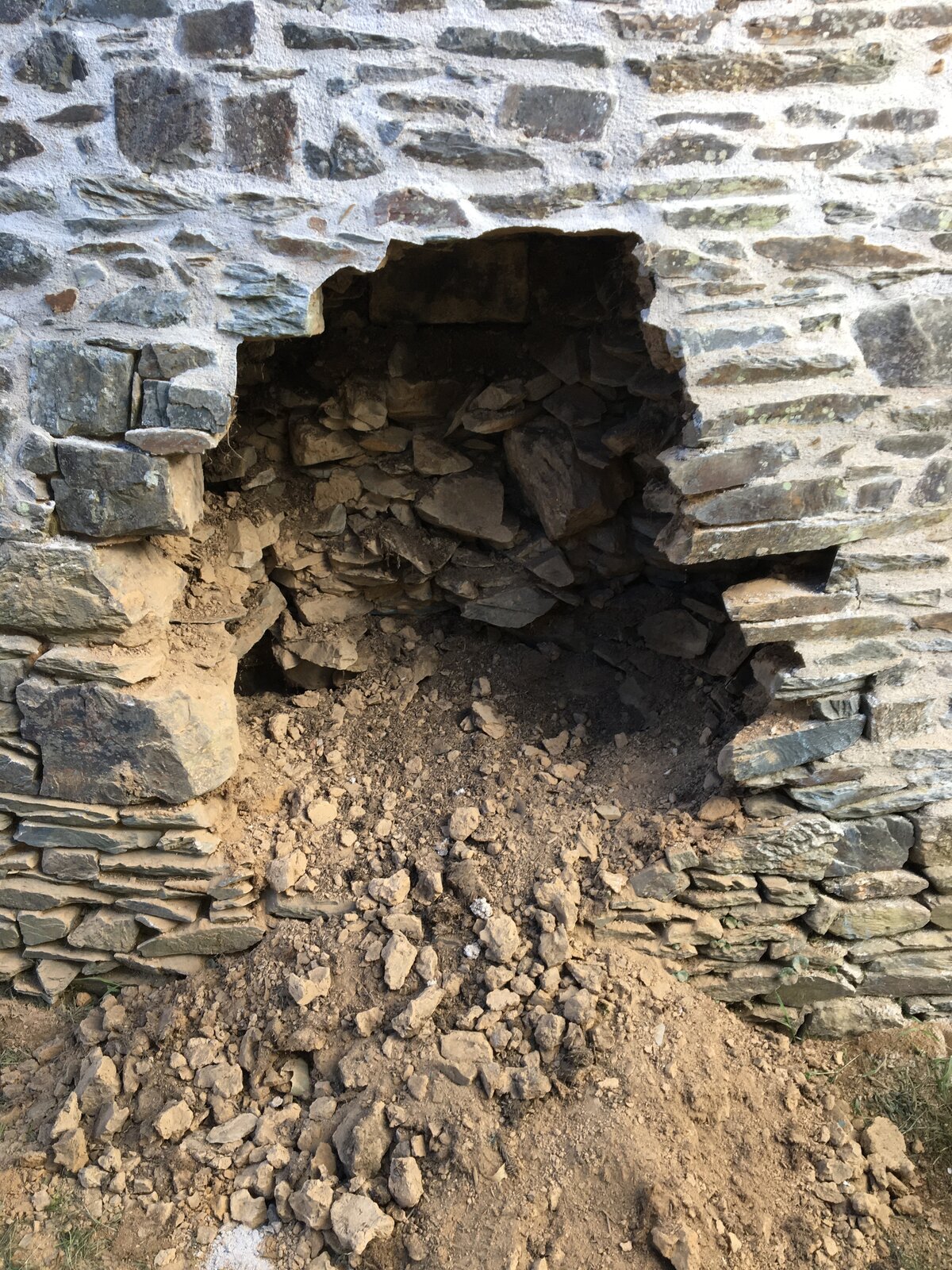

Made a start.
Load of rubbish falling down

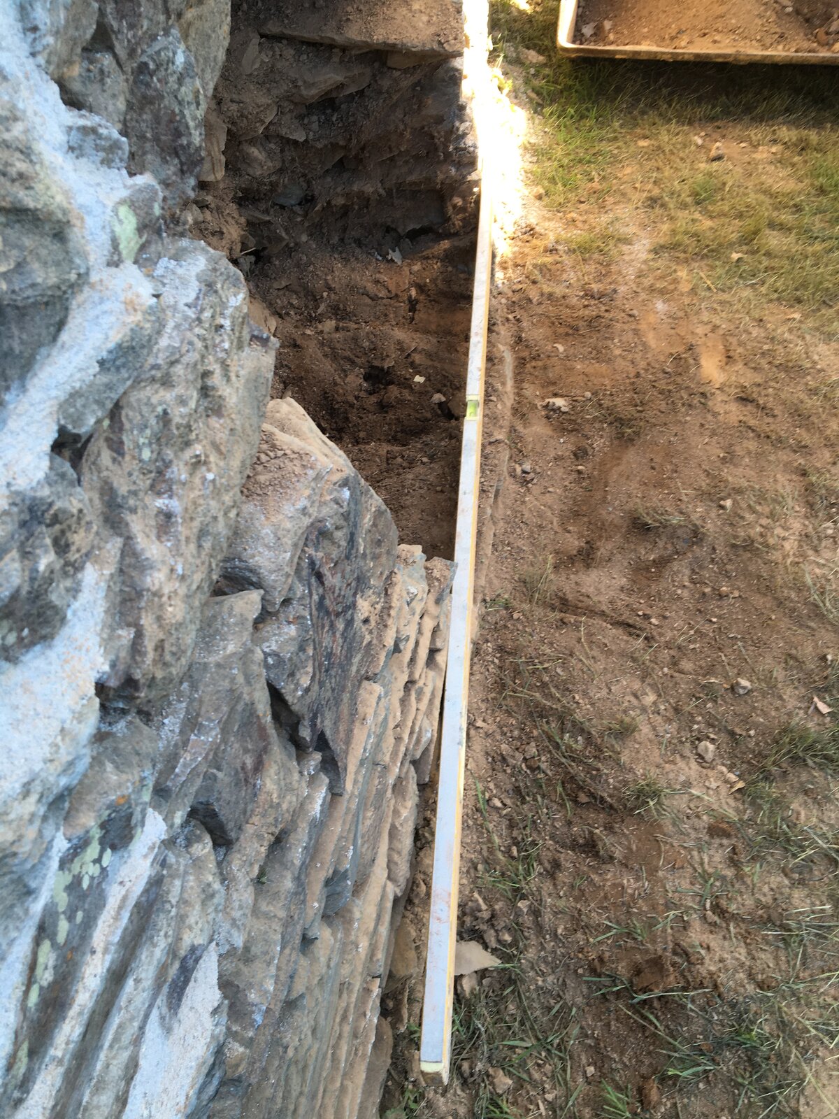

Degree of bulge obvious. Water dripping off roof was falling on the bulging wall.

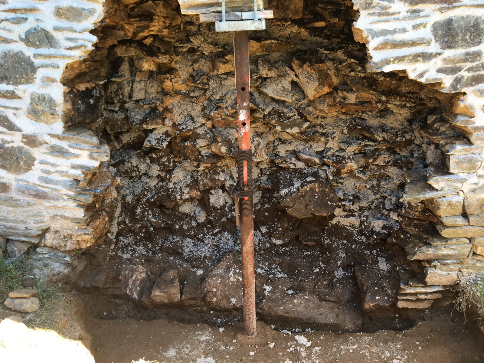

After 2 days finally ready to start rebuilding.
A couple of liberal doses of diluted PVA to stabilise the remaining a bit.

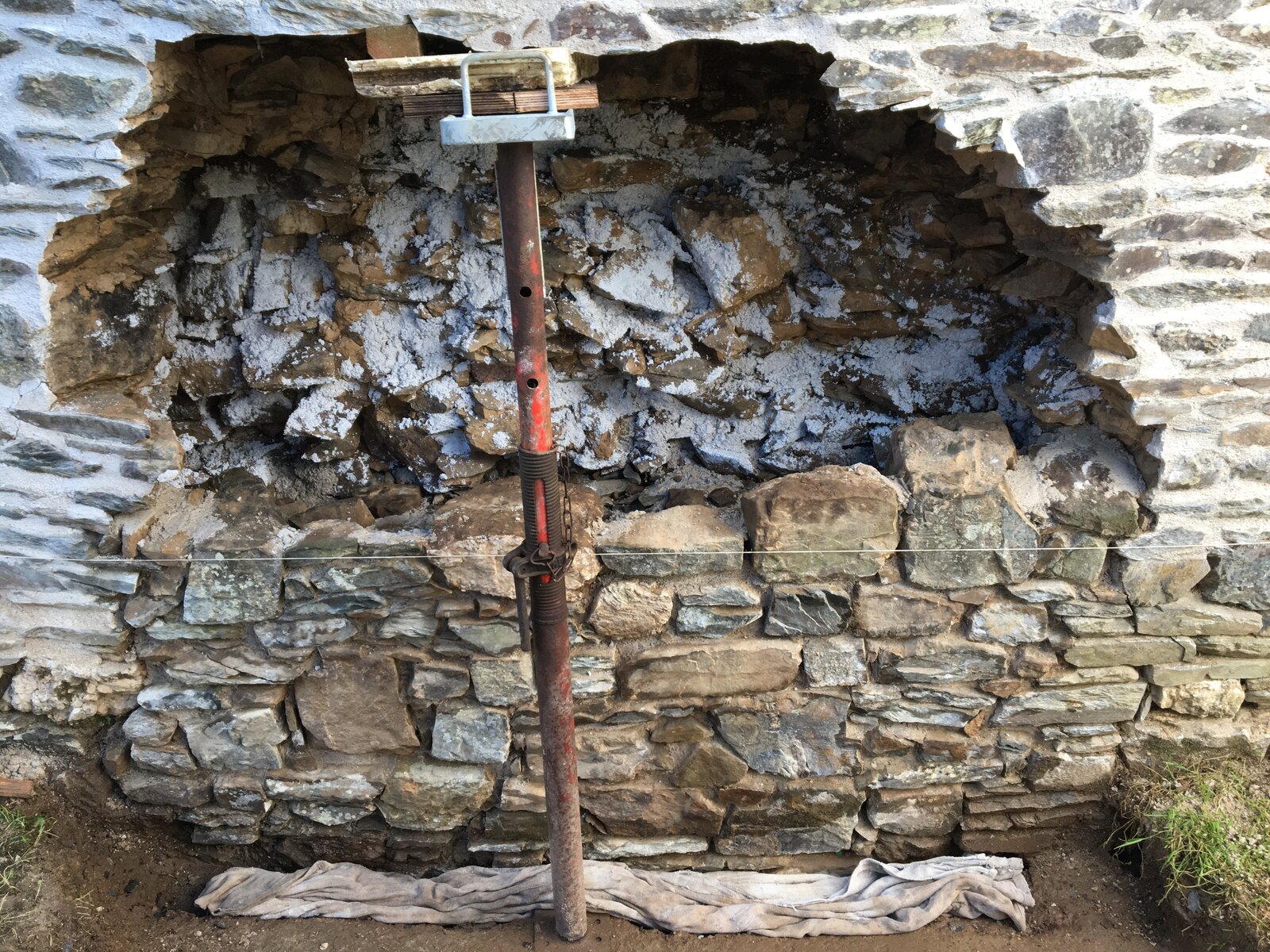

Flung some lime mortar to stabilise the remaing some more.

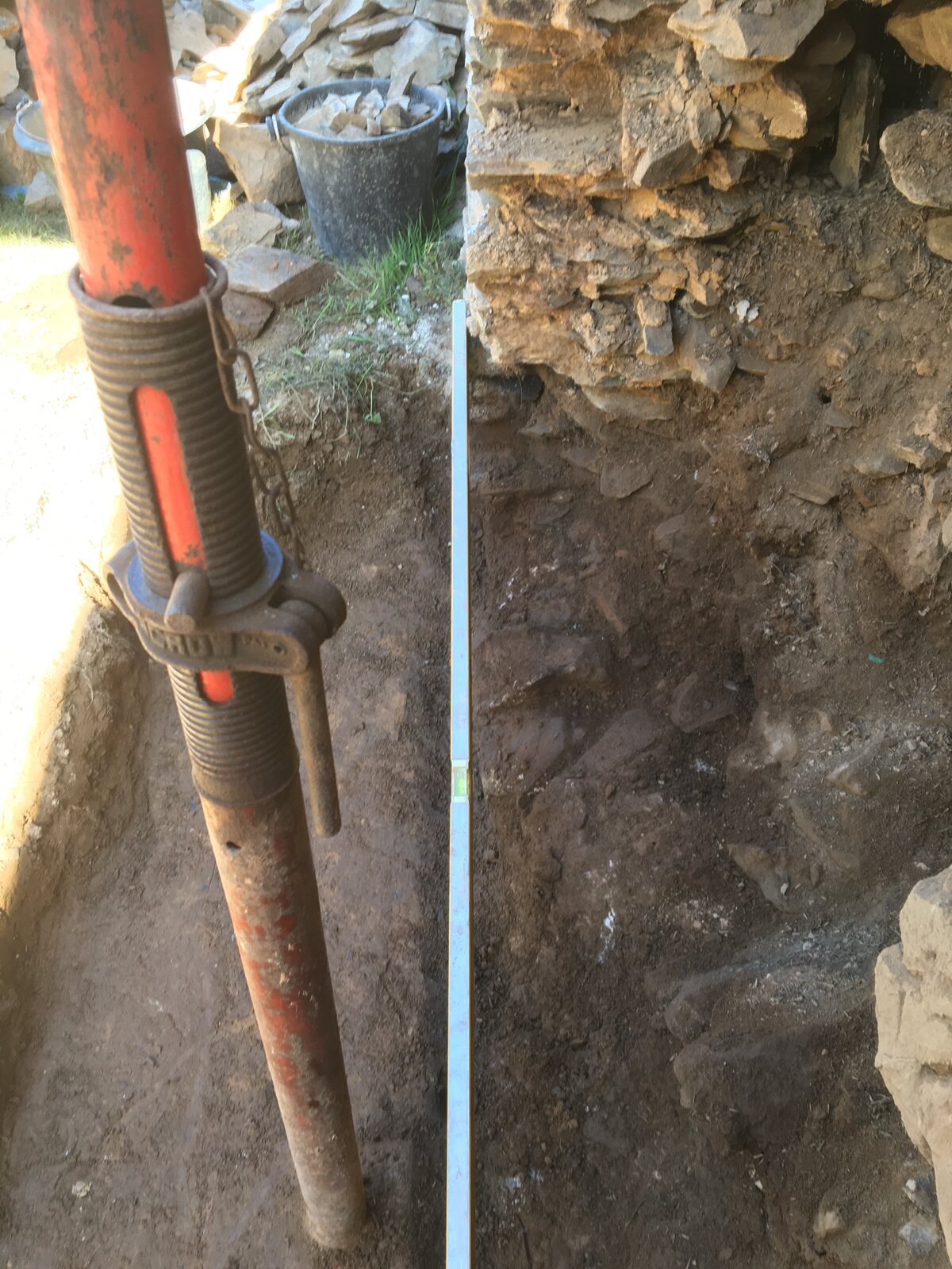

Start of 7th day. But I've had a few half days: errands, other jobs, weather. There's about ½M³ of sand and 2 bags of lime used so far.
I've intenionally scraped the mortar out of the joints to give me something to point into. But I do like that look.
