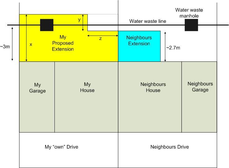

I want to do a full width, single storey rear extension.
The architect came round and said I can only have 3metres max. But I have got a man-hole at approx 3metres so the architect said the council will either;
1) Give me more than 3 metres to escape the man-hole and have a full width extension
or
2) Give me more than 3 metres but I will have to do build away from my neighbours wall, see the image below;
What can x, y and z be?
Is there a 2:1 rule? so if I have exceeded 3metres by 1metre then z must be 2metres.
What are the other options?
To build beyond 3m you will have to make an application. I have doubts that it will be approved - but you won't know for sure until you apply.

It depends if you're wanting to go down the Permitted Development route (providing your PD rights have not been removed) or you go in for a full planning application.
As already mentioned, there are limitations on what you can do under PD, e.g. extending 3m beyond the main wall of the original house.
However, is there not any scope to re-locate the manhole?
Manhole cannot be moved because the waste water pipe stretches for the entire street. This is fixed.

Rajk. I don't think I mad it quite clear on my first post but the 3 metre limit is if you want to build without Planning approval (Permitted Development). So, why not just go for Planning and be done with it?

Another architect came round last night and said that on one side I can go over 3 metres but on the adjacent side I can only go inline with their extension. See the new sketch.
I'm going to make a planning application. See how it goes. Will let you guys know........ thanks.

If the architet is talking about PD rights he is wrong. If he is talking about planning permission he is in no position to say.
It's not going to change Raj. Rules is rules. You can build 3m under PD or make an application for 4m. There's no in between and no hidden trick that will allow you to get around it. Build 3m or make an application. Full stop.
The LA might look on your application favourably because of the drain but you won't know until you apply.
