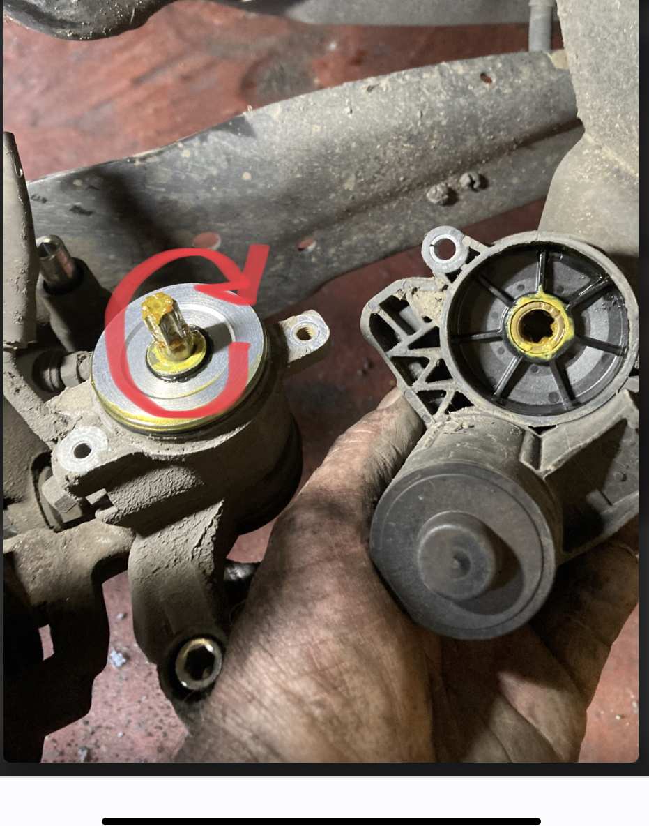

Yes. Remove the wiring plug and the two bolts that hold the electronic parking brake on from the rear of the calliper. You can then, with a socket or even your fingers, screw the handbrake spindle in clockwise, as far as it will go and then just push the piston back in the normal way. I have the tool to do it electronically but I just did it the way I described when I changed the pads and discs on our A3 because I’d lent the tool to a mate. You don’t need to reset anything, just put the handbrake on when you’re finished and it resets itself. You can do that with most epb's. You might need a M14 splined socket to remove the caliper carrier bolts if you’re changing the discs although some discs can be wiggled out if you’re lucky but I’ll warn you now, they are tight!

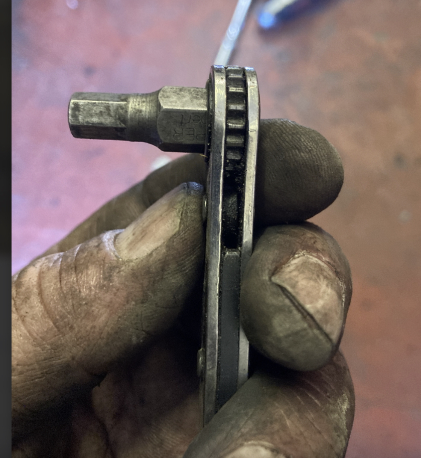

Yeah, you'd struggle with an ordinary 7mm Allen key too. I had to use a 7mm bit in a 10mm ratchet spanner. All the bolts are buggers to get to on these!

Also, some epb have an 8mm allen to rewind them.
After following mottie's procedure, before you do anything, pump the brakes with engine off, then start the car and then engage the parking brake.
I don't think it makes any difference but an Audi specialist did this when his vcds was playing up.
He said it resets it better, but again, I don't think it makes any difference.

Lidl had allen key bits in a couple of weeks ago. I bought a 7mm bit and brake adjusting tool (7mm) from halfrauds for about a tenner. You can also get an obd II reader from amazon for about £15 which together with a free app will let you wind back the epb and reset it on completion plus loads of other stuff reading and resetting fault codes etc.
