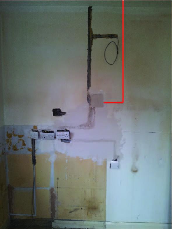

The red line is the cooker feed, which is original to the original cooker back box, this is where the crimp is inside here. Then easifilled up.
You can also see from the spur there is 2 x twin 13A and extractor (only) feed which is fused.
If this is all OK maybe I worrying unnecessarily........and should give the guy a break.

Don't look ok to me, cables not in safe zones.
Looks like a right mess. I wouldn't be happy paying for shoddy work like that.
The most annoying thing here is how little extra effort it would have taken to do things properly and leave a safe and compliant installation.

//www.diynot.com/wiki/electrics:installation_techniques:walls
Basically, all concealed cables must be horizontally or vertically in line with the accessory (eg socket, cooker switch etc).
There should be no hidden cables 'randomly' hidden in the wall.
As mentioned, joints under the floor are more desirable than buried in the wall - but this is more good practice than regulations.
The cooker cable needs redirecting so it runs vertically in the wall above the cooker switch.
The same will apply to those cables, one of which is for the extractor. Not completely sure what the other one does.
The cable from the cooker switch to the outlet is not in a true safe zone either. The best way is vertically from the bottom of the switch box, then right angle to the left side of the outlet box.
Nothing to stop you from coming out horizontally from the righthand side of the switch box, then right angle down to the top of the outlet box.
I don't like the idea of the crimped wires in the redundant socket box. It's likely that the whole area of that box will be filled with wires. So if someone wanted to drill a hole in this area, they would look behind the new socket, and see the new cable, but not know there was a 5 inch wide section of wall with live wires in it.

Thanks for the advice. There is a redundant wire which has been left in place, may be the one you are referring to. So the spur off of the ring main which comes from upstairs is OK with 2 x 13A twin sockets and the extractor running from it?
And with the extractor cable should it be at a right angle to the vertical straight across?
What about the cable burying over the otherside this should be a whole new cable joined to the ring?
Ah, that's the cable I'm referring to.
No, doesn't sound ok...
So this should all be part of the ring and not done as a spur?
