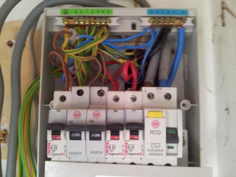

Right this is worse now. …
I think he has switched to the other type mcbs as the lighting ones are wylex…..I should have taken a picture before to be sure!!!!
On the circuit side he has put 2 x A3 radials in…….usual loading would exceed 20A on one of these for sure as typically it would power washing machine, dishwasher & kettle……and it would be common for all these to be on at once.
But he has also left the socket by the back door on another circuit….so someone working on this house may think they have isolated the kitchen circuits where as one would still be live!!! He has clearly labelled the CU with kitchen sockets…..
Please feel free to point out any other mr meaners,…..
So the two new brown and blue cables have been put in by this electrician?
Where exactly do each of these cables go?
One cable I assume goes to the fused spur and two double sockets...?
Where does the other cable go?
That new wiring, by the way, is very untidy - not the work of a proper electrician.
If they really are two radials, then the circuit breaker is too large, and poses a fire risk.
The whole thing is utter shight.......
It is only the fan that is fused. The 2 x 13A twins are unfused.
The other wire goes to 3 x wall sockets which were existing, where he also picks up the tumble drier socket.....I will have to check this again as there aren't enough cables here........
Too right its messy......
It's a worry when you realise this, but your electrician clearly doesn't!
I have a trusted electricians phone number who I will call tomorrow.....
