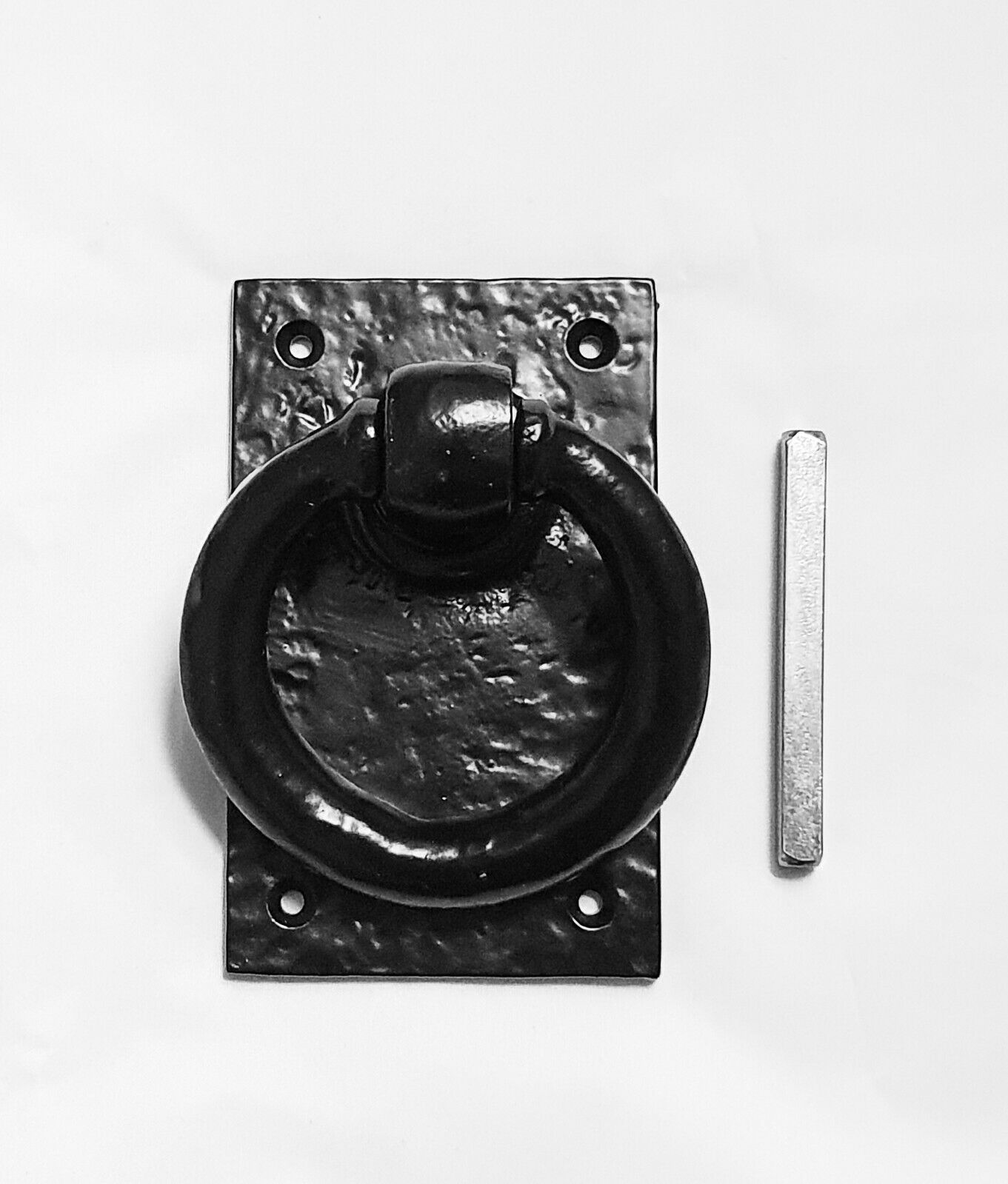

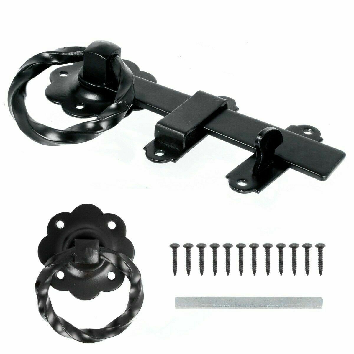

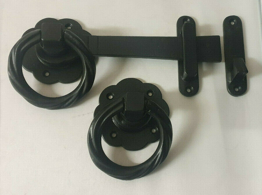

It seems to me that there is a need for a latch that can be hand operated to open the door when it is not locked, or after it has been unlocked which is the same thing, and that it must have a handle that is easy to pull, and not separate from the action of unlatching, so it can be operated one-hand.
i see no reason why it should not have a common tubular mortice latch, or a roller latch, fitted at any convenient height that does not interfere with the M&T constructions, and can be reached by hand.
And as a "handle" meeting the requirement,
some are sold as simple ring pulls with no spindle, but the ones sold with a Suffolk latch do have a spindle socket. Some of the sets include two rings, a spindle, and a latch that you could cut off and throw away.
bolt-through fixing would be advisable.
it can supplement any kind of key or combination lock that has no latching action.
