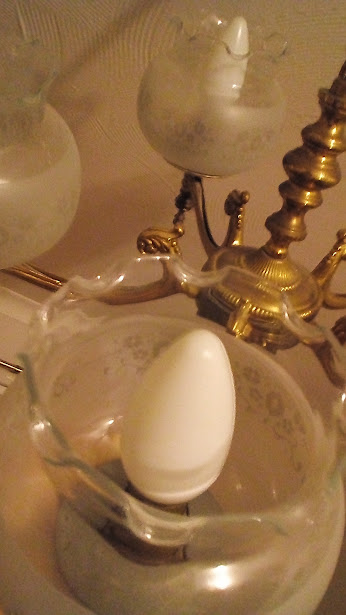

I have a 5 arm chandelier in the lounge with glass shades. originally stated as requiring golf ball bulbs. We found they got very hot due to the lack of air flow and used 25W candle shape bulbs. One died and I fitted a 3W LED, not only could the LED not cope with the heat and failed, the plastic envelope changed shape too.
As I suggested, obviously inadequate ventilation. A fitting, which works fine for tungsten and halogen, may not work so well for LED. I use a cob light, in my drive's lantern fitting, which is on between 2 and 8 hours per day, depending on the season. The first two didn't last the year out. Before fitting the 3rd replacement, 3 years ago, I modified the fitting, by adding some tiny holes in the base, to enable a small amount of ventilation. So far, it has managed to survive.
Oh yes totally.
The stated bulbswere not much smaller than the top (only) opening of the shade and not much lower meaning the ventilation gap was very restricted, I used to struggle to change a bulb as the gap wasn't sufficient to get my fingers in whereas the candle being slimmer and taller... well as they say a picture helps
