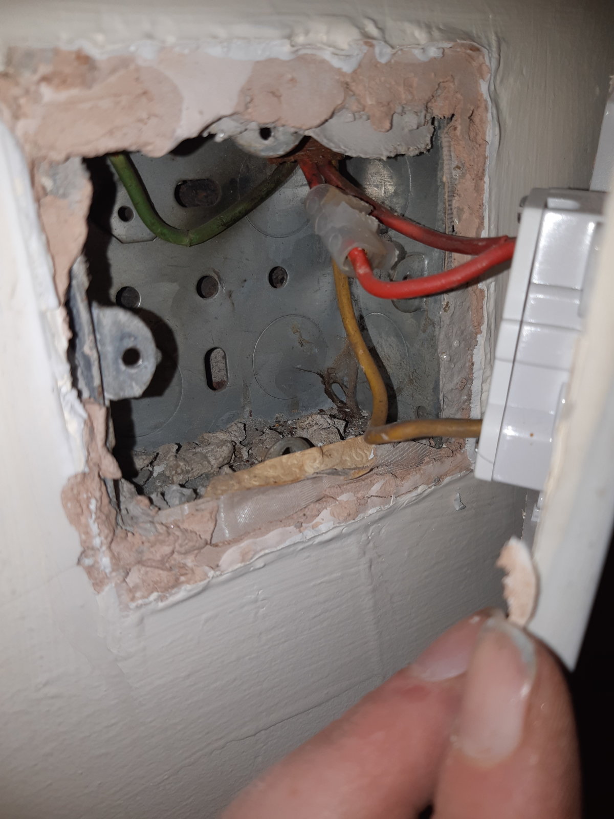

Just a quick question if anyone can answer it.
My brother has just bought a flat and we were just moving a light switch (changing the bathroom so switch would end up inside once it's moved). Anyway, the wires inside the switch (and the others plus ceiling roses) are all red, green and yellow.
I thought old wires were red, black and green/yellow or new ones brown, blue and green/yellow.
What are the yellow ones and should ge get an electrician in to have a proper look.
We've also found an extention cable wired in to the main socket circuit! I assume that's not right?!
Sorry, meant to post a picture but can't work out how to do it.
Picture!

It was common in the 60s and 70s that purpose built blocks of flats were wired with buried conduit, containing single core wires.
Red singles were used as the permanent live, and sometimes yellow would be used as the switched live.
Introducing yellow as the switched live rather than red meant it was easier to identify which wire was which.
Before the late 70s, earth was green rather than green and yellow.

From the way it is connected the yellow wire is clearly a switched live.
It looks like you have a system wired with singles in conduit. Single phase systems normally use the L1 color for the live, but sometimes installers of wiring in conduit chose to use one of the other live colors for the switched live and it looks like your installer did. Since this is a switch there is no Neutral here.

If it's protected by a FCU then it's ok (though most would not consider it best practice), but if it's just directly wired to the socket circuit then it needs sorting.
Yes, from the little information you have given us it sounds like you have an old installation that has been subject to DIY modifications over the years.

looks brown to me,
While in the absence of context I might call that color brown it looks much more like a yellow wire that has got dirty than it does like the brown typically used for wire insulation.

As mentioned above. It looks like your wiring is singles, run in steel conduit.
Moving/changing the location of the switch is going to be limited by the conduit thing. You might be able to extend the existing wires through the wall to the other side, and fit a blanking plate over the existing box.
Doing much else is going to be a real PITA.
It's definitely not brown, it's dirty yellow :D

I think those who have suggested the single wires inside conduit are correct.
After I'd made the post I went up to the attic and it looked like all the lighting circuit was inside conduit.
I will try and get some better photos tomorrow. There are certain things I am comfortable doing but my brother will definitely get a qualified electrician in.
The picture I posted earlier was the living room light switch not the bathroom (wires are same colour throughout the house).
