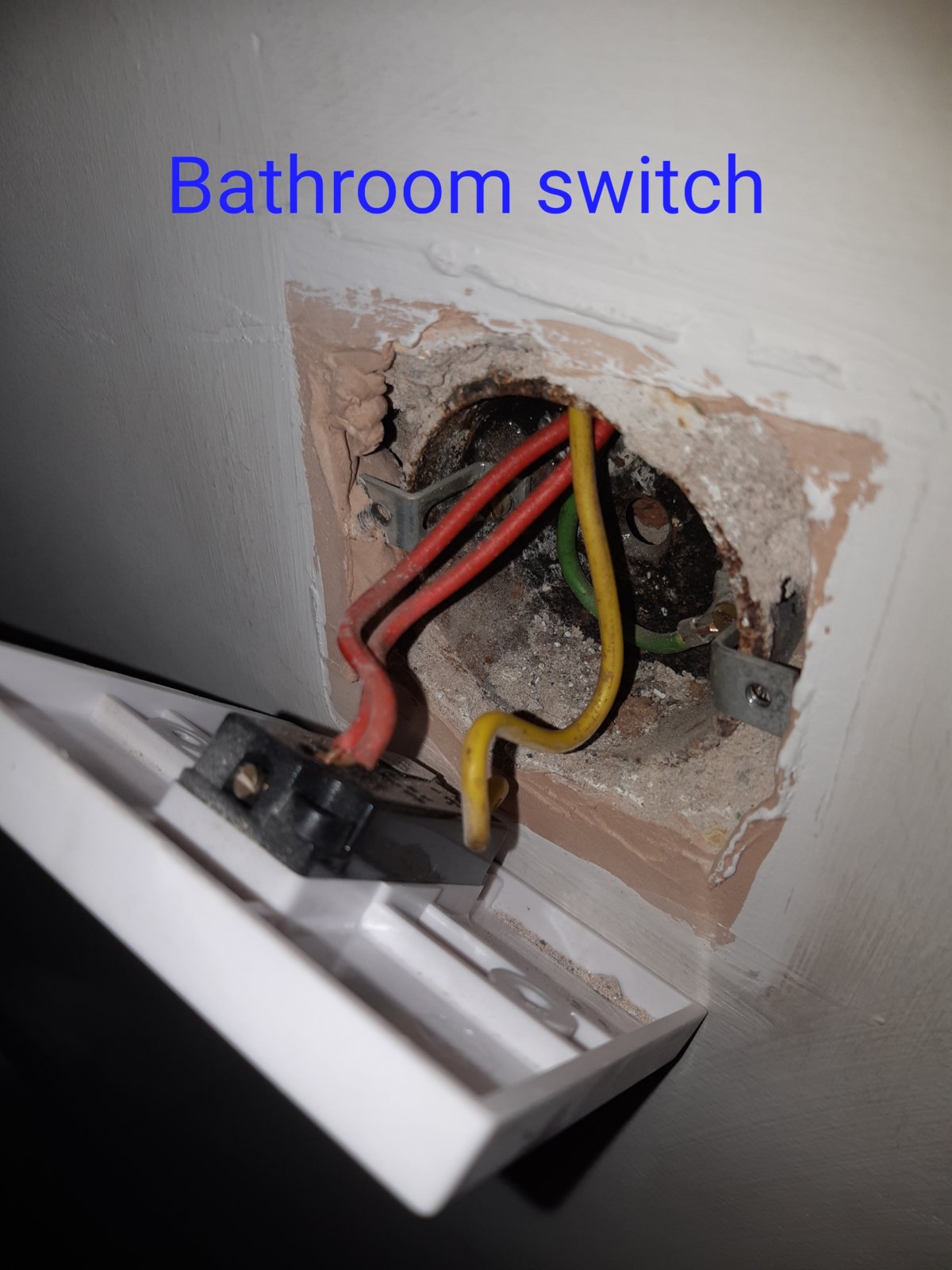

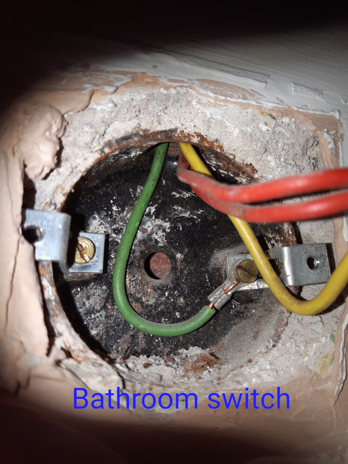

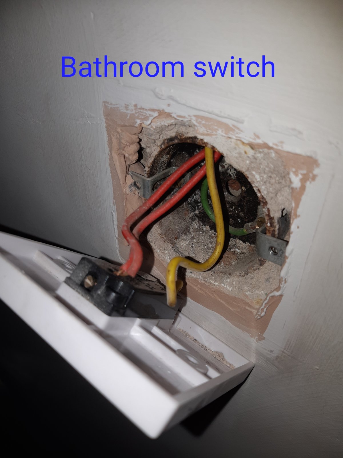

Red, green and yellow cable?
Ahh, Fixit just reread my post and realised that I wasn't clear. The current switch would end up inside once the bathroom wall was moved not the switch. Sorry, my fault for the confusion.
We want to move the switch so that it is OUTSIDE of the bathroom. There is no fan, just a light.

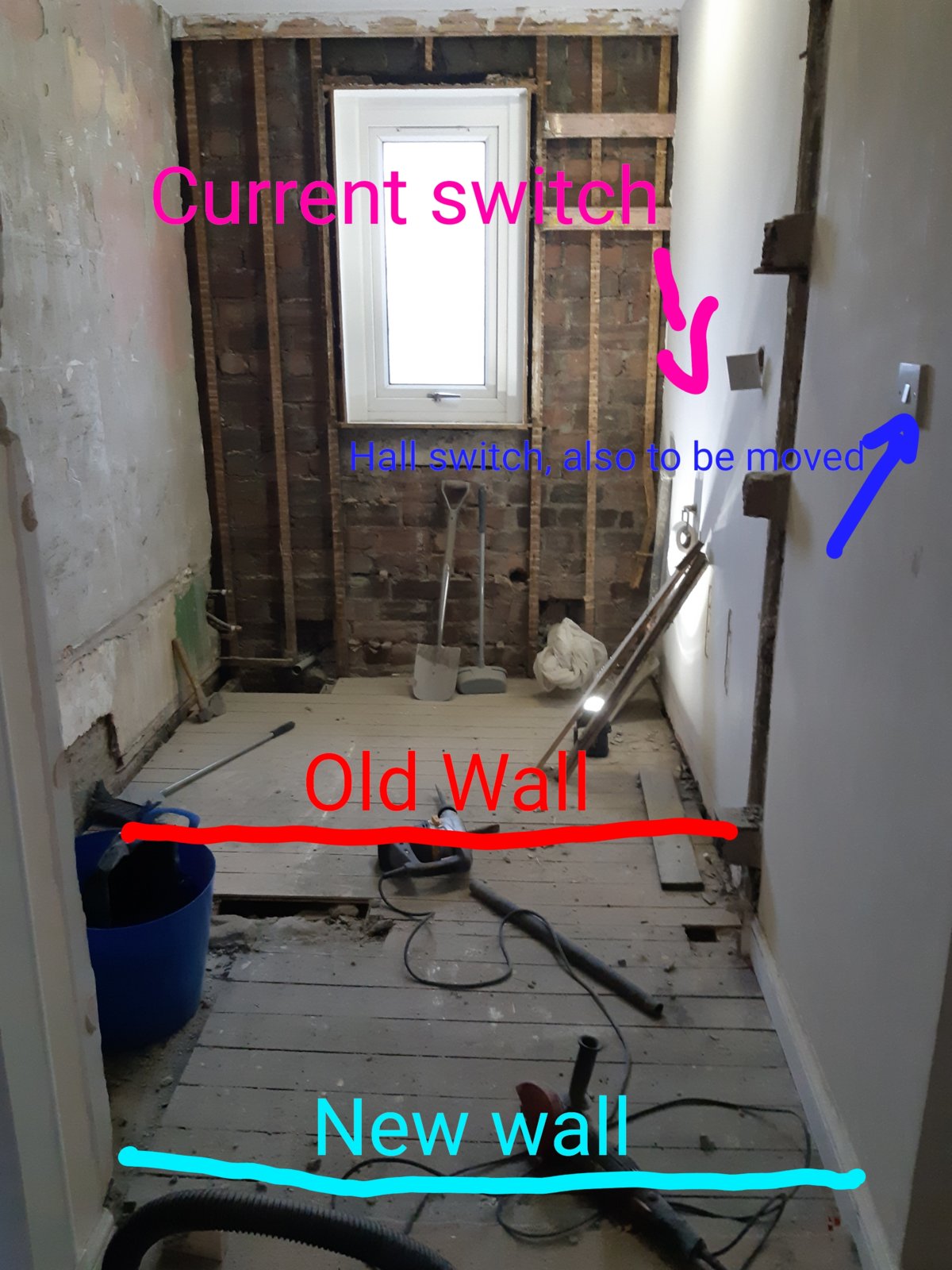

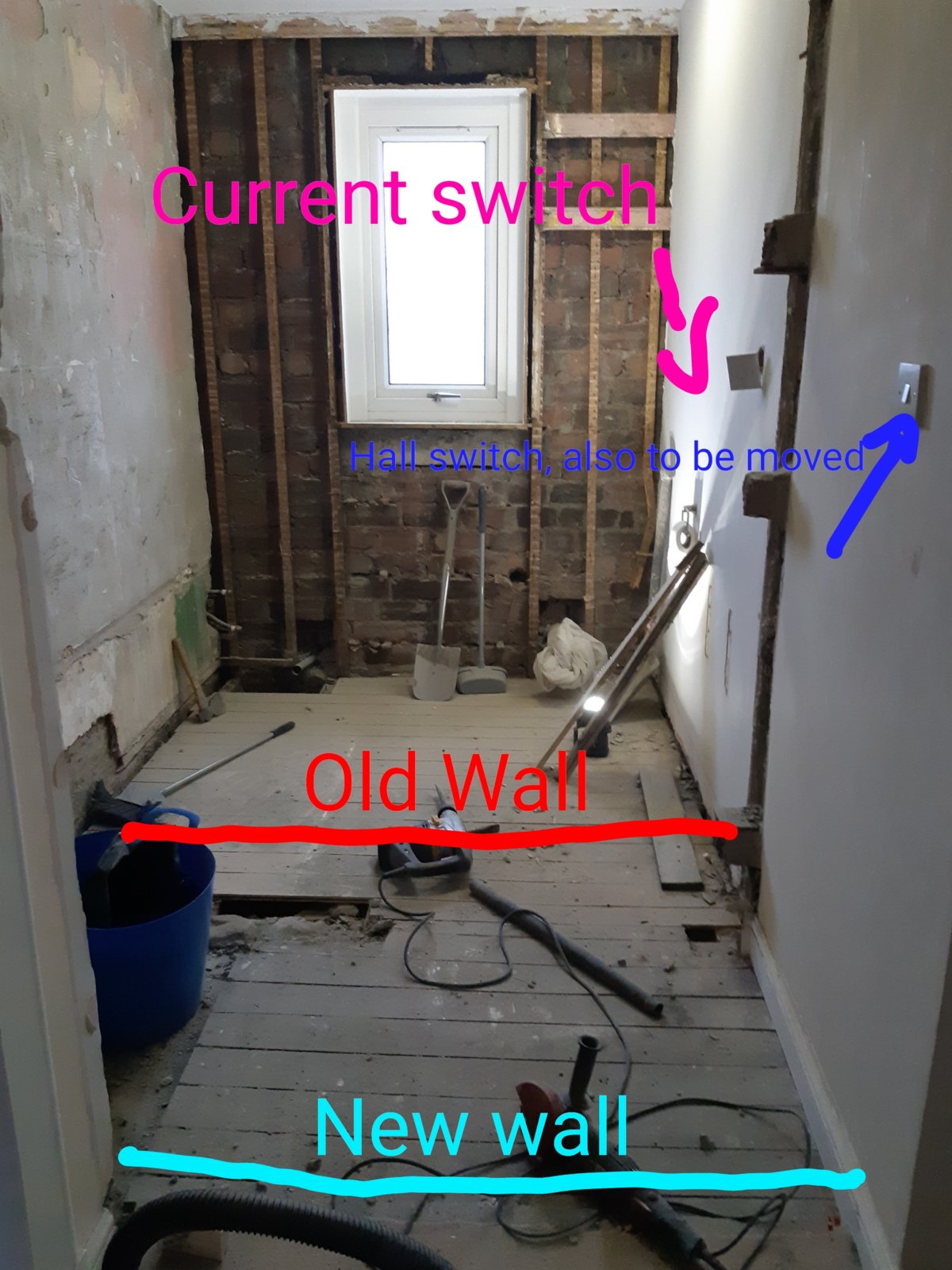

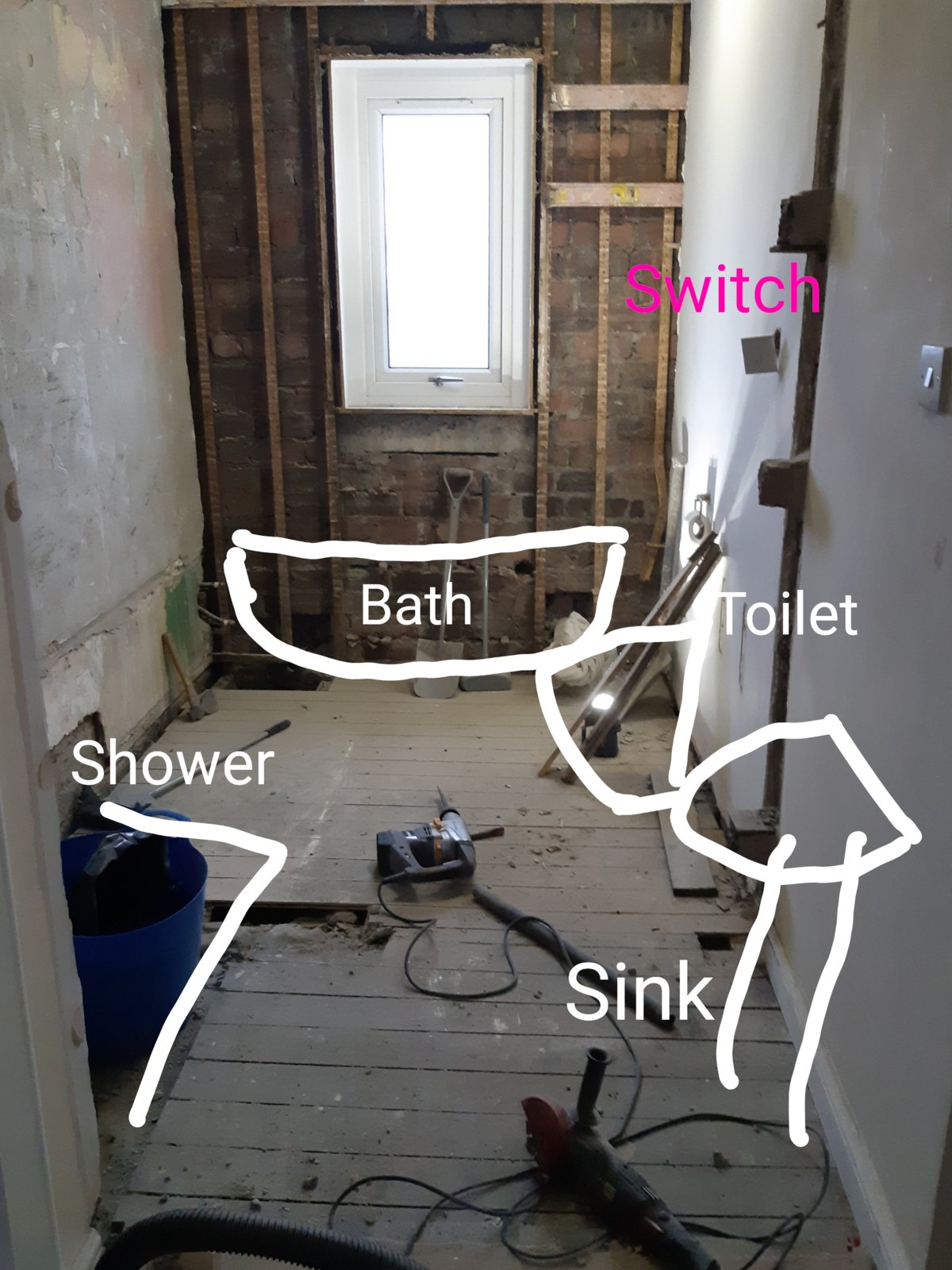

Hi Ban, because once the bathroom wall is moved the switch would be 1m 40 inside the bathroom.

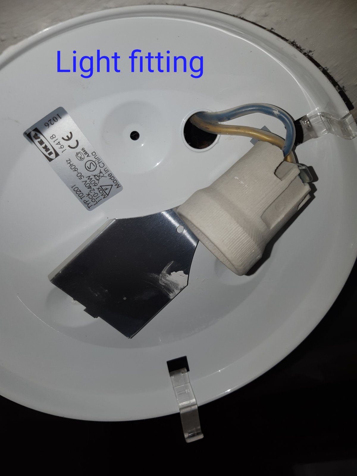

I've tried to add some pictures to show the bathroom and where things are

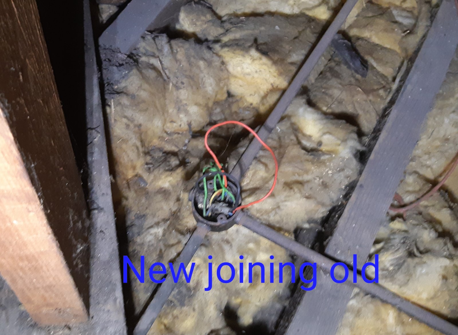

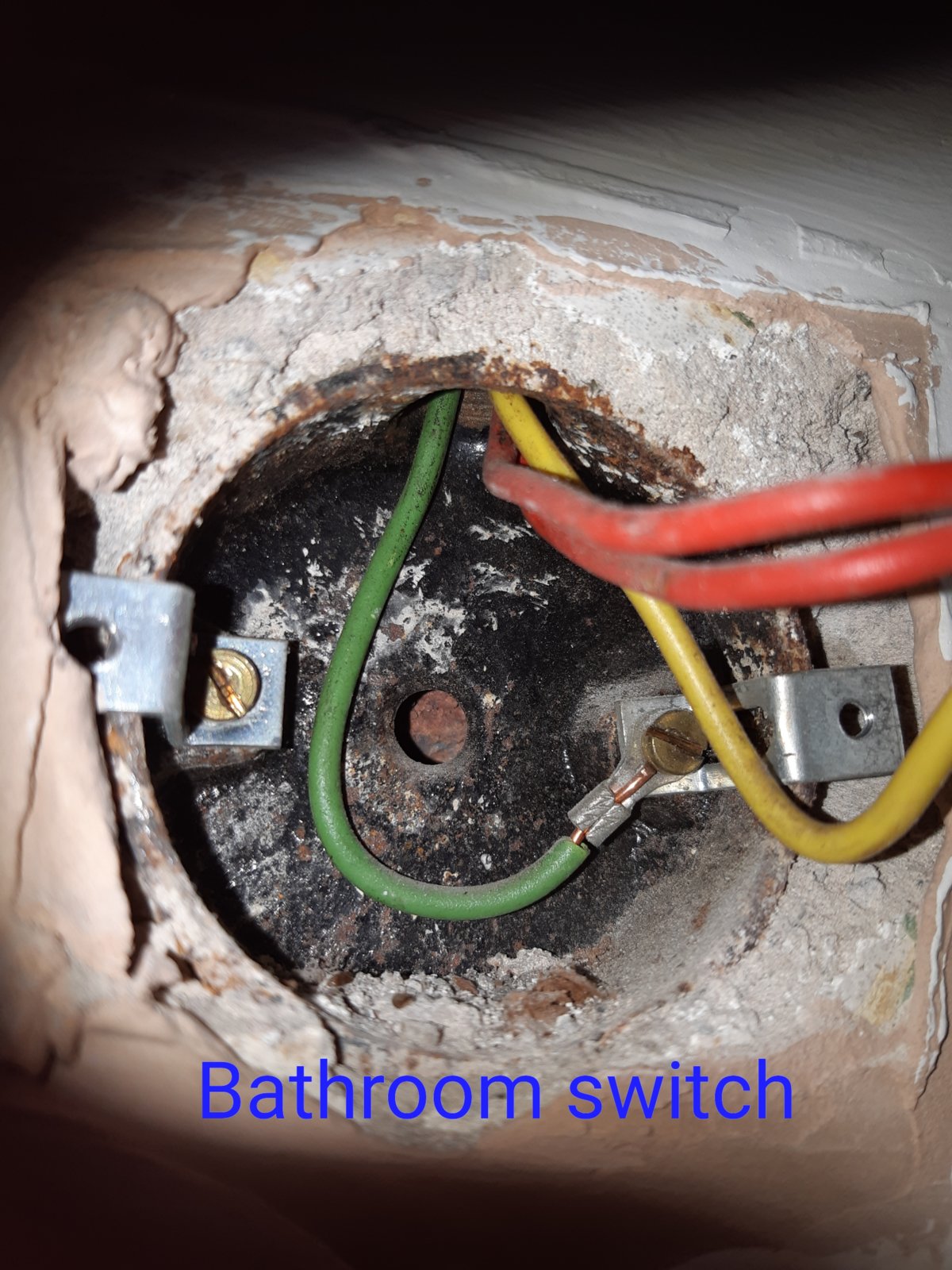

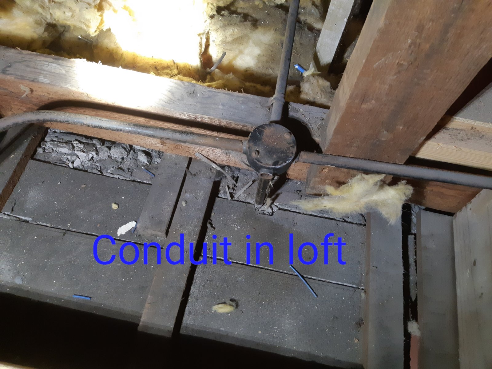

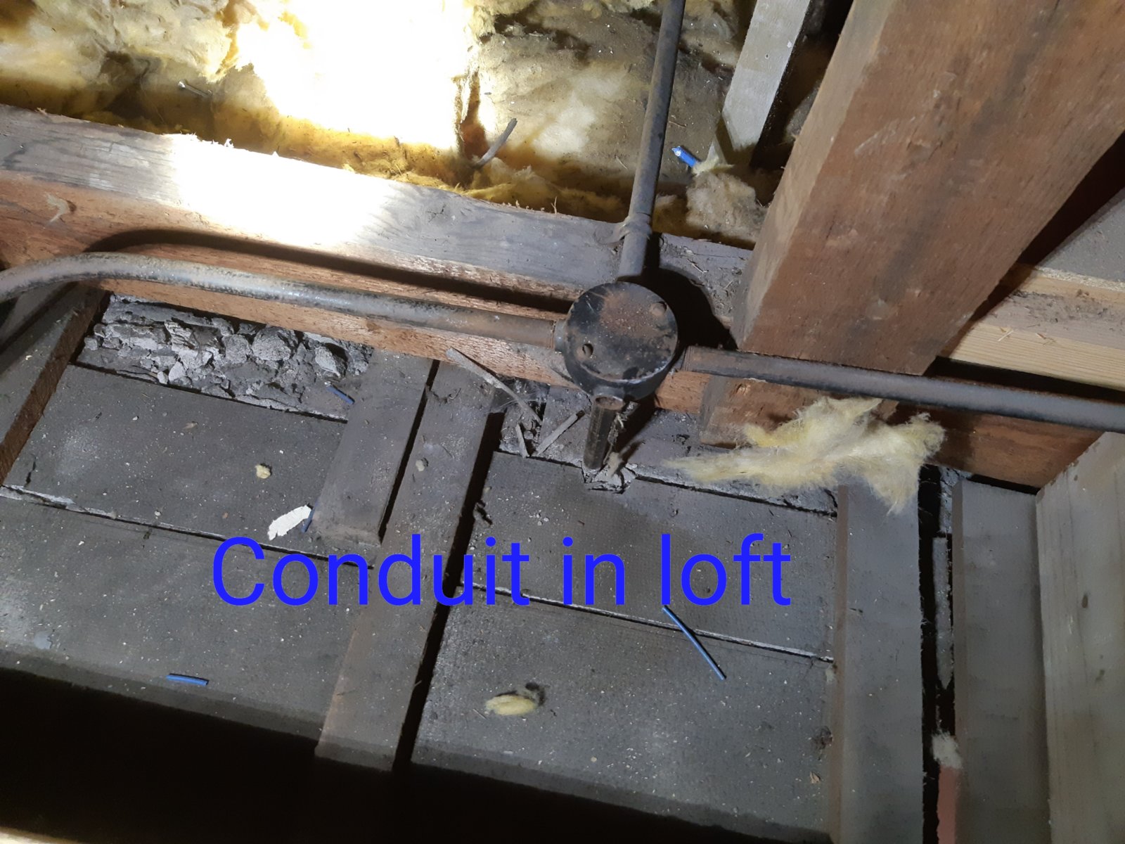

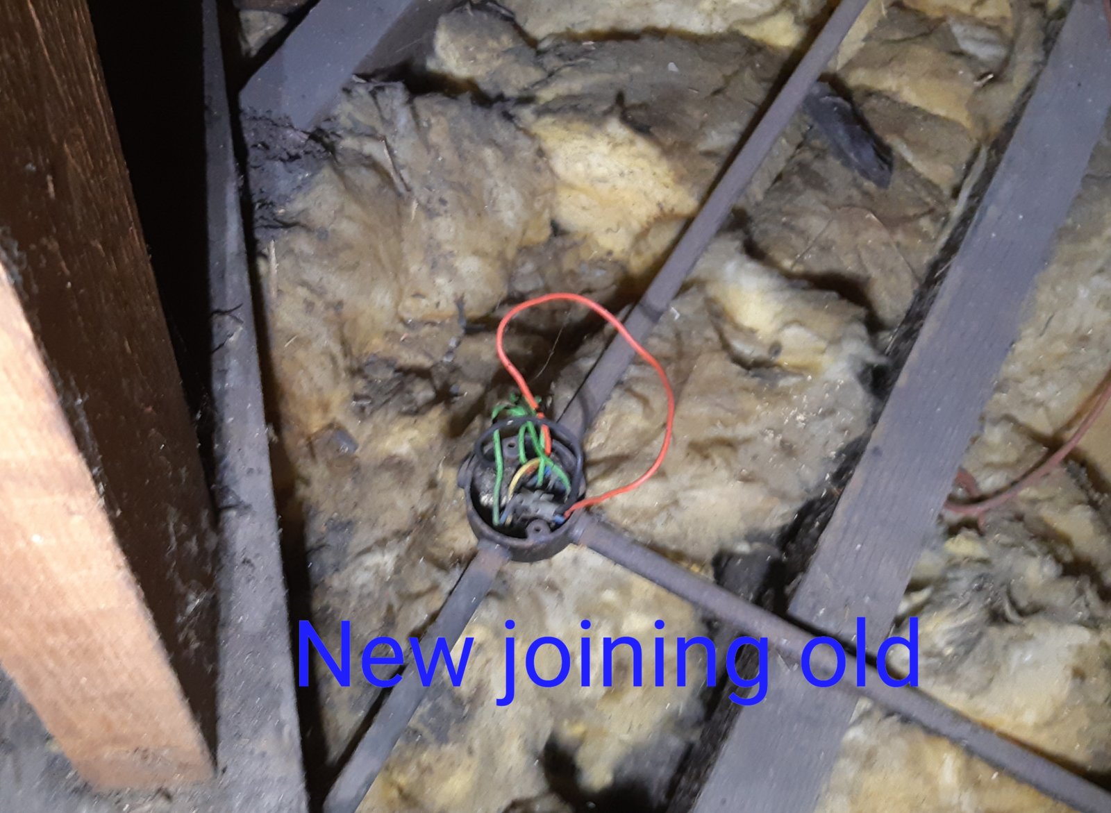

Also a picture of the wiring, hopefully the yellow is more clear and some pictures of the conduit in the loft.
You can see where newer (black and red) wiring has been added. Some of the joints were uncovered (as you can see in pictures) is this safe?
Thanks for all your time! I only wanted to know about the yellow wires as I'd never seen them before and Google didn't give me any answers that made sense :D

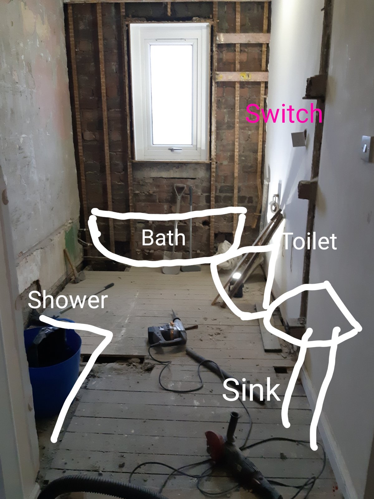

Hi John, as above, because once the bathroom wall is moved the switch would be 1m 40 inside the bathroom.
Tried to draw bathroom plan, once wall has moved and new bathroom is fitted the switch would be between the sink and toilet which would be an extremely odd place to leave the switch.
Obviously the switch could remain in the bathroom and be changed to a pull chord. It would still need to be moved though. As leaving it in the current position would be daft (surely).
Unless of course anyone else has a switch situated between the toilet and sink, 1m 40 into the room? :LOL:
A point that seems to have been missed by some of the more aggressive responders to this topic!
As you have access to the ceiling area. All you need to do is to join the conductors to a length of cable to extend them to the new location.
The place to put the joint would be inside the existing conduit, where the conduit goes vertical down to the existing switch.
You can unsrew the conduit from the bottom of the box, put some choc blocks or Wago connectors inside and its job done.
Not obviously. A pull cord is not necessary so you can have the switch in the bathroom. As above, you can have a standard wall switch inside a bathroom, providing it's not inside "zones".
Yes, of course Taylor. I think that the layout of the bathroom would mean that any sensible place within it would potentially be too close to the sink but I'd need to measure to ckeck.
I think that potentially a pull cord would be easier to change as (presumably) I could disconnect the current switch. Pull the cables back up into the loft and reconnect to the pull cord easily from above.

Well, sort of. But the cables in the conduit are singles, and they must be run in conduit, you cannot just leave them draped round the loft area without an additional covering (eg conduit) to protect them.
That is Why I suggested a length of 2C&E or 3C&E PVC sheathed cable to run from a junction in the existing conduit box to the light switch location. If that was used, then you do not need conduit.
