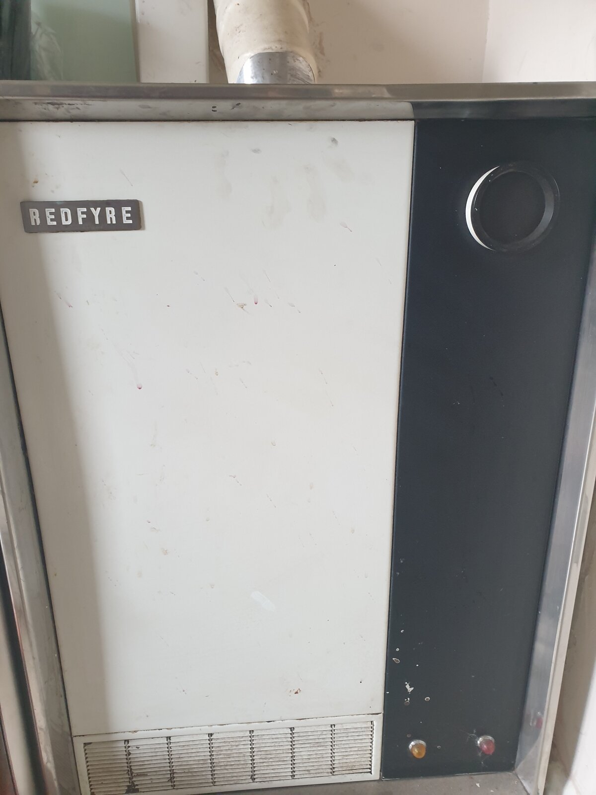

my daughter has moved into my late fathers house. It has a redfyre centramatic vapourising pot boiler with a circular pot - circa 1966.

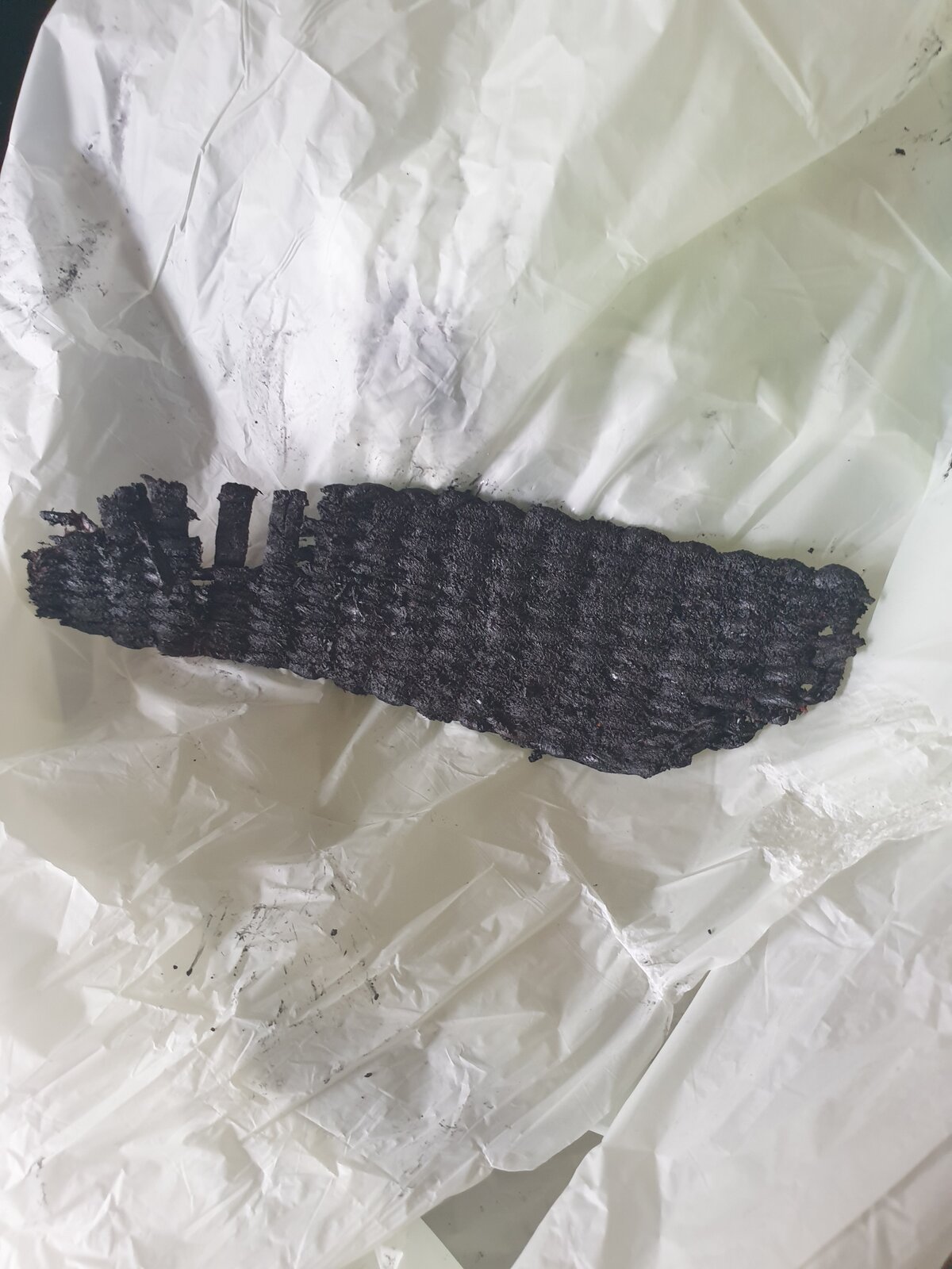

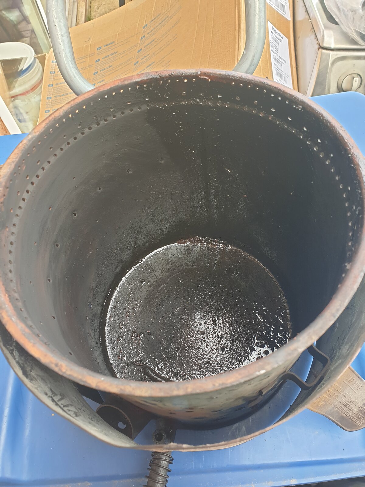

I've cleaned everything and the pot was pretty gunged up. When I cleaned it out, in the bottom was a wick. So I'm wondering what the wick does and if this might be the problem.
There is a self tapping screw on the side to which is fixed a small piece of metal which I assume the wick attached to.

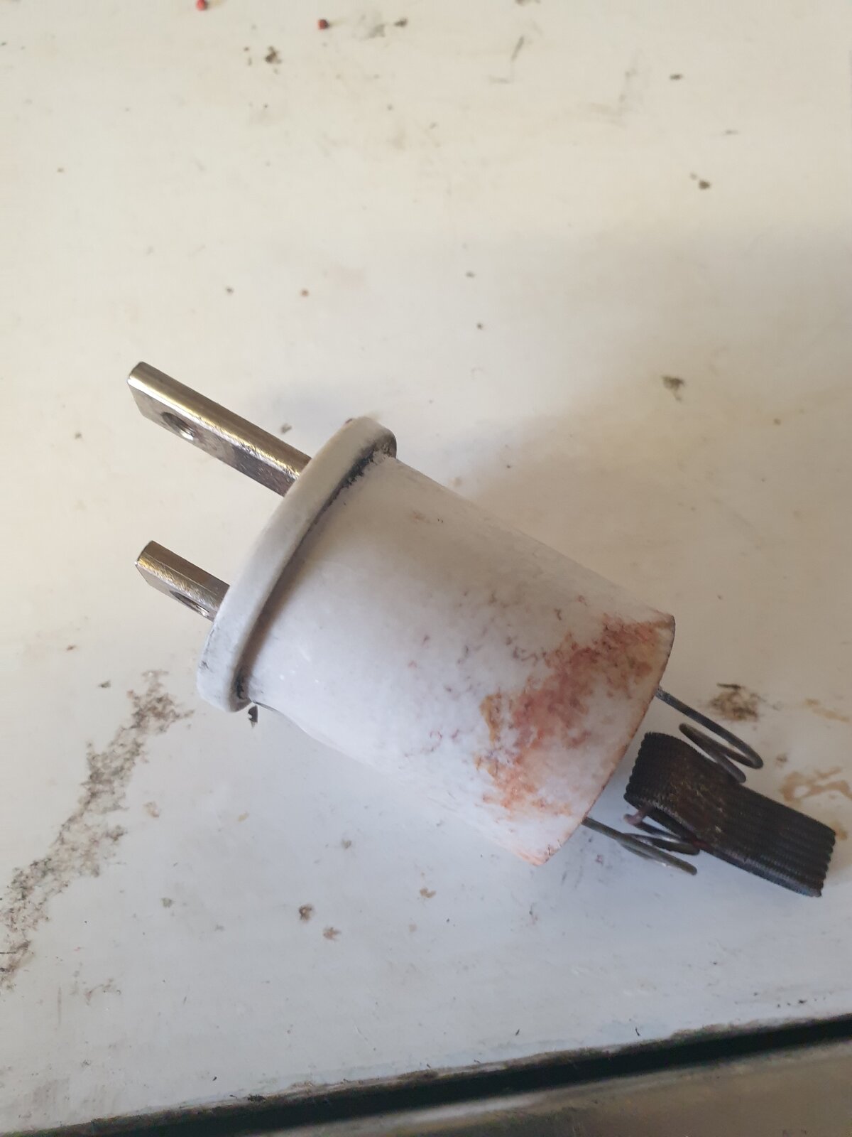

The wick should sit under the ignitor and gives off vapour to cause ignition. First clean the ignitor, and whilst it is out of the pot, flick up the stop on the oil control and run through the start up sequence to check the ignitor is working. If it is, replace the ignitor and turn the oil back on and let it run through the sequence again. make sure the wick does not touch the ignitor, or that the fuel does not touch the ignitor.

Would the wick have been secured to the self tapping screw and lie under and across the ignitor or does it just sit in the bottom of the pot?
It looks pretty much past its sell by - are wicks available and how would I know what wick to get (I do have the old one).

The wick should be held in place beneath the ignitor. The braided strap on the ignitor should be clear of carbon. If it touches the fuel or the wick it does not get hot.

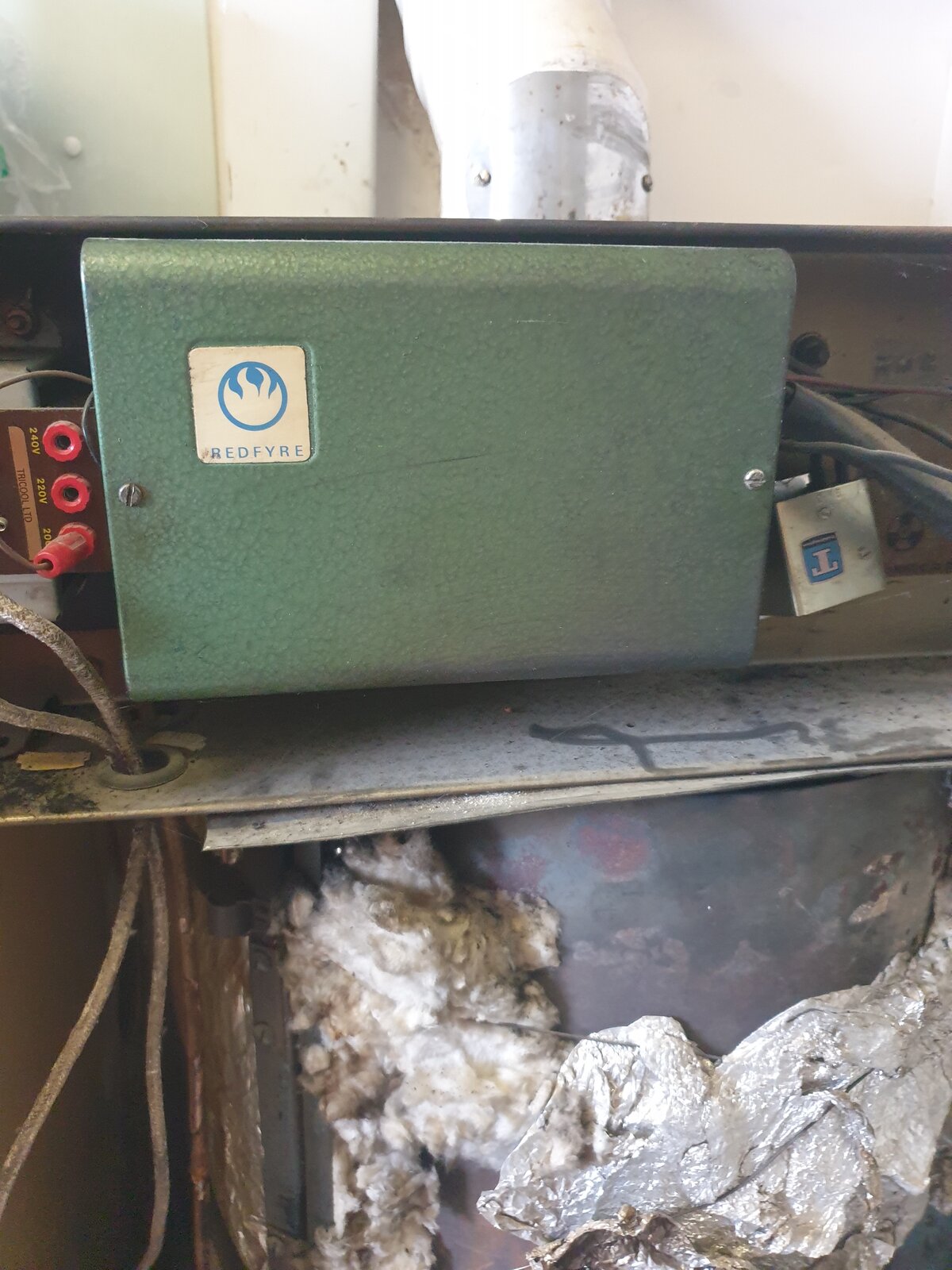

You will be able to get wick from anyone who does Aga spares, or anyone who services Aga's. If stuck, PM me with an address and I'll send you some, but if you bash and flex yours to break up the carbon, it will still work. Check if it absorbs oil. These beasts are very old and inefficient, and spares are no longer available. Weak points are the fan and the flue stat, and of course the DAS control box. It is frustrating if you get no ignition and have to wait for the cycle to finish, about 6 minutes IIRC.

Hi Terrywookfit, thanks for helping. The ignitor does have a braided strap on it but also in the bottom of the pot (I'm guessing broken off) was a wick. Not sure where/how this fits.

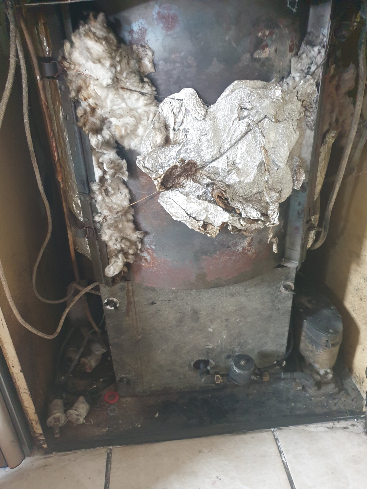

Oilhead, I can't see where oil stop is. There is a solenoid valve before a reservoir and a similar solenoid valve after the reservoir just before where the pipe goes into the pot. I'll get some photos. I think the boiler is a centramatic 50.

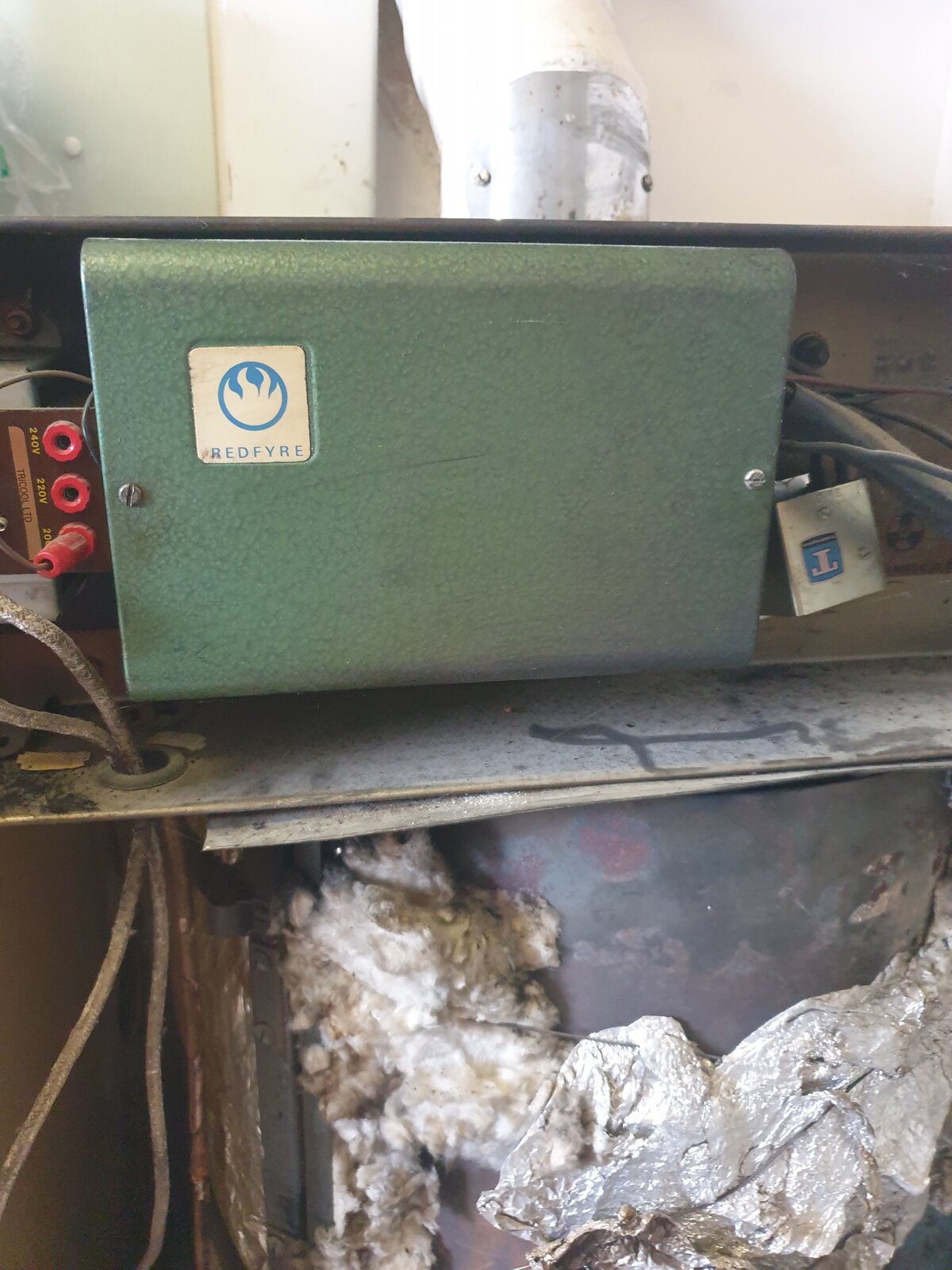

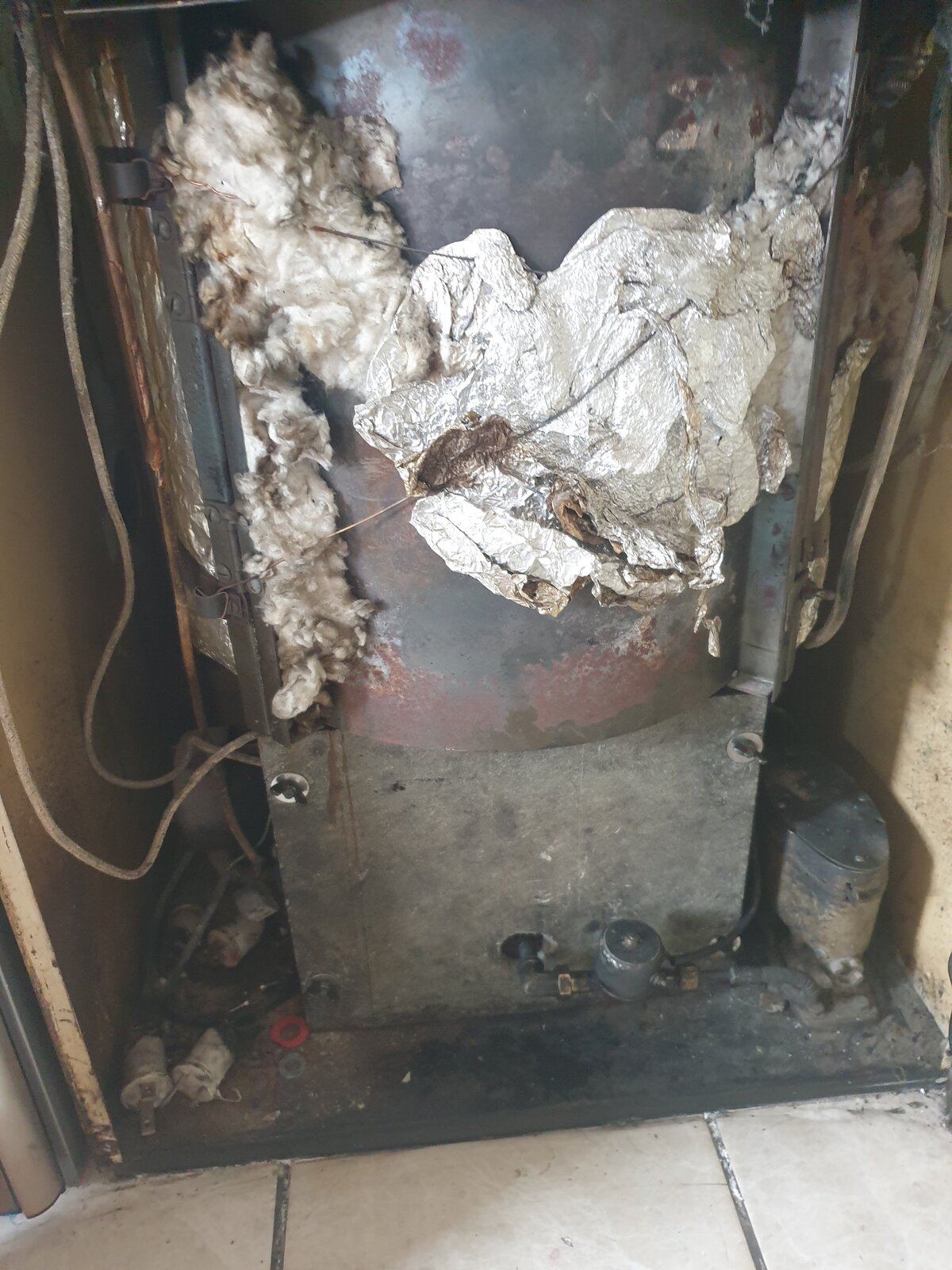

When cleaning these out, be very careful as the heat exchanger is encased with a fibrous sheath that is all that contains the products of combustion. It looks just like insulation but is an integral part of the flue passage.
The glowplug is red hot before the solenoid opens. The first drops of oil are vaporised and ignited by it!!
How could a low voltage element ignite the oil if there was no contact.

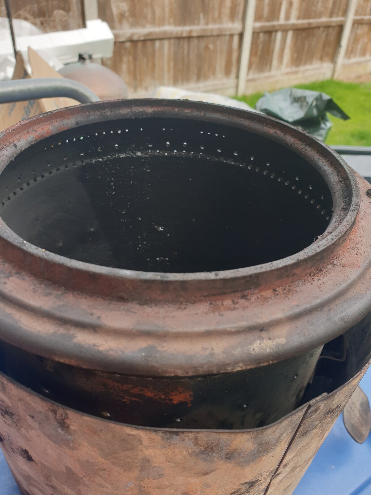

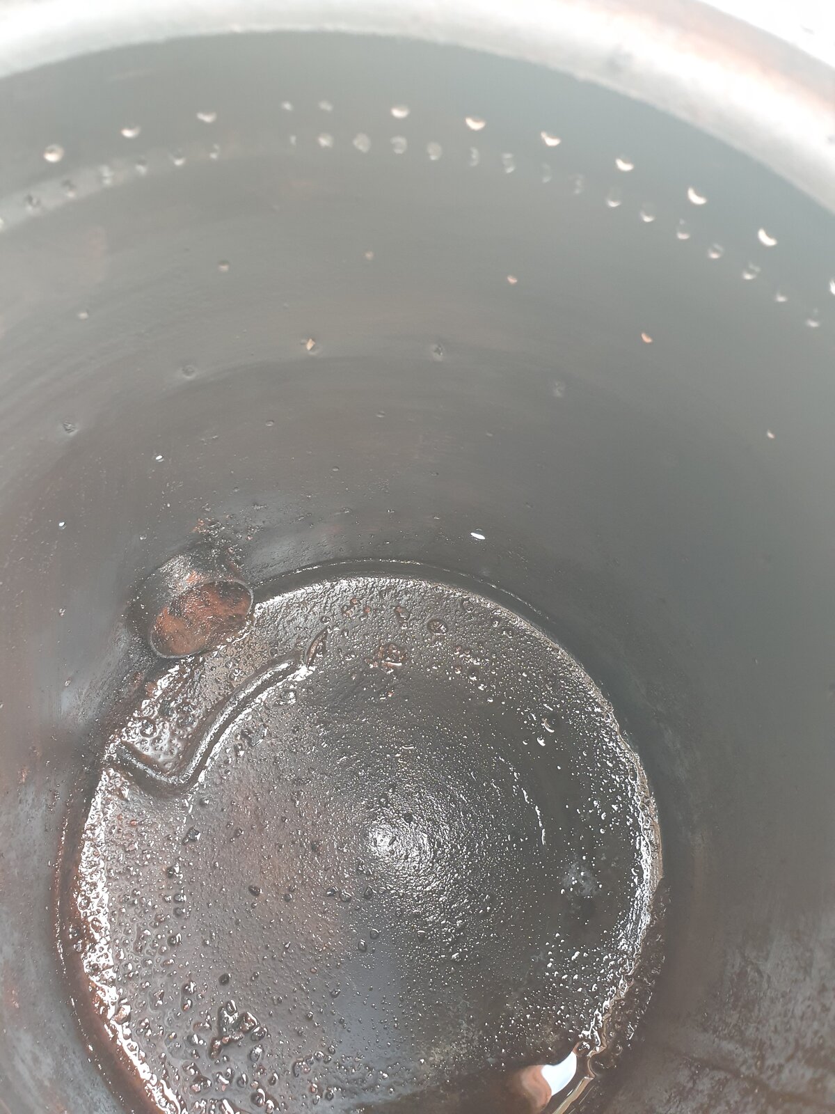

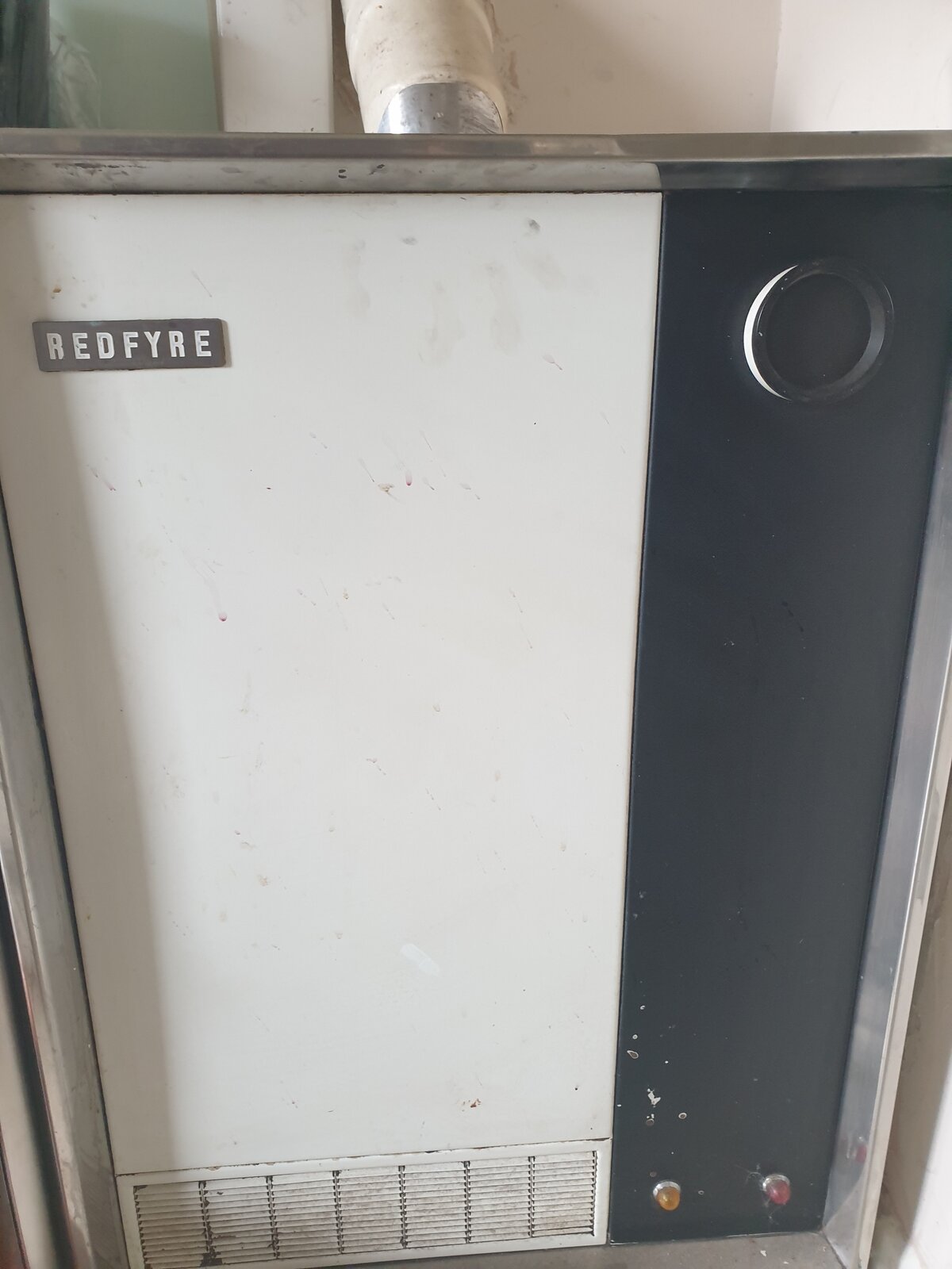

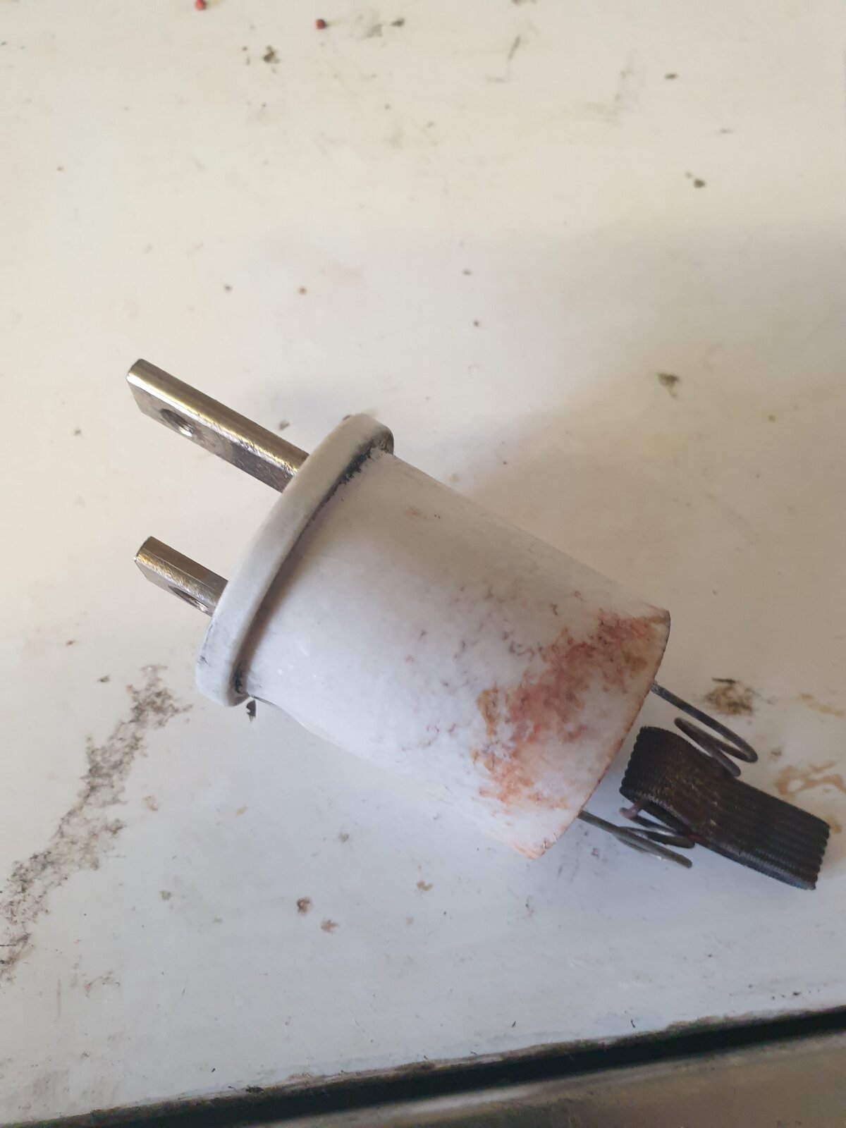

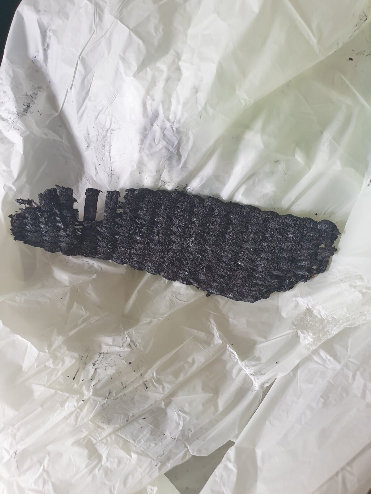

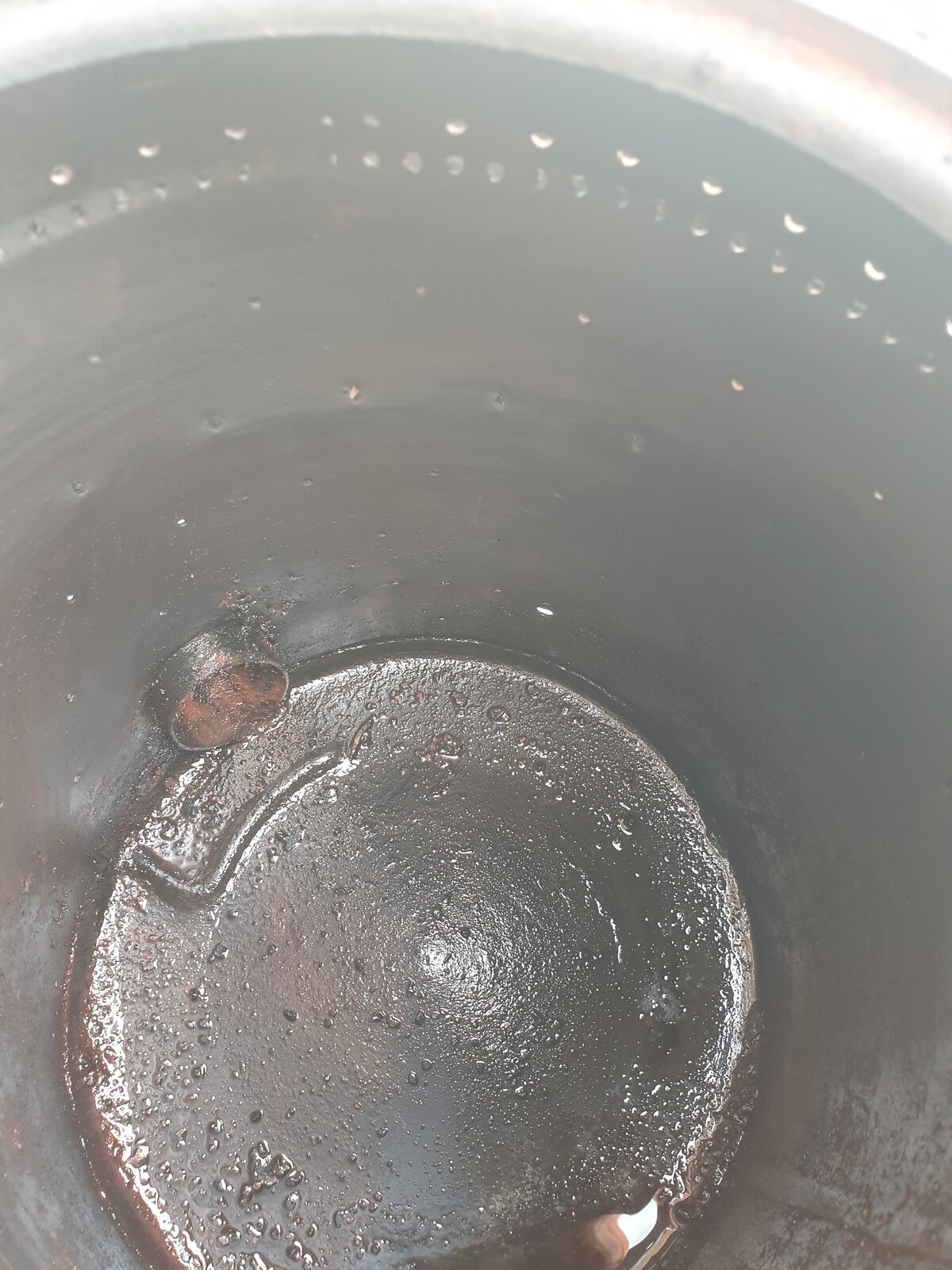

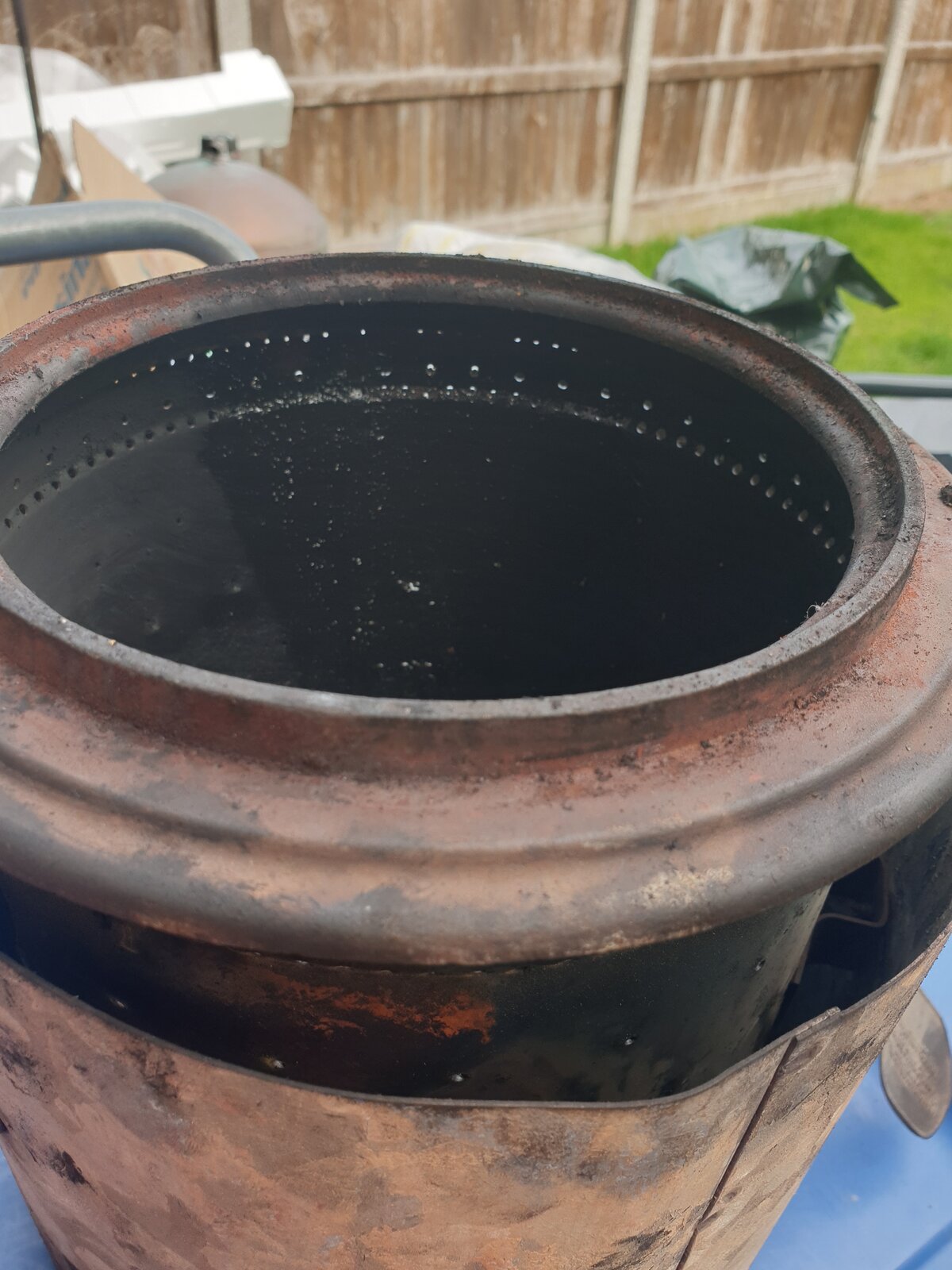

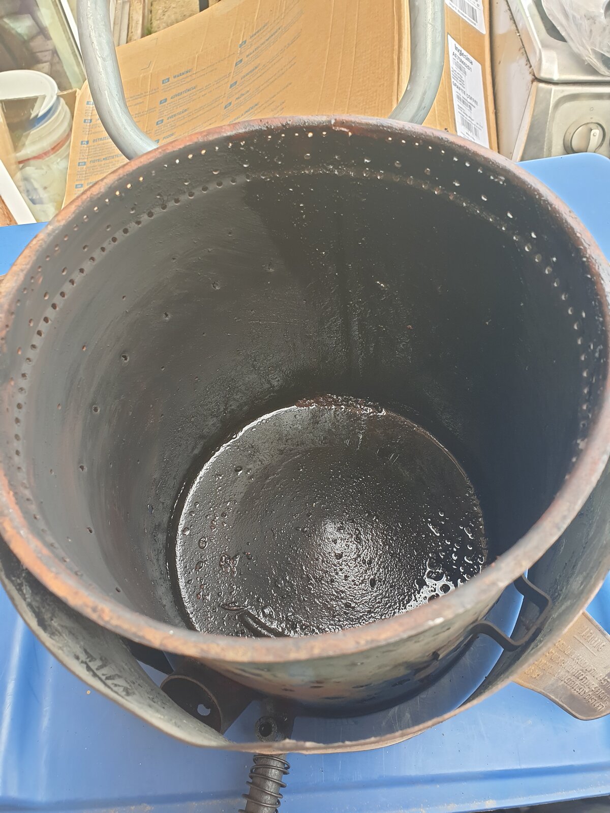

Been over and took some photos showing various components. It was definitely a wick lying in the bottom - it is/was about 4 inches long. I'm wondering whether this was fixed to the pot by a self tapping screw and small metal plate - just to the right of where the ignitor fits you can just make out the whole where the screw and plate were - and lay in the "recess" under the ignitor?

It shouldn't need a wick in the bottom.
The wick is on the glow coil.
I would burn the oil in the pot ( Out doors ) before reassembling.

The wick lies on the bottom of the pot underneath the braided wire on the glowcoil. If the braided wire on the glowcoil is in contact with the wick or fuel, it will not light as it does not get to glow.
Terry, the wick is just a small piece similar to that in a Rayburn Nouvelle boiler burner. The oil comes in and wets the wick, which gives off a vapour that is easily lit by the glowcoil. A trick often used was to substitute a small pile of sand which also gave off a vapour.
