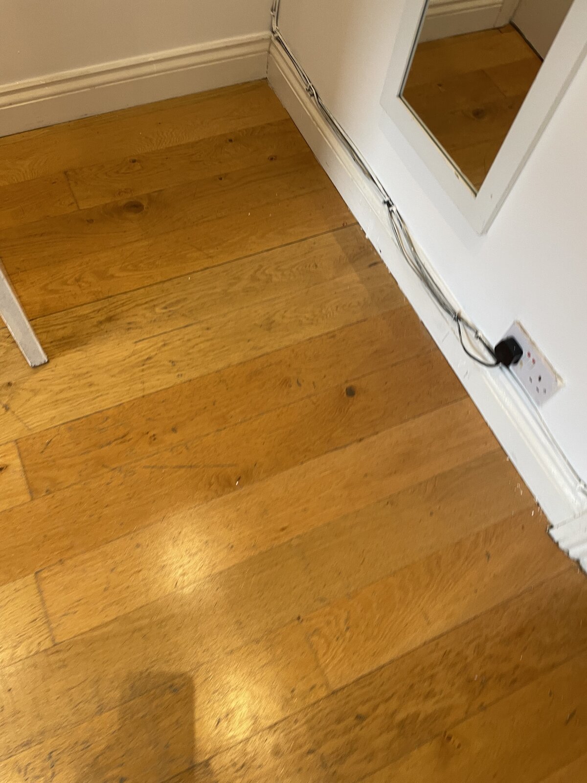

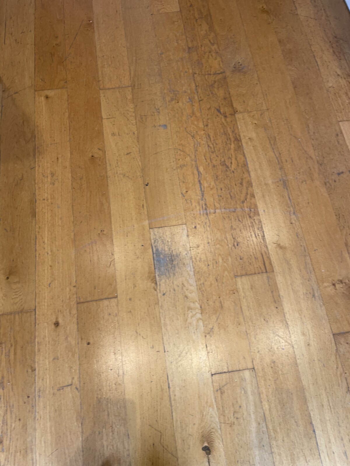

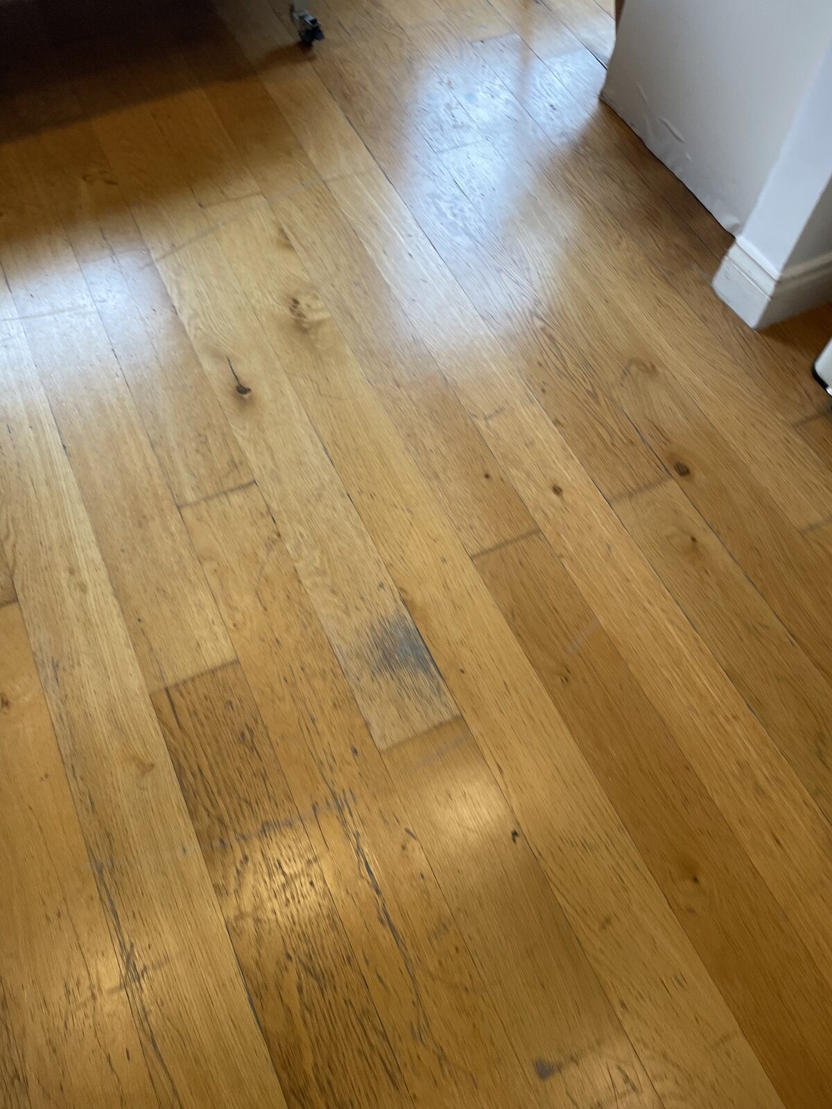

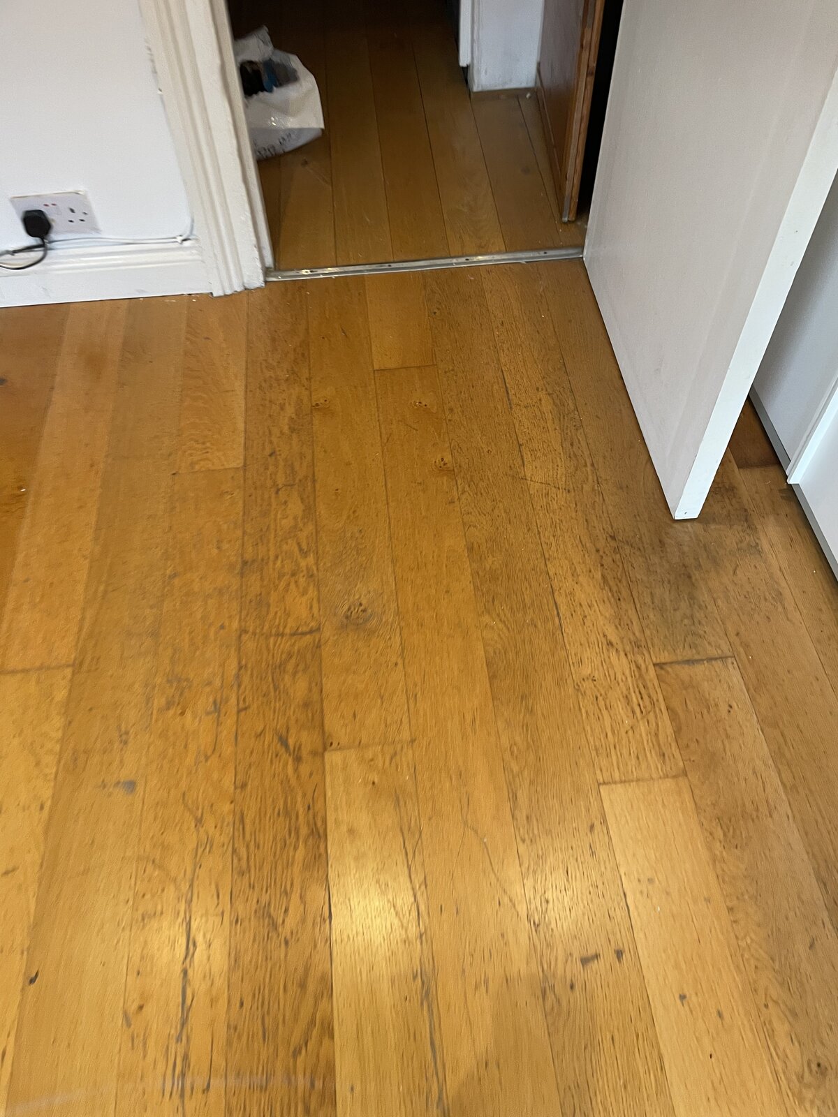

Hi fellow colleagues
I have a wood floor which I think is engineered wood but I cant be sure
I dont want to replace it because I cannot afford to - Is there a way to put some shine back into this flloor witha wax or oil ? I prefer something super simple so can i just paint varnish on top or will that look silly?
I dont even know if this is varnished or oiled - Anyway to determine which it is ? I know if it is wax thena wax coat should be put on and if varnished then a varnish coat put on
Is there no product which you can apply to seal the floor regardless?? Danish oil or something similar?
It could be a Lacquered, oiled or waxed floor, it’s unlikely to be varnished.
If it’s lacquered then it has a polyurethane wear coat over the wood itself, this needs sanding off back to the wood and then a treatment can be done.
If it’s oiled or waxed then a light sand/key then floor oil over the top.
what can i do with basic diy stuff? Can I put oil straight over or paint varnish or something else?
I do not have funds to hire a sander and I have done it before it causes a mess
If it’s a lacquered floor you can’t do anything at all without sanding it.
Don’t varnish it.
If it’s an open grained finish - oiled or waxed - you can use floor oil on it, if your not sure, try an inconspicuous area and see if the oil soaks into the grain or sits on the surface.
