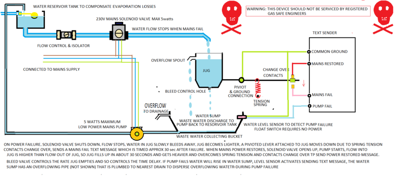

As I bumped this thread and people started coming up with strange ideas, so I thought why not have a go myself and make it even stranger:
I did not show power source for text messager, I am assuming it has a 10year Lithium battery and it will only use power during sending text messages and after sending a message it goes into standby mode (sleep) drawing less than a micro amp. If not you could wire a small charger and use rechargeable NiMh batteries similar to mobile phones.
Does not use electronics, uses basic plumbing gadgets, readily available, one can use a couple of float switches in the sump where the pump only runs if water level reaches a certain height, and stays on until the second float switch drops down switching off pump. saving on power.
And no excuses accepted for debris or dirt in the water causing any blockage, we can use Magnaflow filter. Let us use our full CH potential.
