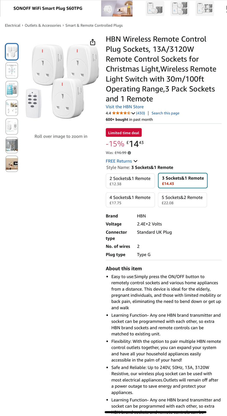

My parents currently control their electric fire on a one gang double pole switch.
Do you know where I can buy one of these with a remote fob control please?
It is to support a mobility issue.
Thank you in advance
What is the Wattage (or Current) of the Electric Fire.
Is a Double Pole switch necessary?
Here are some 30A Remote Control relays,
which could be placed between the existing switch and the Electric Fire.
(https://www.amazon.co.uk/s?k=remote+control+switch+240v+relay&crid=24LZDJZH2BUR8&sprefix=remote+control+switch+240v+relay,aps,425&ref=nb_sb_noss )
(They may not be Double Pole.)
Of course, it would be necessary to find a place to mount any such device.
Therefore, photos of the Switch, wiring and Electric Fire installation my be of assistance.
If the Electric Fire were to be connected via a normal Socket Outlet,
one of these may be appropriate
and
the same Remote Control could be used to control other Plugged-In appliances.
You can get remote plug-in sockets to go between the wall socket and the plug. We use them for our Christmas tree lights as the sockets are hidden behind the tree when it’s up. Look on Amazon or EBay. Plenty to choose from just make sure they are rated higher than their fire can draw. These should be okay I’d the fire is running from a socket already but there are others.
You could wire in a suitable online switch in the flex. A bit heath Robinson but doable
That's got to be the best route. With the one shown you get a couple of extra sockets, I bet your parents have a couple of other places they could use those?
