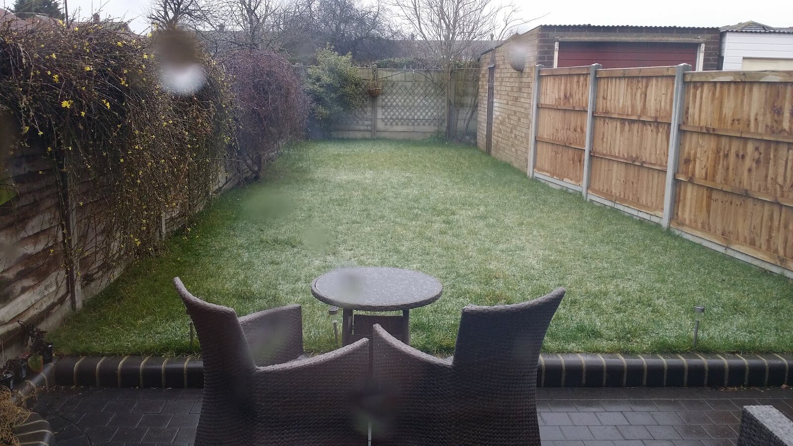

That said, it's just occurred to me (a doh moment) that maybe I don't need to make holes but attach the poles to the fences, but I don't know if that's wise? Have a look at the photo and see what you think.
The fences on the right are about 5'10 and the ones on the left (older) are about 5'7. In case it's not clear, the left also use concrete posts. Do you think both sides would be sturdy enough?

You have loads of garden there, plenty of room to put a stake in further out and a guy to a pole !!!
Do not try using the fence pole.
If you put a 2' stake in 10' (ish) back left and right then you can use a lighter weight pole (see aerial suppliers) that has a guy rope/wire to the stake and they should hold it OK.
Look at whats available from https://www.aerialsandtv.com/

That said, it's just occurred to me: the shade sail will have a decline from the house, when it reaches and stops near the beginning of the lawn, it should be about 2 metres high by then. By the time the rope or wire reaches one of the fence posts, it should be at a height where I can simply attach something like a heavy duty screw or bolt eye to the posts . Do you think the posts will be strong enough to take it? This would certainly be the most simple, clean and cheapest option, the latter being important!

First thing is "who owns what?"
if the concrete fence post is yours, you can fix to it. Ditto Garage(?) wall.
If not, you need permission.
The wooden fence looks too fragile
If a fence is 6' high, it uses an 8' post.

That seems to be a solid yet cheapish option and something I should be able to do. Would like to find out first or know somehow if those concrete fence posts are capable to be used to attach an eyebolt of some sort. I don't know much about gauging structural integrity especially when using a shade sail.
I'm pretty sure the fence on the left is mine, the right (and garage) is definitely mine! The neighbours wouldn't mind me fixing an eyebolt onto one of them anyway although I wouldn't want to damage it! The actual wooden fence on the left has certainly seem better days but the concrete posts seem okay.

A guide rope/wire only needs to go back about 6 foot from the pole assuming you have a good stake into the ground at an angle.
If your ground is loose then a longer stake may be needed.
Yes you can use the fence way back at the end of the garden but adding the forces of a sail pulling in the wind may cause problems, depending upon how well the fence posts are secured in the ground. do not attach to the fence panels in any way.
