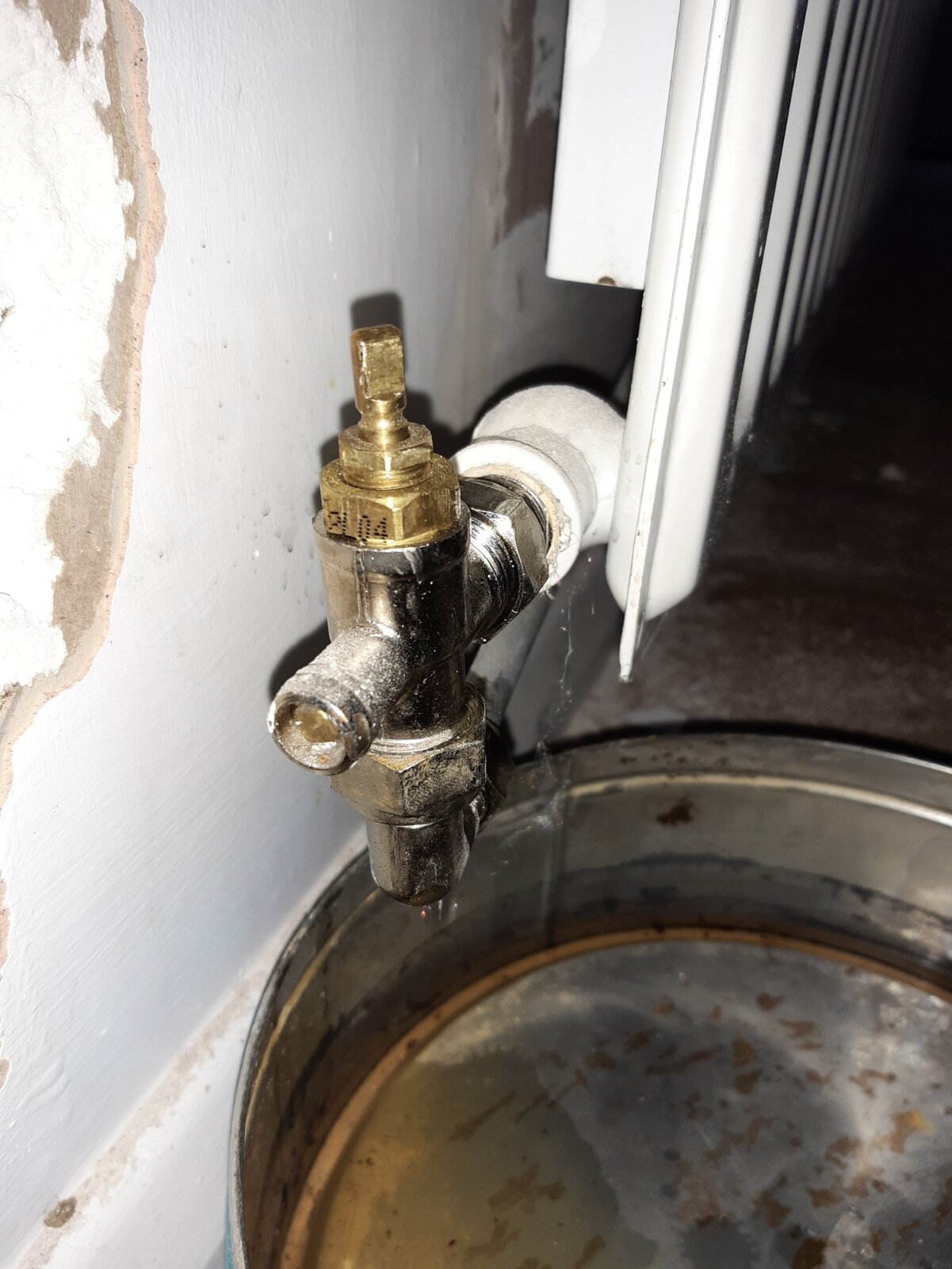

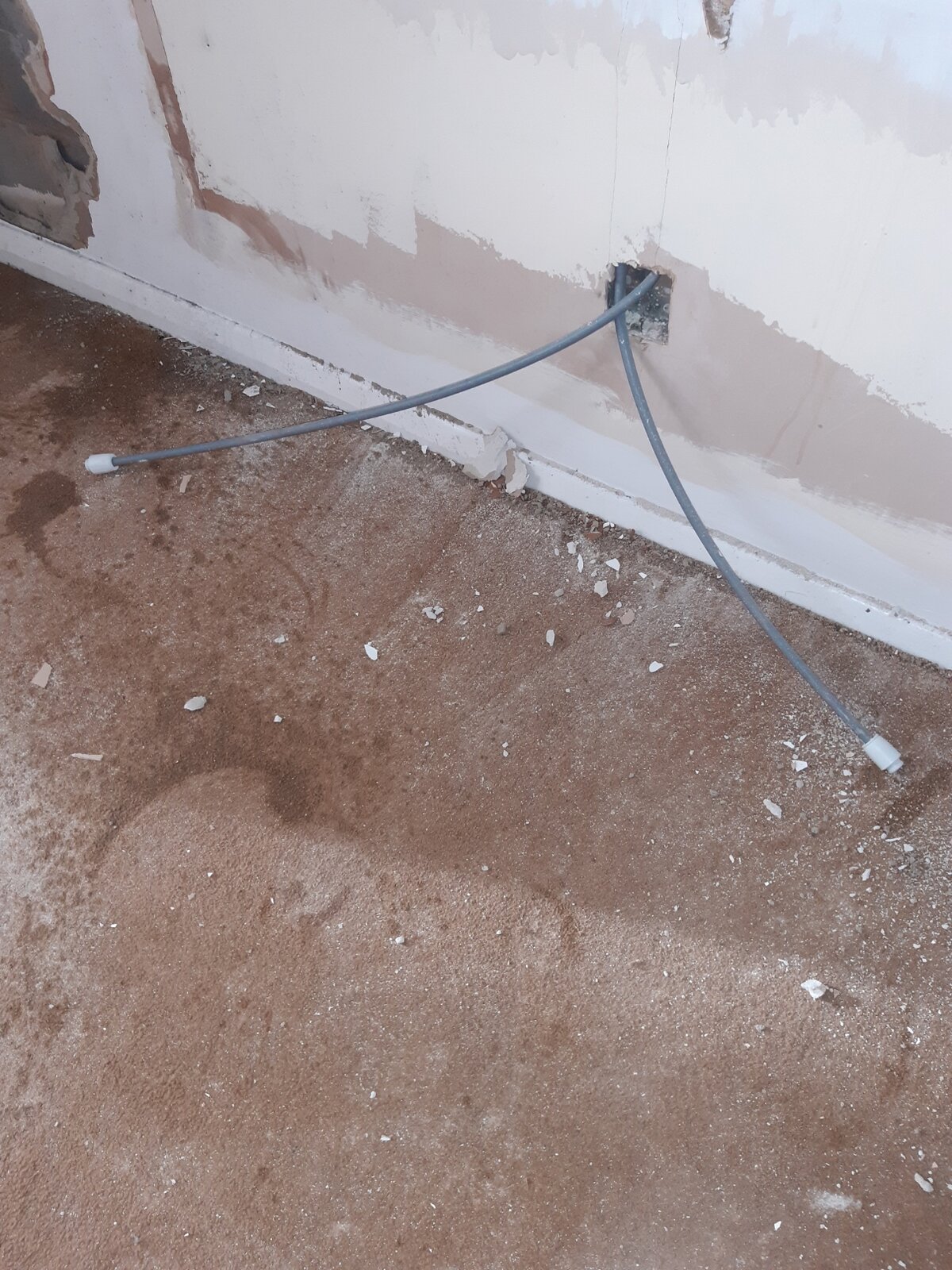

Hi All, radiator and valves successfully removed and pipes fitted with stop ends. Not too much water spilt !! I have attached a photo of the lockshield valve with what looks like a drain off point with a square key inside !!
Yes ,it is a drain cock. You would close the valve ,then remove the square shaped spindle . Fit a hose and open the rad valve.
Thanks for educating me !! Not seen a valve like that before. You live and learn when you use DIYNot !!
