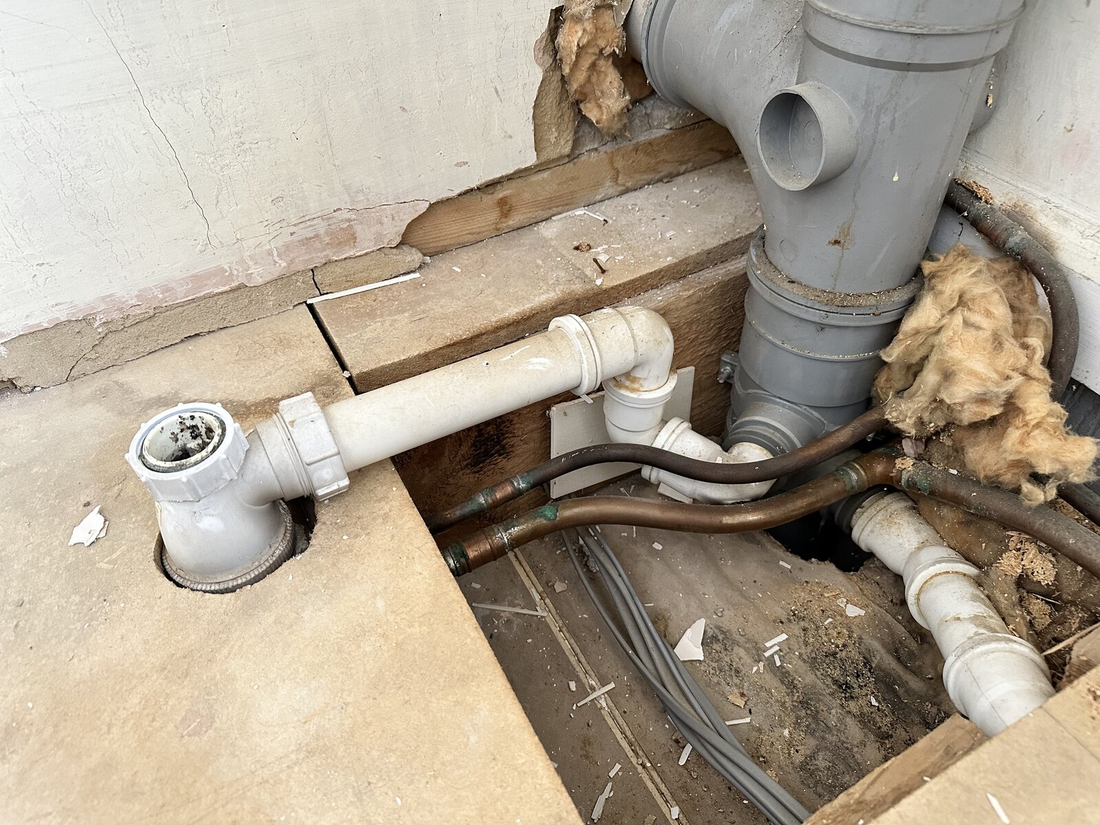

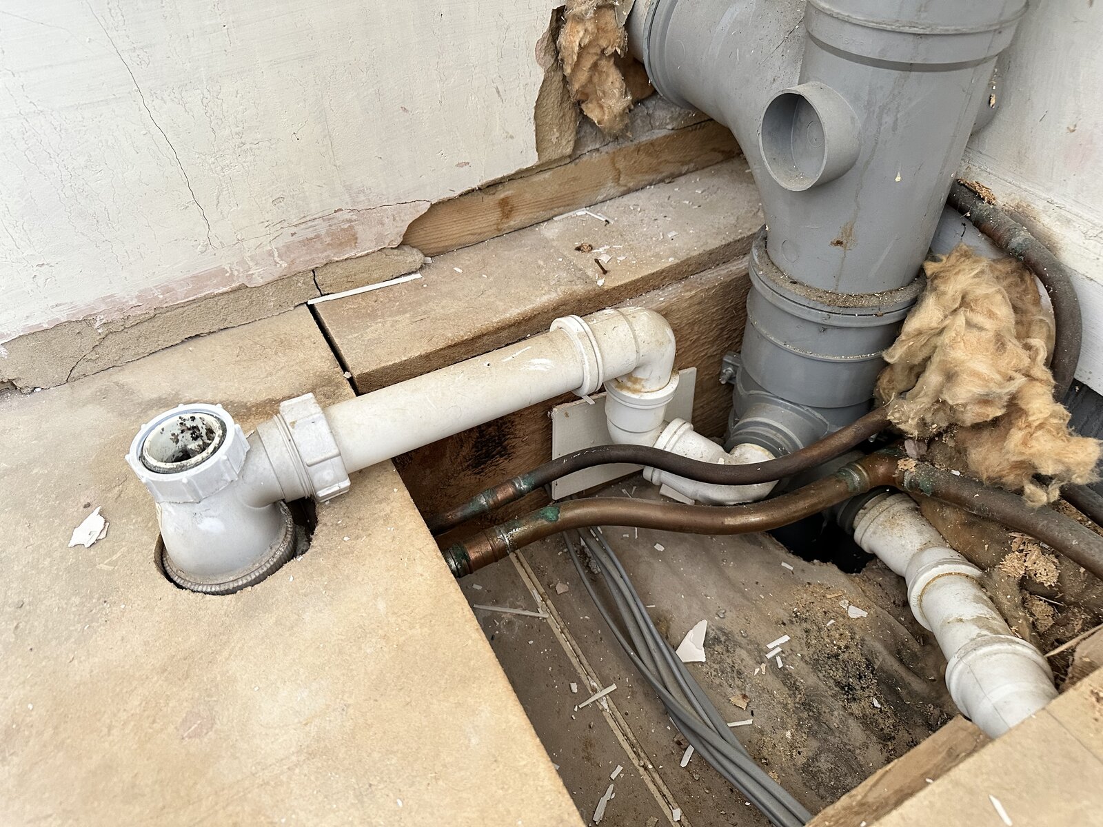

Hi all
I need to remove or block off the upper of the 2 bosses that feed into the soil pipe. There's not enough room to cut a section out and replace using a slip ring which seems to be a common method, so wondering if anyone has any alternative suggestions?
Neil

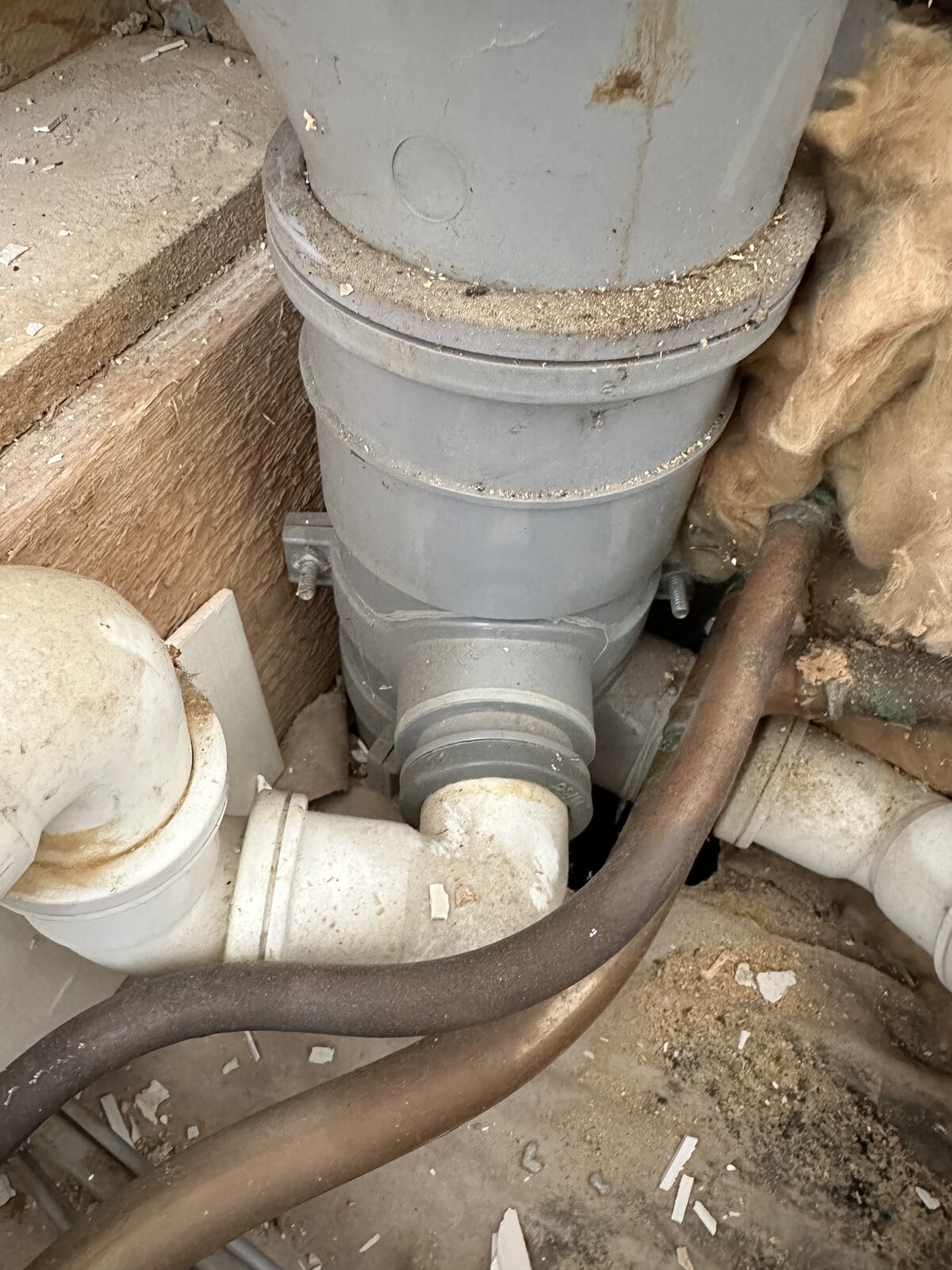

Thanks. Looked perfect so I went and bought one, but when I tried to fit it it appears that the pipe outside diameter is 43mm rather than the expected 41mm for push-fit. The fittings appear to be marked OSMA 841 1 1/2 - any idea if a similar item exists for these fittings?
Same OD size as solvent weld by the sounds of it then. I'd try one of these. Take all the pipe out apart from the elbow that's in the stack, turn it 90deg until it's vertical, cut and pop in a little bit of the straight then put one of these on it.

One of these straight into the boss socket (43mm od) ...
I would ensure you have a leak tight joint before putting any flooring back, problem you have there is, the seal in the boss will have hardened over time, and whilst its not an issue at present, removing the old pipe and fitting new may cause it to leak. If needs be, some silicone round the plug before pushing it home, and I'd put a cable tie (or 3) around the whole lot to secure it onto the boss.

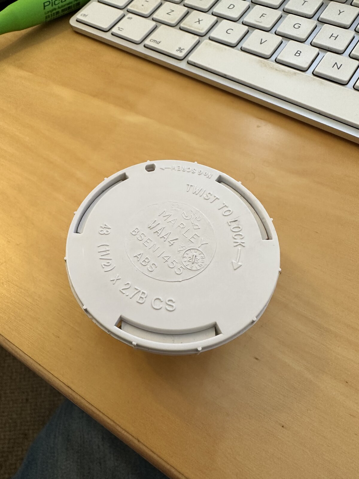

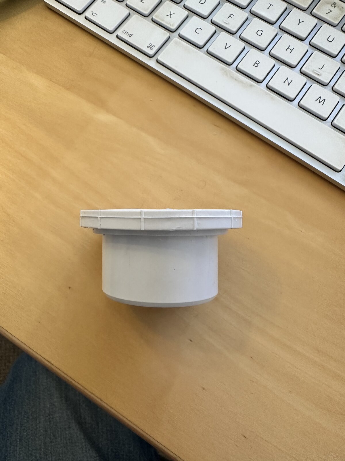

Thanks all. Ended up getting one of these, which is pretty much the same as the one suggested by others above
As I don't want it to ever come open I solvent-welded the lid on

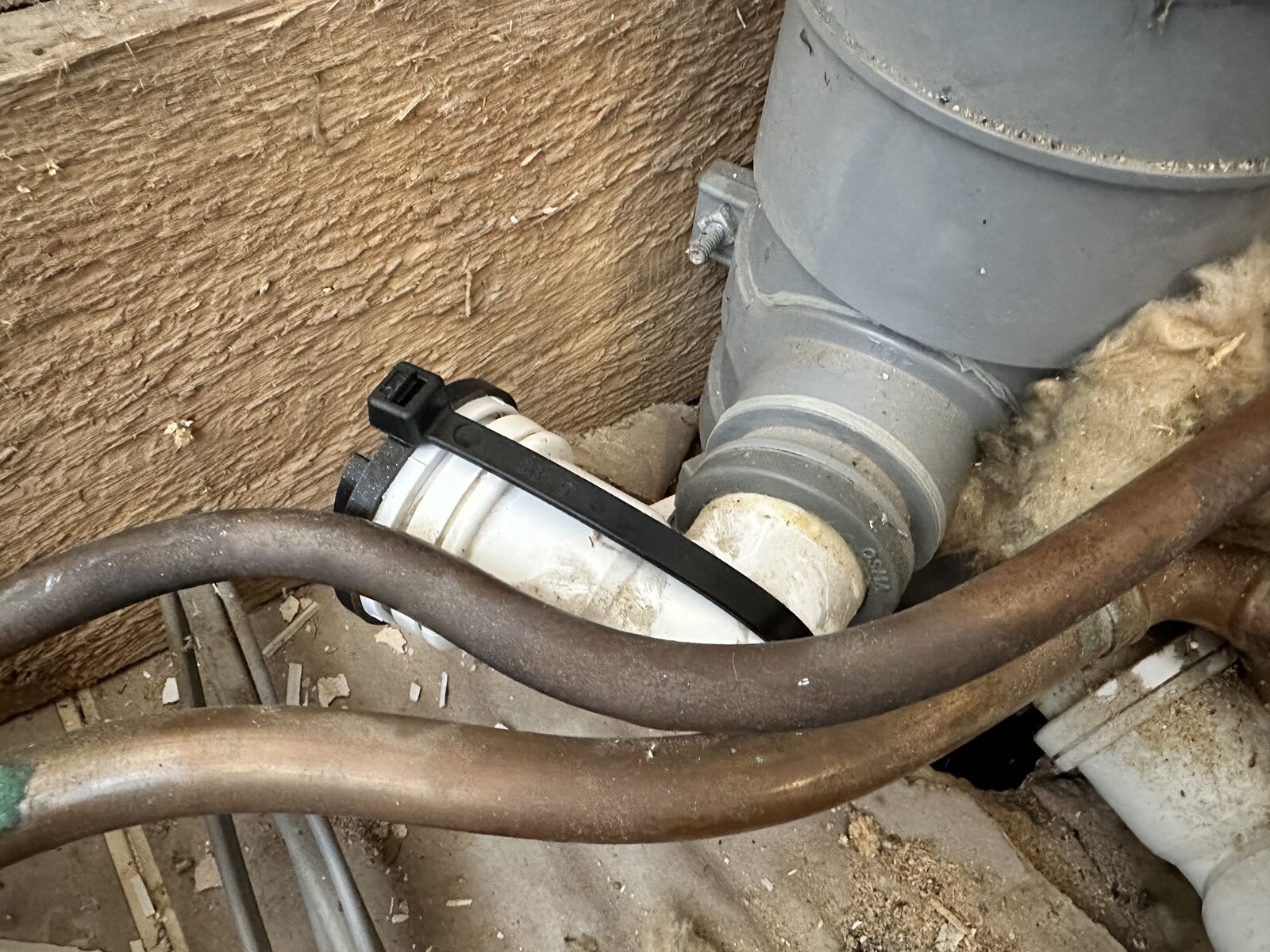

End result looks like this
The elbow can't come out of the boss without being cut because it hits the lower copper pipe, and the zip tie will stop the new plug from coming loose in the other end of the elbow. Will monitor for leaks before replacing the floor (at the rate at which I get jobs done this will give several months of monitoring time...). The elbow is just a little bit above horizontal so nothing should accumulate in there, but looking in there it was pretty clean/dry anyway so I think that the downward flow from above mostly misses it
