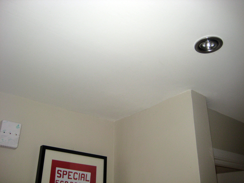

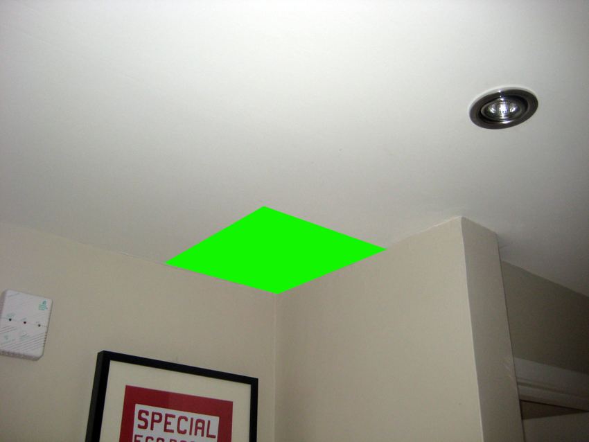

the section in the kitchen with the white line where the stack originally was. The green is the nearest joist.
The surveyor when I bought the house said that the kitchen (base) section of the stack had been removed and without disturbing the 1st floor floor (which I did after) or the kitchen ceiling below was impossible to see how it was supported.
He said the stack above roof level needed repointing and the rest of the internal stack looked in good condition with no signs of stress and had been like that since at least 2003 when the previous owner lived there (who didn't carry out the renovations)
There were no building regs applied for or noted.
So, rather than repoint it I got my own surveyor in to have a butchers, I took up a few floorboards and there was no obvious signs of support. The surveyor said maybe some steel across the 90 degree walls. Or the joist may be helping support it.

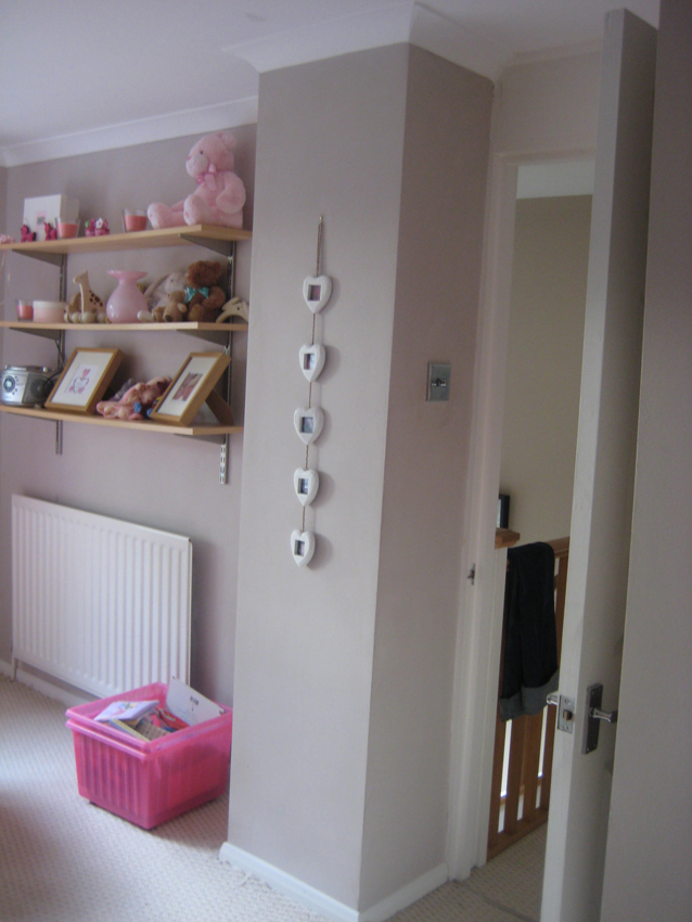

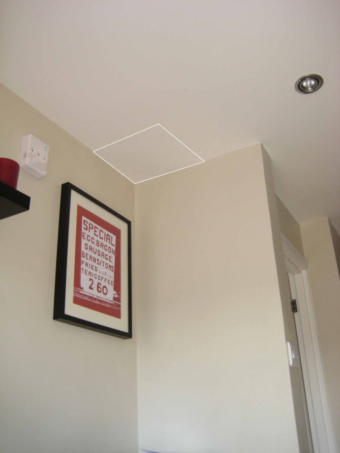

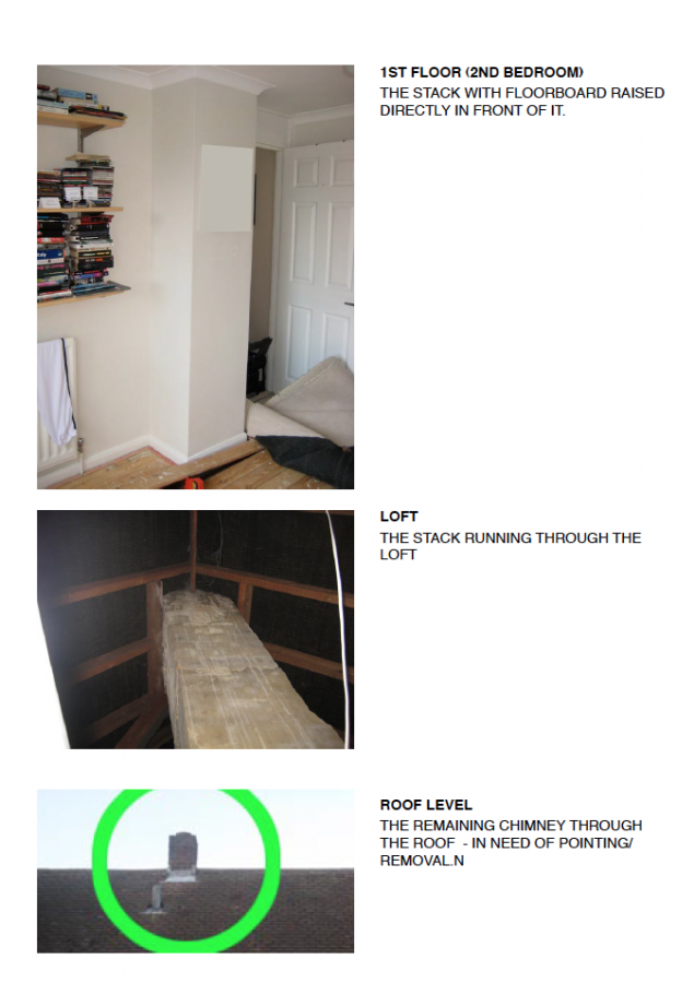

HOW IT IS CURRENTLY
When i ran a pipe/wire detector over the green area (to test for a steel of some sort) it picked up metal in some places but I couldnt find a consistent length. It is rock hard to tap.
BEDROOM:

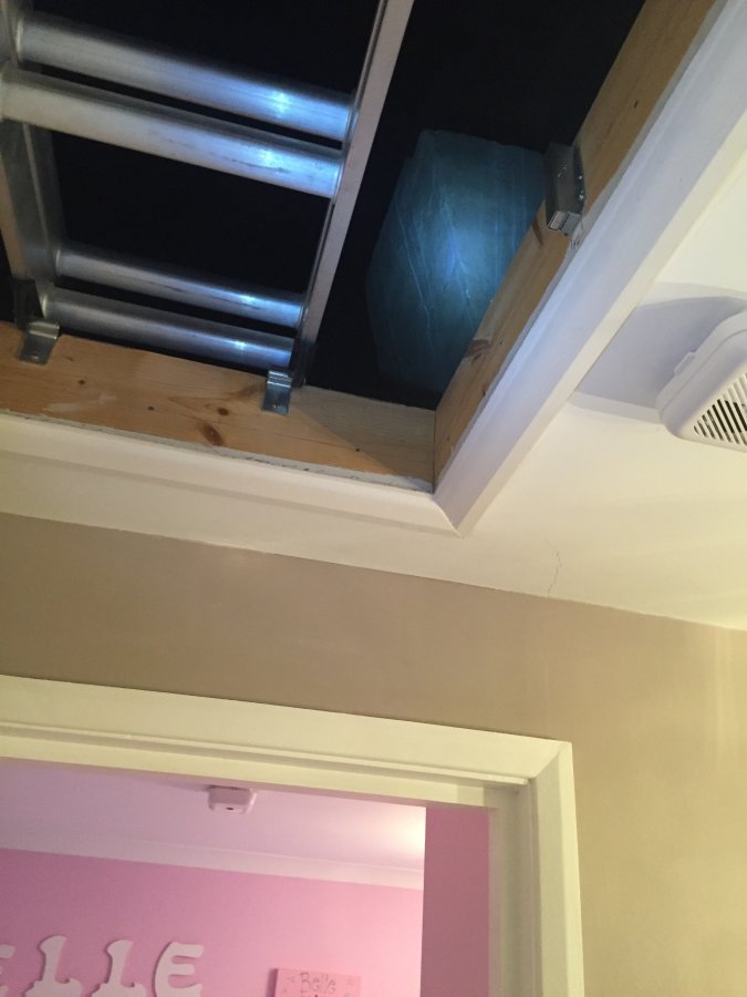

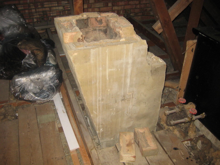

LOOKING DOWN FROM LOFT

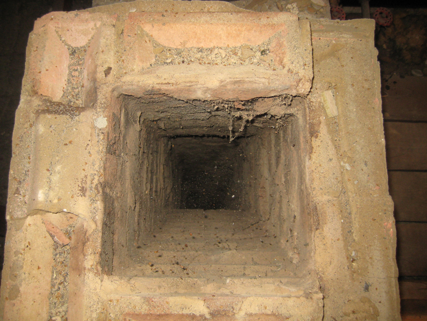

remaining stack in loft:
So, for peace of mind so should I get rid of it or leave it be? that is what I am asking myself
Any opinions welcome
Cheers

You will need building regs approval (about £143), but it's just an inspection job to make sure it's up to standard and gets signed off. Using an angle grinder in the loft isn't a good idea for your breathing - even with a mask, but you could try using a small grinder to cut into the mortar courses, and then try levering the bricks off
As you've already got cracks in the ceiling, I'd remove the chimney completely, and then replaster the ceiling.
Cheers Doggit, the cracks are hairline and havent got any worse, but I take it from your post you'd want shot of it for peace of mind?

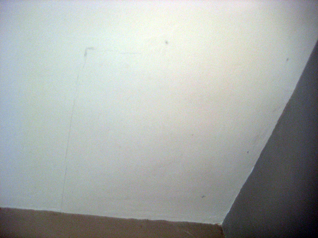

EDIT, if you're refering to the hairline crack on the 1st floor landing I think that happened when the loft section of the stack was removed. It hasnt got any worse from my knowledge.
Doggit do you mean JUST the section in the loft or the remaining section in the bedroom?
If you're taking out the chimney breast in the bedroom, then do the loft as well (or even the other way round), and then just fix any cracks that have appeared.
You'll get a bigger bedroom that will lay itself out better, and you get rid of all the problems once and for all.
That's what I was thinking mate
Would you hazard a guess on removal and making good?
Taking out is a DIY job, hammer bolster, muscles and rubble bags.
Making good will take about a day to bond the walls, and patch the ceiling with new plasterboard, and then a day to plaster it. What are the rates like in your area. You'll then to sort out the skirting boards, and do the carpet.
