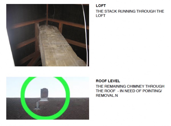

Why would I need scaffold if the stack has been removed below roof level and the roof made good?
Because if the stack is removed below the roof line then the stack above the roof line is no longer supported rom underneath.
So the scaffolding will be needed for safe access to the stack to ensure that either 1/ it is securely attached to the wall and the wall is strong enough to support it or 2/ the now un-stable stack above the roof can be removed before it falls
Have you read the thread? the stack has been removed under roof level already.
Read the thread its pretty self-explanatory.
Don't let it worry you sjchapman; a lot of these replies are done late at night, so sometime get skimmed through, and just the later posts replied to. All done with good intentions though.
Then I hope the stack above the roof, if still there, is properly supported.
How long ago was the stack below roof level removed and what was done to support what was left.

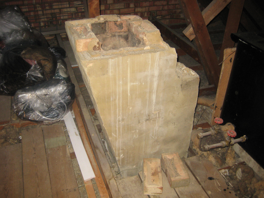

Maybe you've taken the weight off the lower chimney breast by removing the upper bit but
why not remove the stub in the loft and the chimney breast below?
Use a hammer and cold chisel in the loft. Knock a brick one way and then the other and then prise it up with the chisel. Do one brick at a time.
You dont need a power tool.
Stuff something down the flue to stop debris dropping.
Anyway, cut a long story short he said get it down above roof level to about 600mm in rood level.
Which I did, then the removal (hammer and chisel) started to cause a bit of stress on the bedroom ceiling so they stopped at 800mm.
The reason I post this is even after 6 years since this was done (and no signs of stress/cracks etc I'm still uneasy about the section in the loft above my daughters bedroom)
In answer to you original question, I very much doubt that is going anywhere, if breaking it up started to disturb the ceiling I would guess it's pretty solid

I am going to leave mine in the bedroom as (as two surveyors an architect and a very reputable builder that done my extension said) there is no visible signs of any stress or defect, but I am (going to get someone) to remove the remaining section of stack in the loft. Probably by using an angle grinder as much as poss so as to not cause any more cracks to the plasterboard ceiling in the bedroom.
