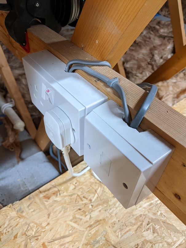

In my loft I have a double gang 240v socket and a (is it?) FCU. I think this was something to do with an air filtration/recirculation unit the last owner had but removed it. The socket has been left in situ working but where its located is a bit inpractical as they are in the middle of the loft. I also note there is no fuse in the fcu however the sockets still work?
I would like to remove or possibly relocate these sockets but would like to pick your brains.
These sockets are are on the downstairs lighting circuit. This seemed a bit strange at first but there is a feed from downstairs (a "boost" switch is in the kitchen for the now missing air unit) and it would have been low load, I guess it makes sense. Can anyone explain the wiring in the attached picture? If I was to remove these sockets what would be the suggested way to restore the lighting circuit. Or if I was to relocate them to somewhere else, e.g on the wall, how would I go about wiring, with consideration to differences in wire thickness requirements (sockets on a lighting circuit etc..) and protecting the lighting circuit from a faulty appliance being plugged in? If I was to retain the sockets then this would only be or very low load applications (a wifi or tv booster perhaps) and labelled as such.
If it's too complicated I'll get a sparky but just wanted opinions.

For a start, although many electricians disagree, a 13a socket on the lighting is very bad practice.
If there is no fuse in the FCU it is not supplying the socket. The wiring needs tracing. Difficult to say from the pic but I doubt removing it will stop the lighting circuit from operating.
Best to remove it and start again with a feed from the ring final. One double socket can be on a radial. More than one will need a FCU.

No it isn't, although a very small number of ignorant amateurs disagree.
It is quite a good idea to label yours, for example "max load 6Amp, for aerial amplifier only" or whatever it is for.

There you are. Told you some electricians disagree with what is common sense. Think of the consequences of someone plugging a large load, maybe a vacuum cleaner, and plunging the loft into darkness. Foot through the ceiling?
who in **** hoovers their loft?
anyone with common sense would investigate a socket up there and realise what it was connected to.
