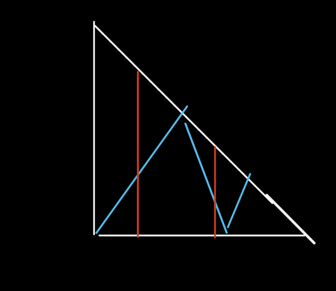

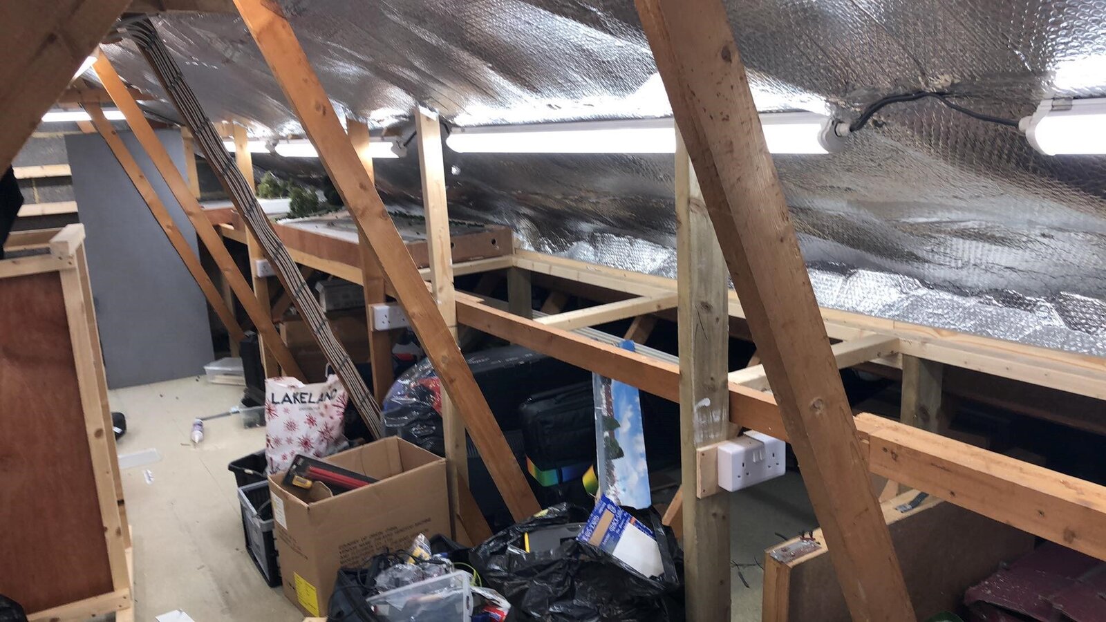

Hi all,
Looking for some advice. When we moved into our home we wanted to make use of the loft. We removed some of the supports but installed larger timbers (4x2 replacements) which go to the top of the roof which also sit on a 4x2 to spread the load over the joists. We removed some of the smaller sections but put in replacements at 90 degrees rather than 30(ish).
We recently put our property on the market and a buyer has had a rics home buyer survey done. Could some one point me in the right direction if what’s been done is fine? Or do we need to put some more timber in to brace it?
I’m starting to freak out a bit. As I would rather get the repairs done sooner.
Ive attached a crude drawing. The bits in red are 4x2 which replaces the 3x2 which the cross. The lower bit is untouched. We’ve had no issue with the loft for 5 years since doing the work. Even with red alert weather warnings and heavy snow fall.
Any advice would be highly appreciated.

Relax - don’t panic. It will be fine. If you had the competence to do the changes in the first place you have the competence to reinstate previous or enhance/strengthen new arrangements if required.
1. Without wishing to be rude to any surveyor - there is a chance they might not even notice your slight changes to the loft structure.
2. If they do notice, they might be happy with it or worst case scenario the buyer starts huffing and puffing about it at which point you promptly reinstate the original design or pay a sub £1000 fee to get a structural engineer to provide some sort of certificate of structural soundness for the new owner - you can decide which is cheaper or easier if and when you are faced with that decision. No big deal!
Don’t panic - I would do nothing for now - sit tight and see if anything comes back about it.

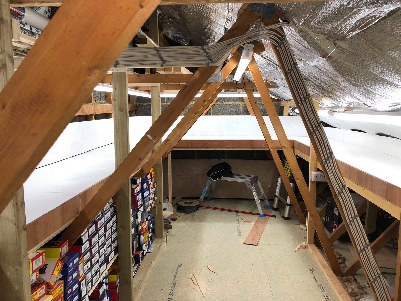

If the original roof was a truss-roof (with the members joined with metal plates) you should not have removed the blue sections.
While you may believe the roof to be 'OK', a surveyor will flag this up.
How old is your house?
Hi Tony,
It's a 1980's build.
That figures because most houses from that time have truss roofs.
Did the timbers you removed have metal plates to connect them?

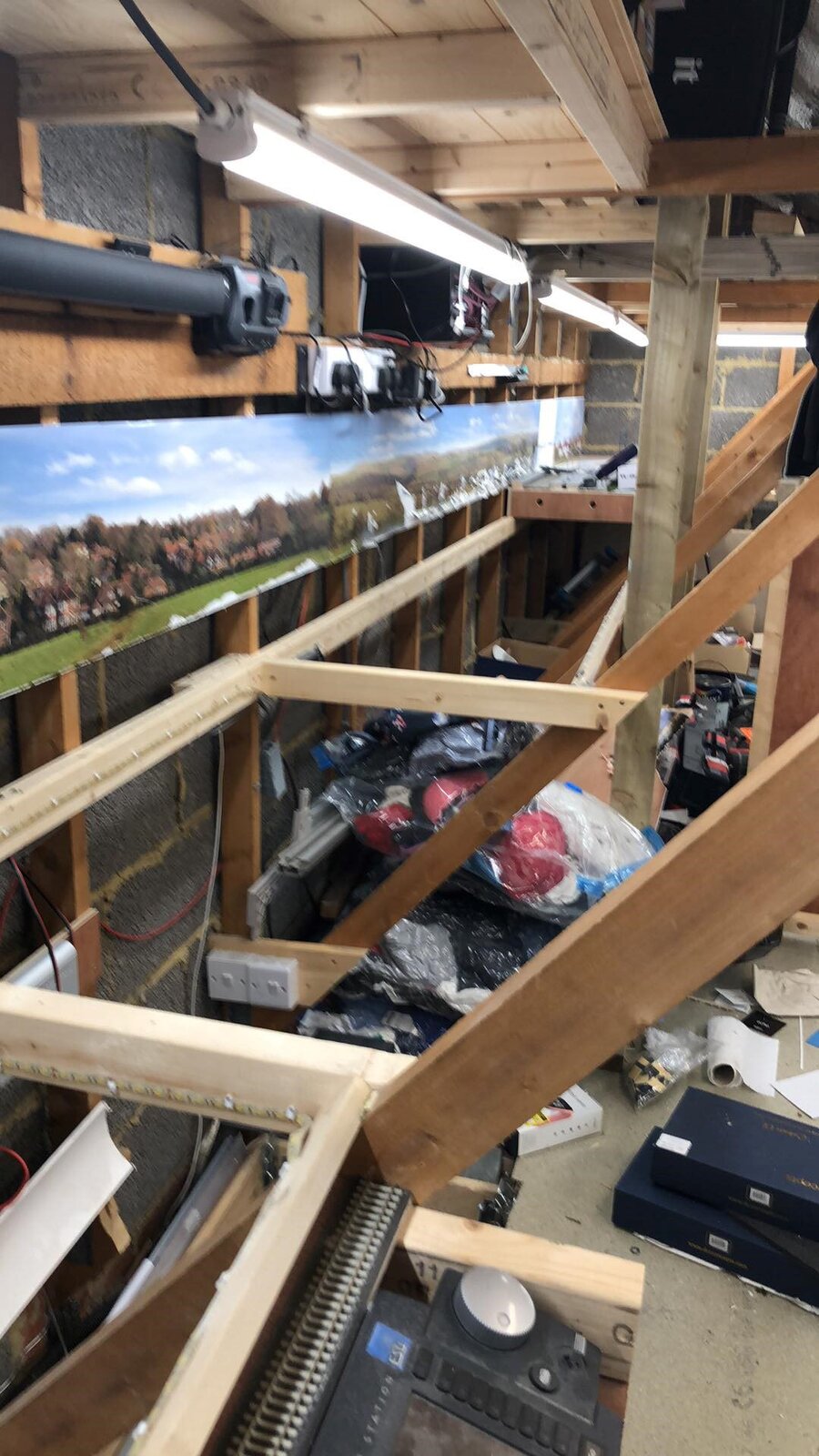

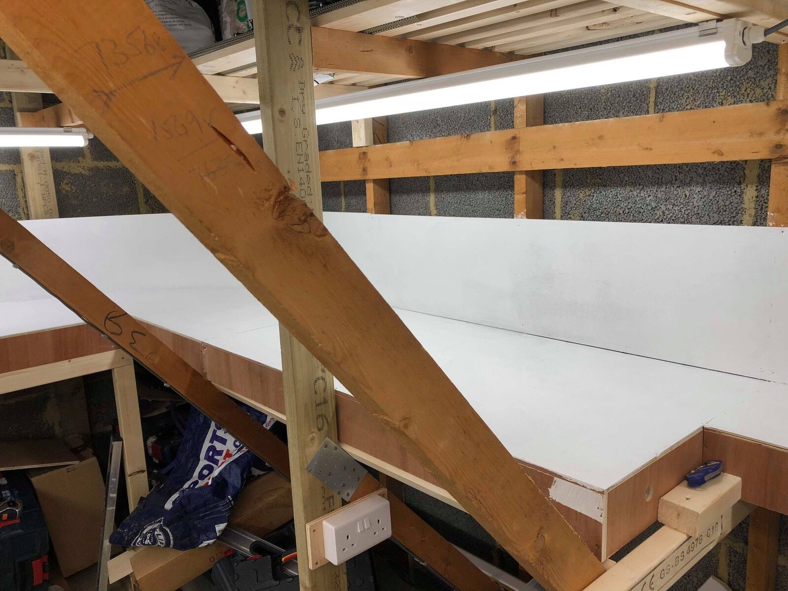

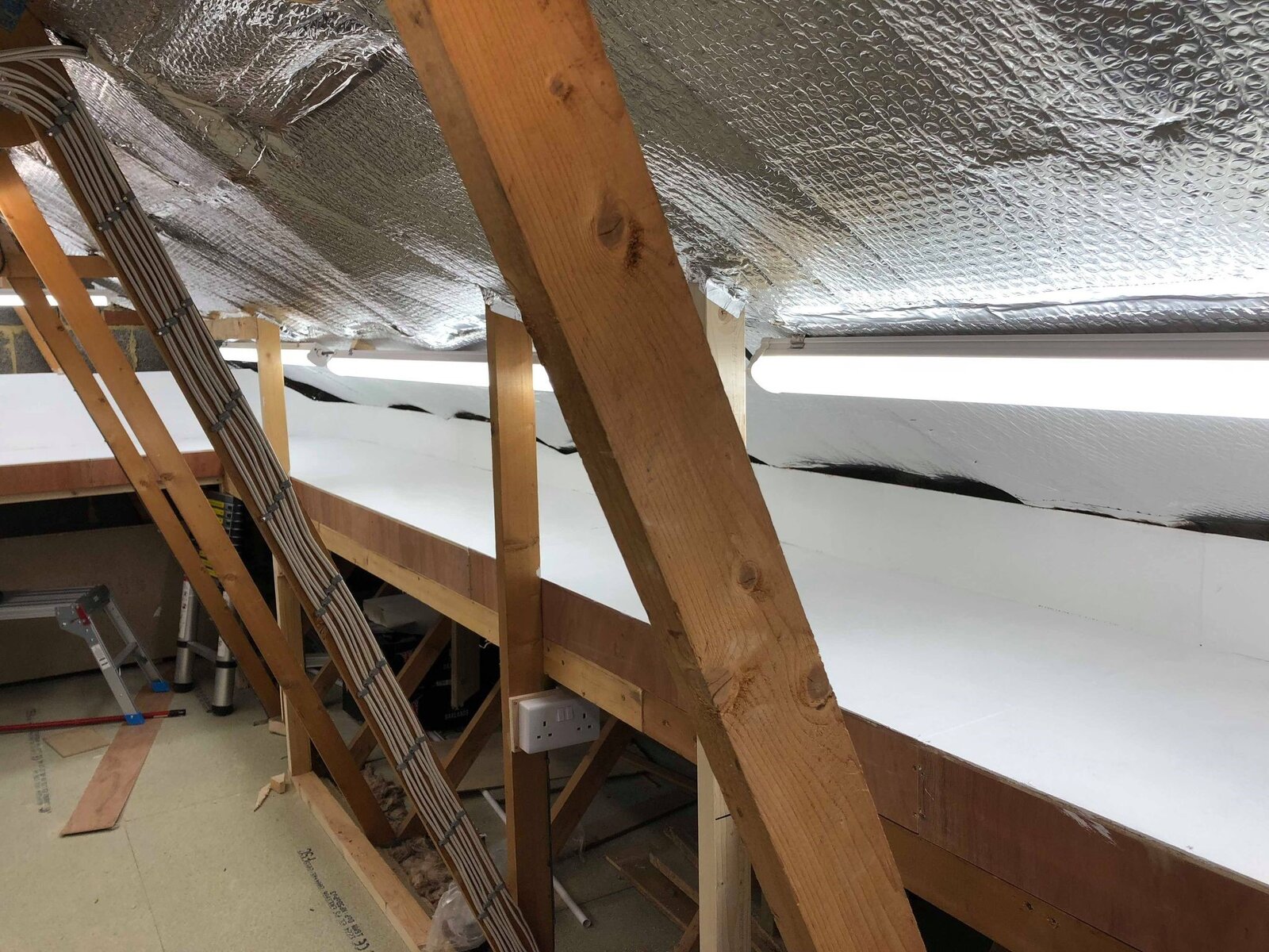

Hi Tony,

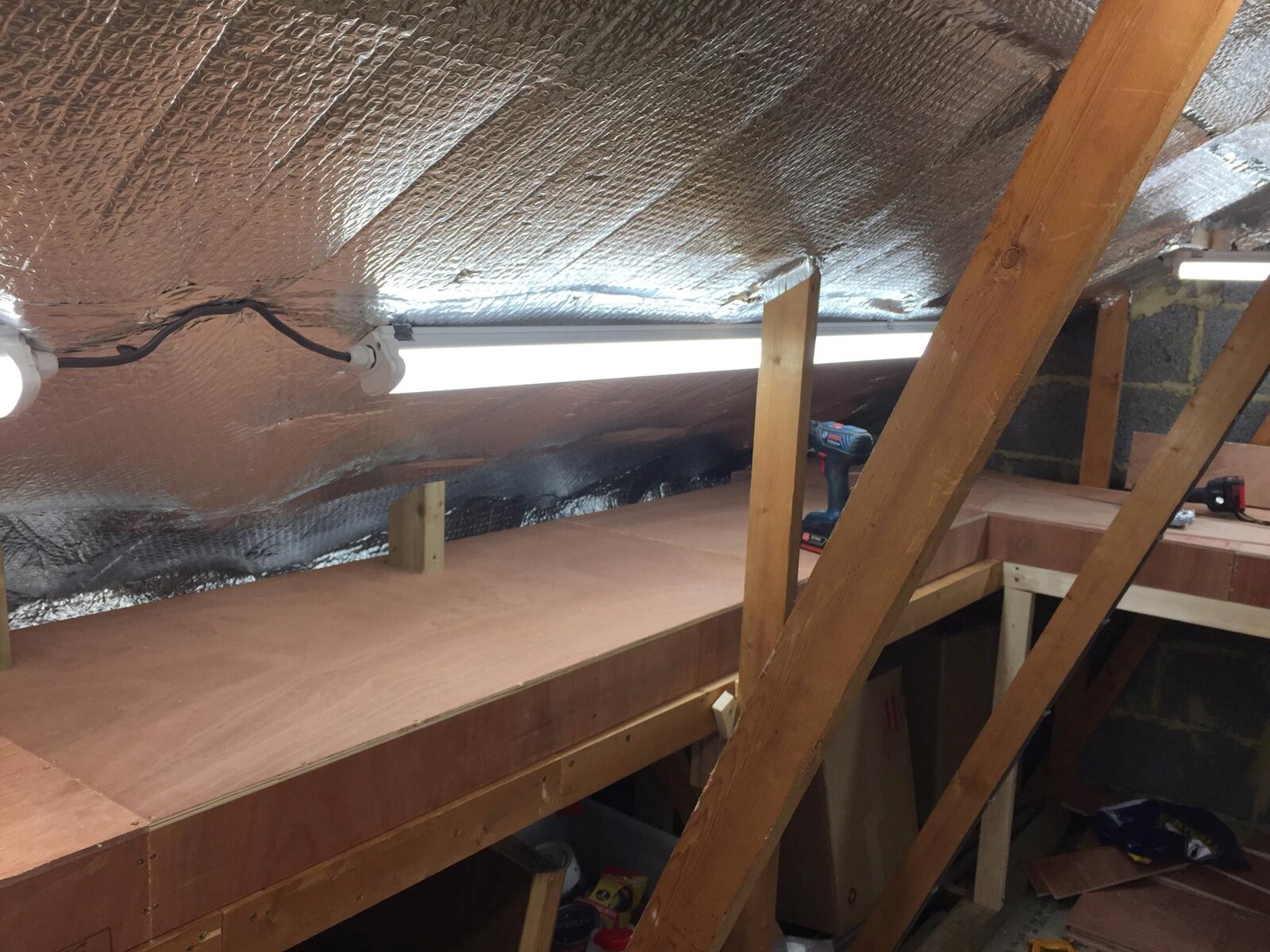

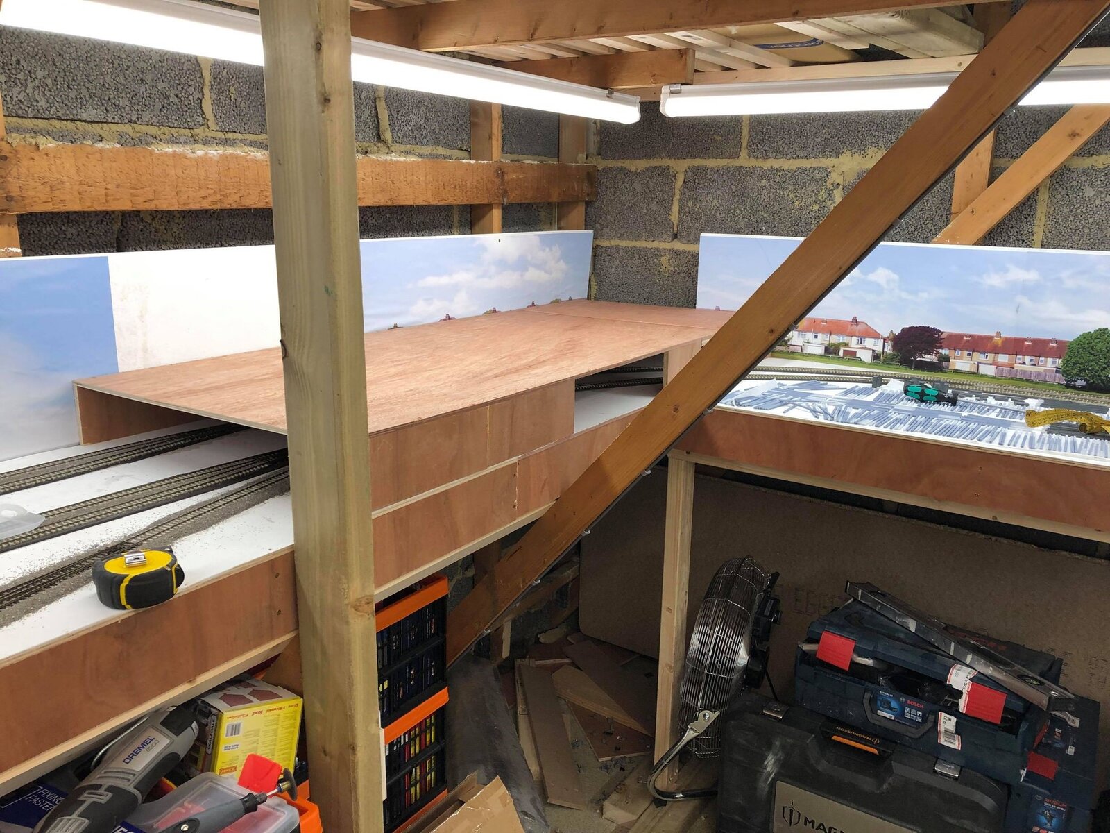

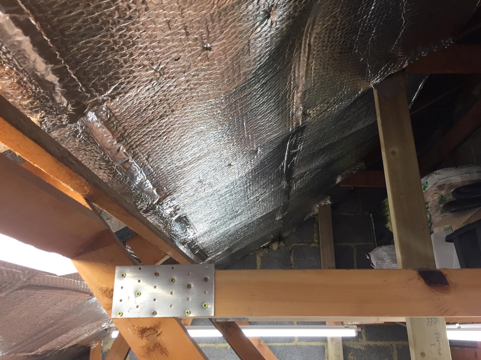

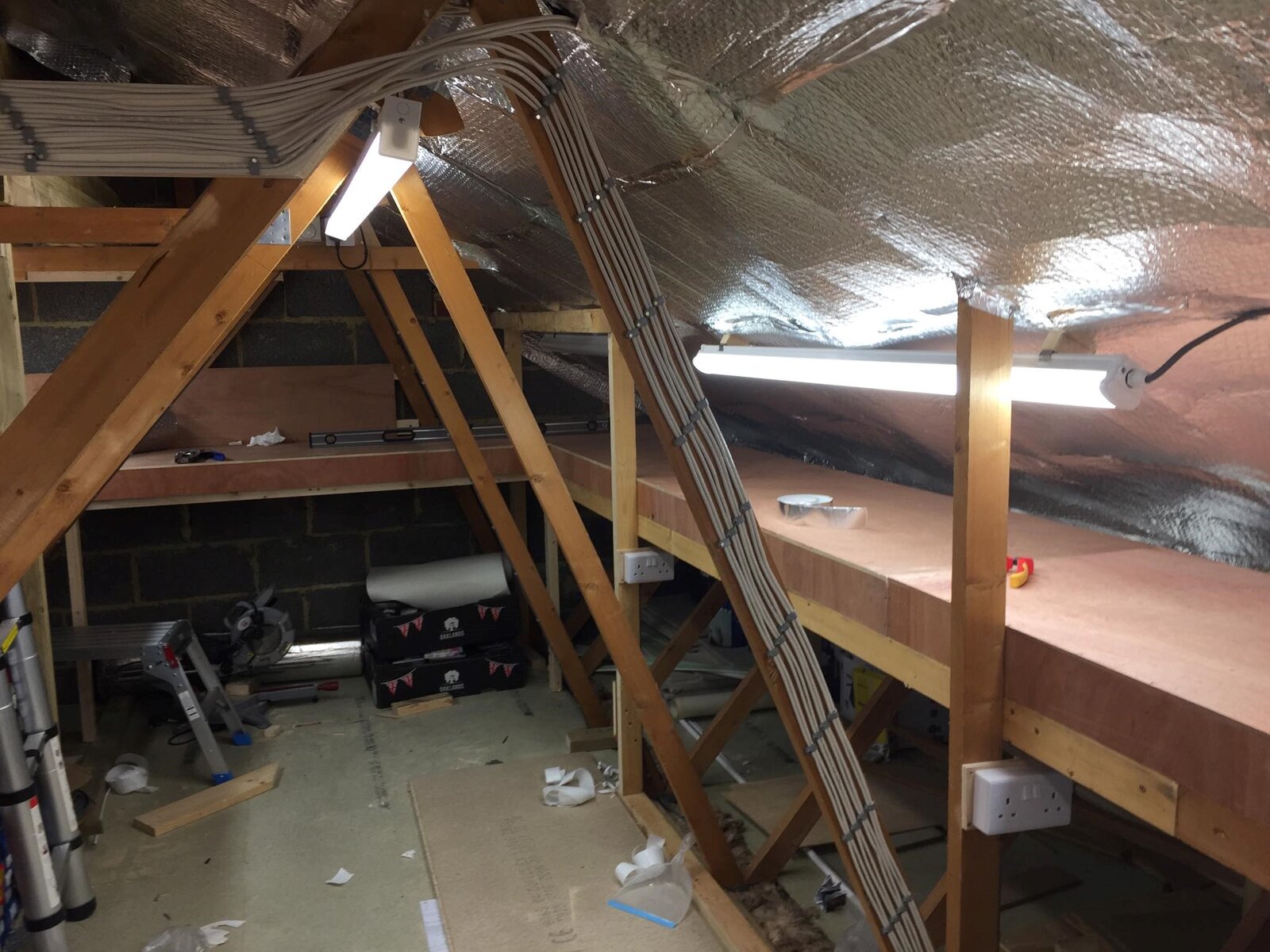

Yes they did. We replaced them with 4x2 timbers and added plates.
I've attached a few photo's (I think).
I haven't removed all of them. Only a couple While adding additional uprights for additional support.
Loft 9.jpg Loft 8.jpg Loft 7.jpg Loft 6.jpg Loft 5.jpg Loft 4.jpg Loft 3.jpg Loft 2.jpg Loft 1.jpg
Structurally it's probably OK - you appear to have put plenty of timber up there which could well compensate for any weakness. But at the end of the day it's what a surveyor comes up with (they have to find something!) and you may need to be prepared to get an independent view and report.
