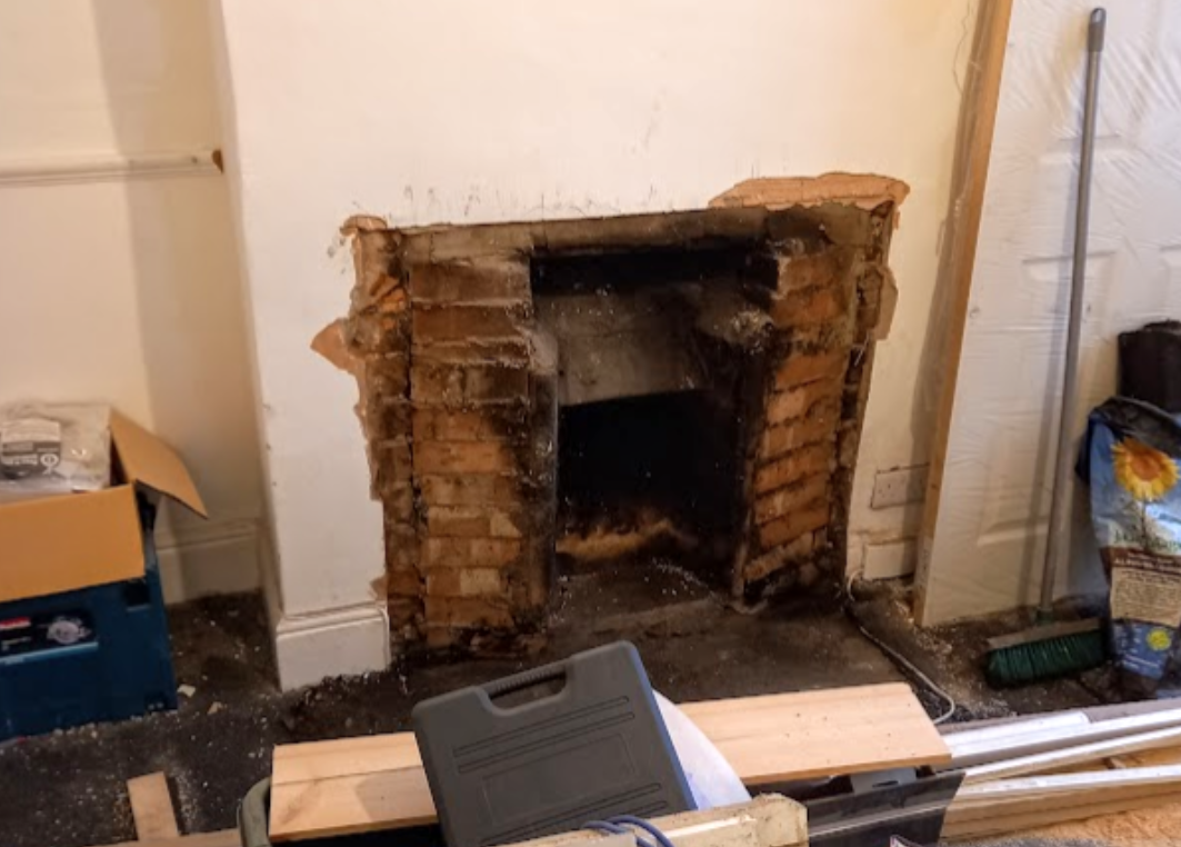

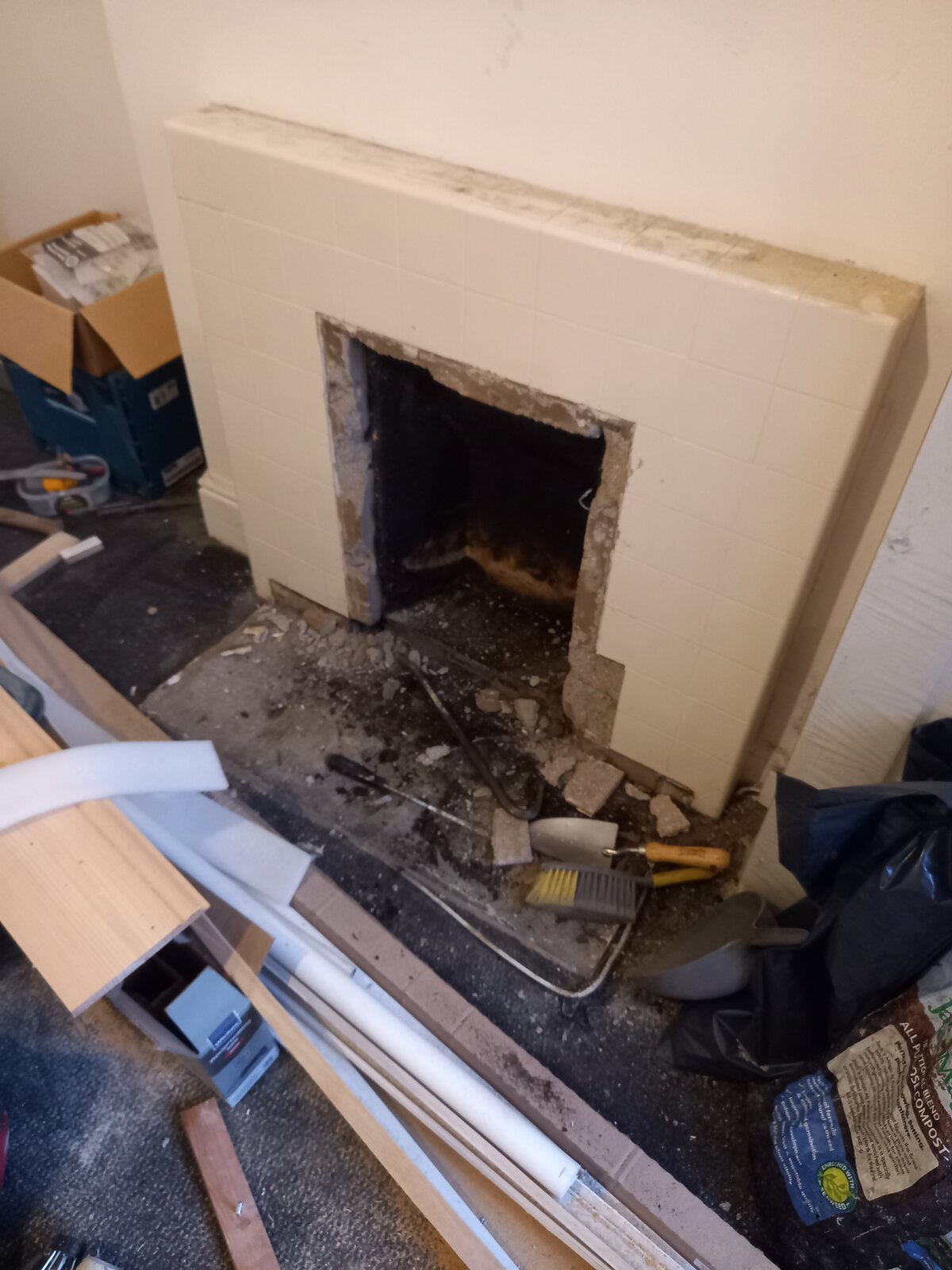

Removing a 1950s fireplace & clay fireback.
Well Your advice is spot on so far. The fireback came out in one piece & boy did they pack a load of
brick off cuts etc behind it. The fireplace was a surprise. I never thought it would be so heavy, I had to
cut it into six pieces. Rebars running through it & metal offcuts. Anyway, I'm slowly getting there. Thanks
for the advice so far.

I'd say it's a clay fireback. For most open fires you should cut them in 2 pieces along the scoreline. This allows for the different expansion as the bottom is much hotter than the top.
For certain fires, like decorative gas ones, you can leave them as one piece.

I'm sorting out the exact same thing at the moment.
So you're saying that I can simply remove one by one, the surrounding brick columns and the fire back will simply drop out? I assume that there is a lintel above this lot? Or maybe a brick arch?
I've booked to have this chimney swept and washed later this week with the view to blocking it up (with vent). Would it be better to remove the fire-back before sweeping or after or, does it not matter?

The lintel & the bricks that we can see are infill and can safely be removed but first hack off plaster above the centre of the lintel, go up a few courses & you should expose the original brick arch.
Only after exposing the brick arch can you remove the infill & lintel.
Leave the chimney breast outside corners intact - stay away from them.
How many fireplaces you have in the house? Then you have that many flues that might need sweeping.
Dont "wash" any of the flues or fireplace openings.
Definitely, It would be best to remove the fireback and the infill before sweeping.

There was an indented line where I take it you could break it in two. It pulled out in one piece
which was good. The council are a nightmare I asked in August & never got a reply.
