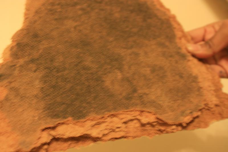

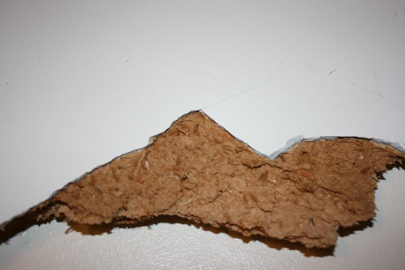

removing ceiling, bit concerned about black dust and cleanup
hi ajrobb, the boards are like hair type wood softer mdf type that comes apart easily, is this fibre glass? how worried should i be about asbestos?
1stProject; Have you any pictures that you could upload of the ceilings, so we can make a more informative response, sounds a strange type surface.
But to be honest if I can locate the joist, any cable and pipe work. I overboard straight to the surface.
If it's sagging boardes I screw them back up tight, if it's knackered lath/plaster and the property is empty, down it comes!
thanks patienceboyofderry, the board wont be stong enough to hold screws, i will put up a pic tonight though, my ceeling rounds off at the edges so i thinks thats where the lath and plaster will be, hoping noto to touch on that if i can avoid it
hi all, im not sure how u post a pic on here but the pic of the existing ceiling board is in my album anyway //www.diynot.com/network/1stProject/albums/

Definitely softboard - and the answer to why London is called " the smoke " google London Smog. ;)

I'm glad it's soft board. Once Henry has done his stuff in the loft, the boards should not make too much mess when they come down - nothing Henry can't cope with. ;)
