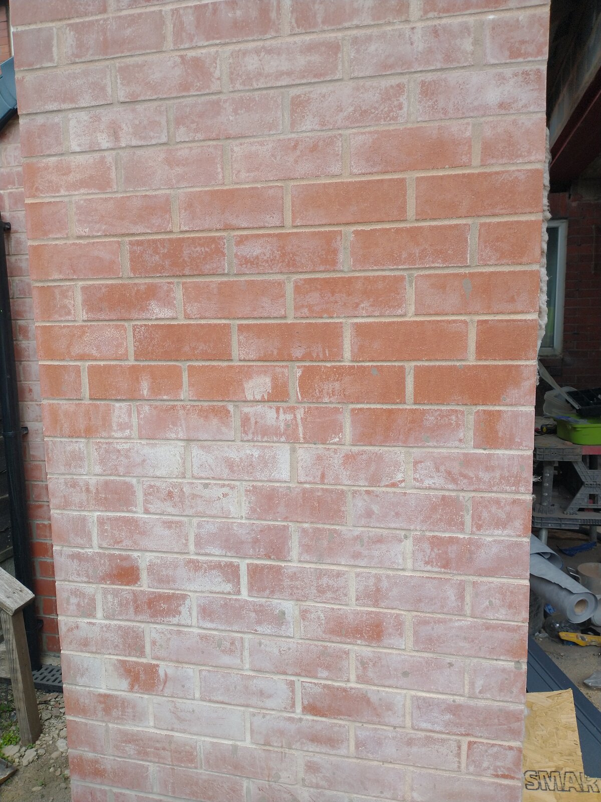

I'm naughty and lazy. I left the top of my extension cavity open to the elements over the winter and have terrible effervescence. As a trial I had a very quick go with the brick acid, I think you can see that it does work:
