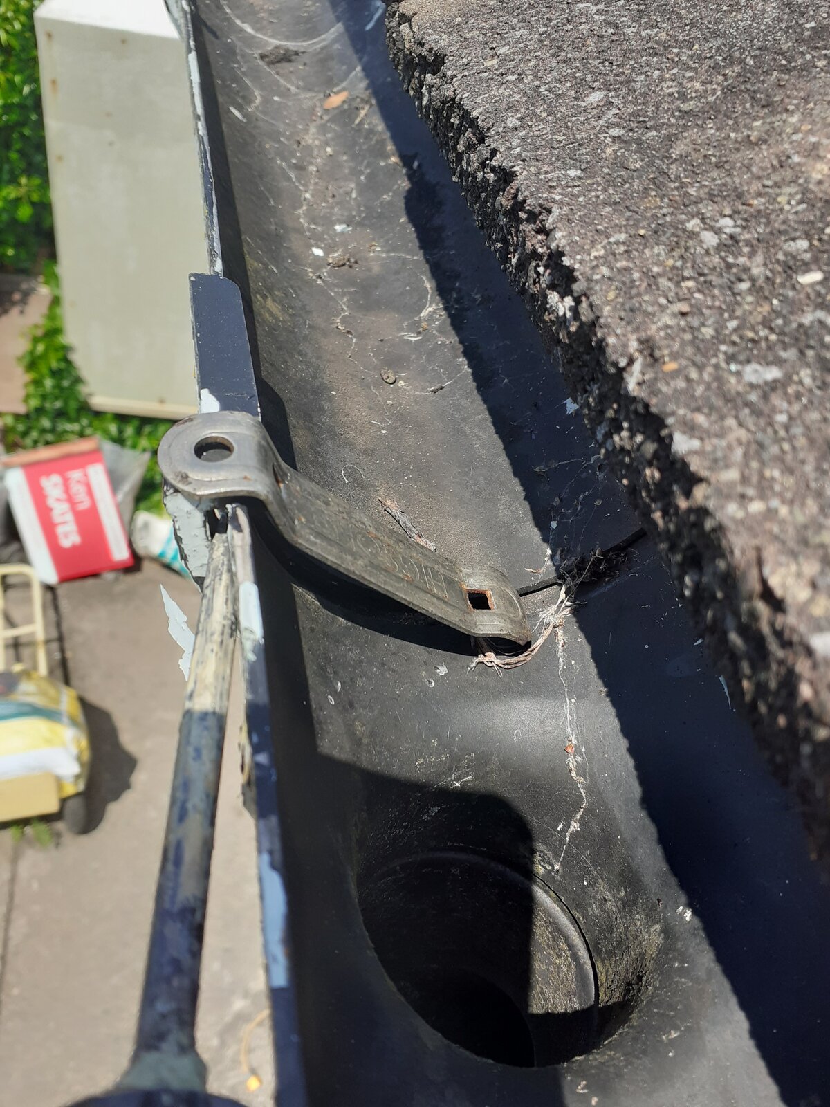

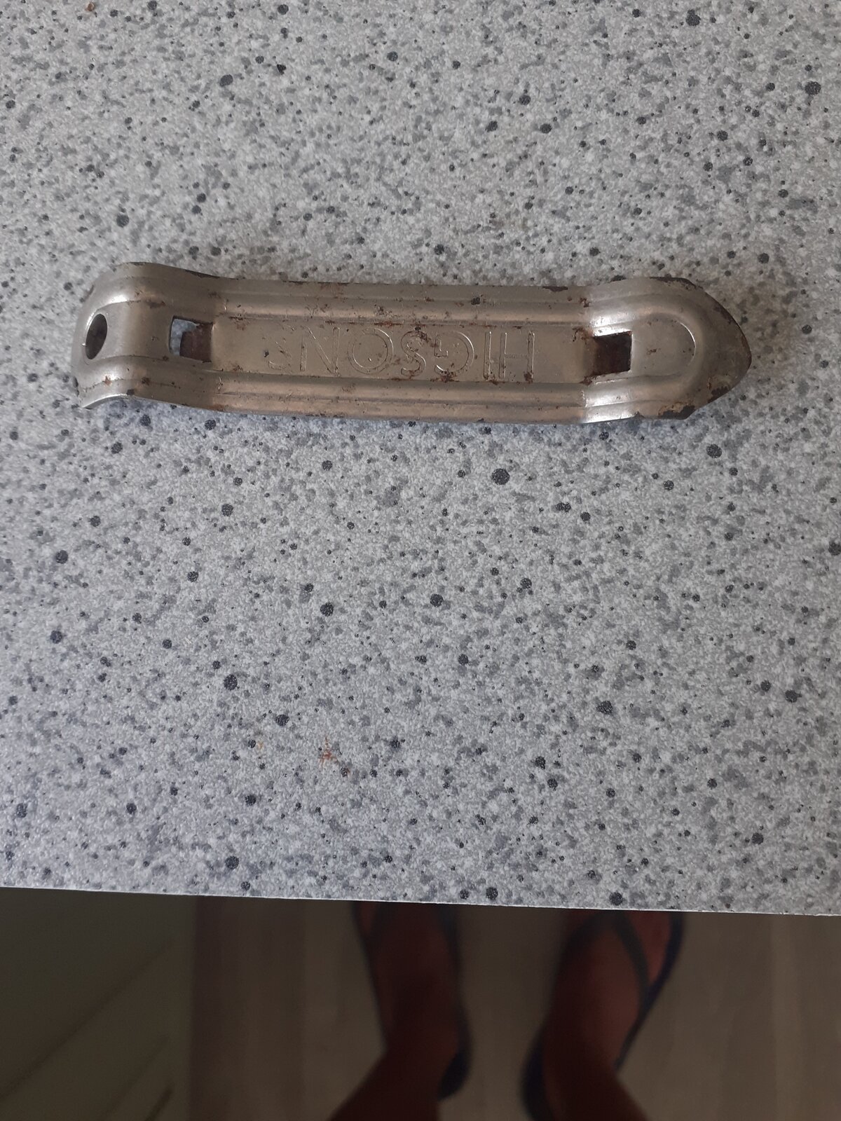

Just having the same problem, found that an old school bottle/can opener plus a medium flat blade screwdriver worked quite well
Never thought of using a bottle opener. For awkward ones, I use slip jaw pliers.
