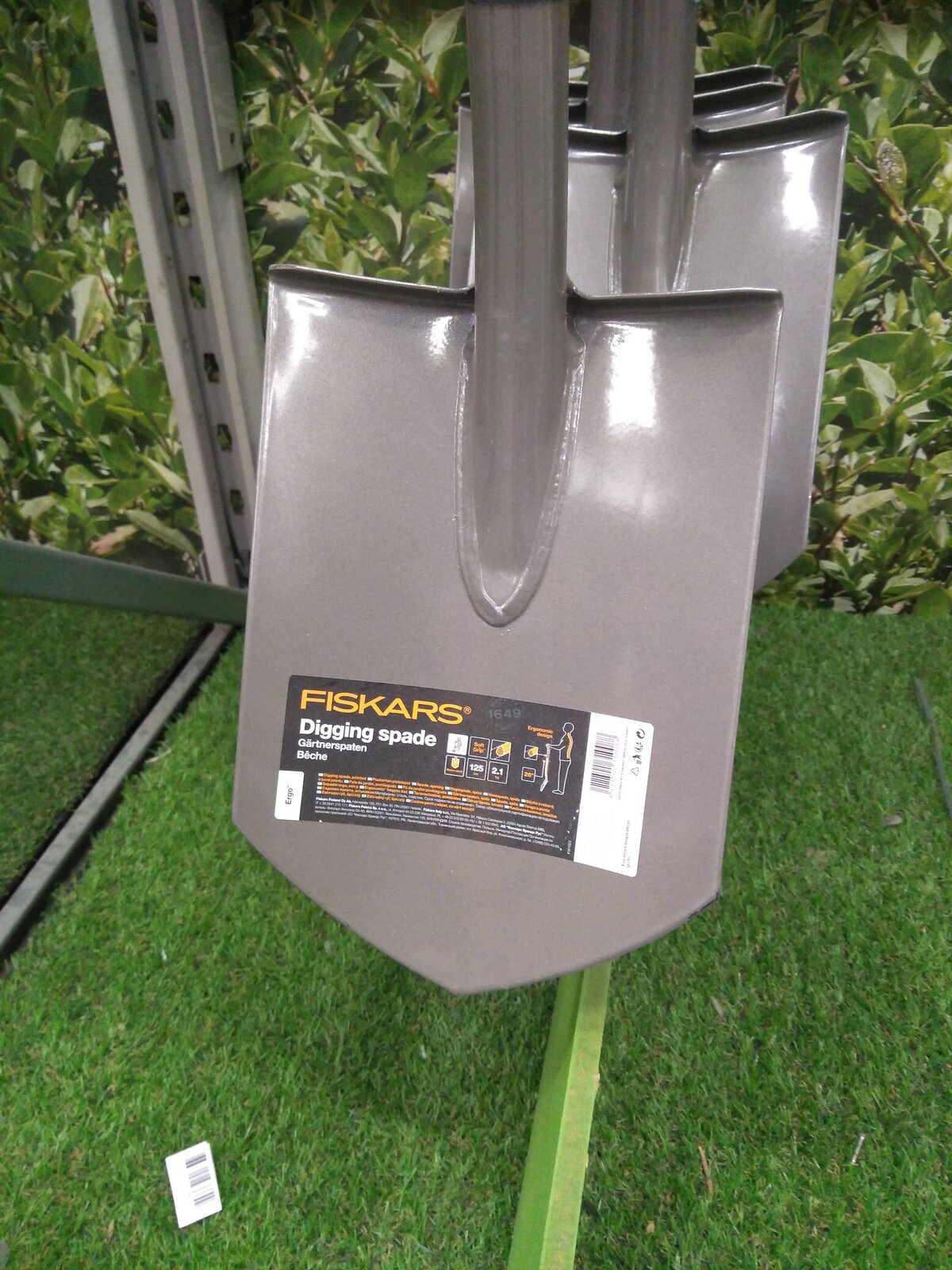

Looking through some old photos i found a photo of the actual Spade we bought from 2 years ago (it was a "should i buy one of these?" photo i was sending on WhatsApp and the answer was yes)
