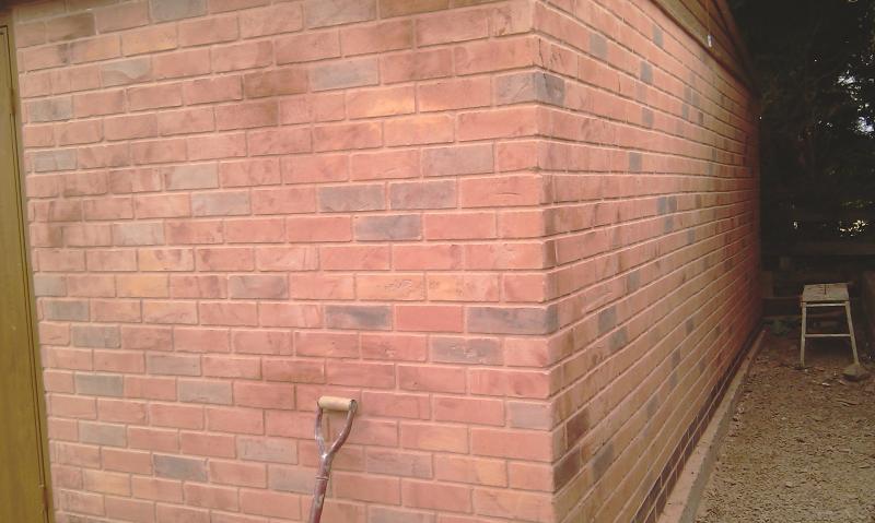

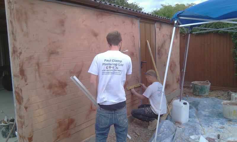

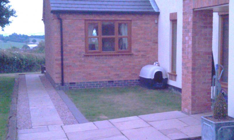

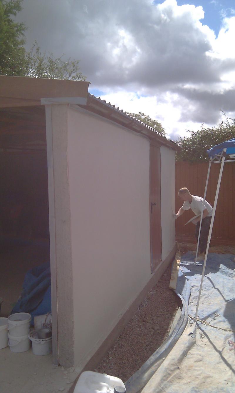

If the render is solid and unpainted the you you could use a polymer modified base render with a mesh re enforcement and top in whatever decorative finish you desire, wether it's a modern flexible acrylic, pebble dash or brick effect like the following
the last pic is of the brickwork we emulated
Loads of effects can be re created
