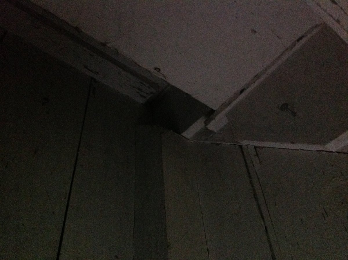

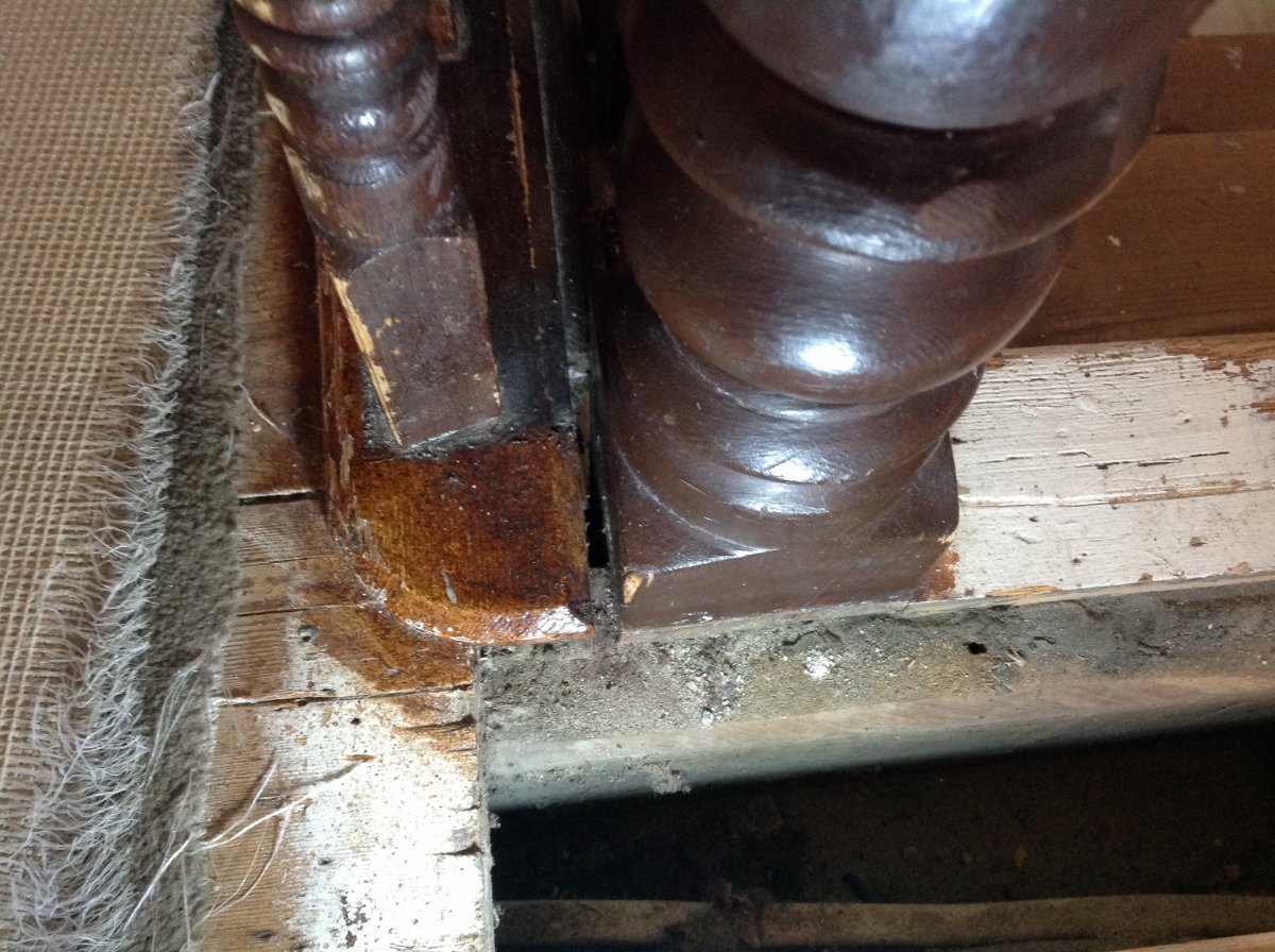

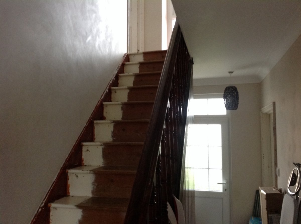

Hi all.
I would like to remove the sides of my stairs, so that i can shove my computer under there. My problem is I don't know if the 3x3 in the corner is helping supporting the stairs. Not completely sure of the terminology, but is the ringer attached to the newel, and newel is attached to landing beam. Don't see any brackets or anything though. Please see images attached. I welcome any advise.
Regards
John

The stairs will be self-supporting - you can take the wood panelling out. Think of your stairs as a ladder propped up between the downstairs and upstairs floors.
(BTW, the bits at the sides are strings).
Thanks Tony.
I also think the stairs are self-supporting, but wanted a bit of reassurance before I take the sides and 3x3 off. I don't like the fact I cannot see that the string is attached to the beam. Can you have a good look at my photos and explain it to me?
Sorry to be a pain, just that it's an old house that has been bodged in alot of areas.

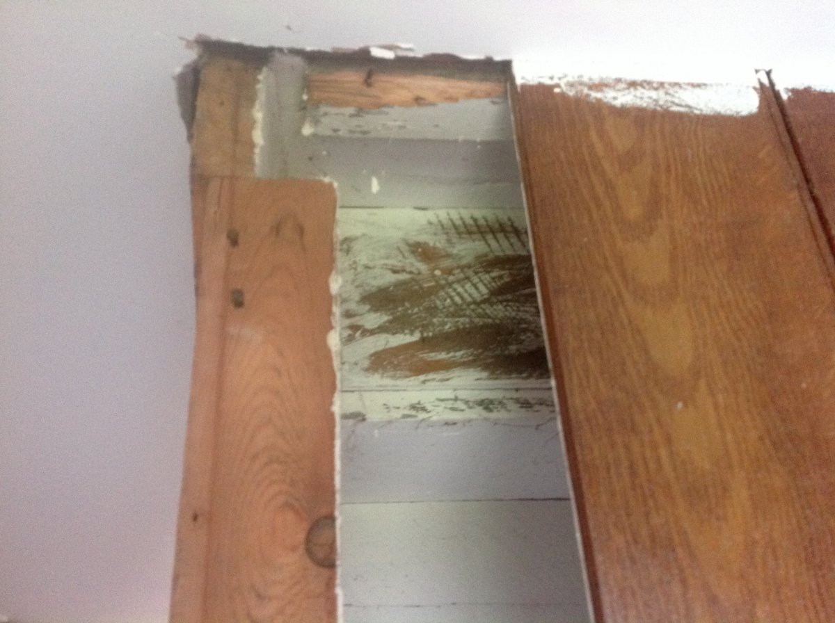

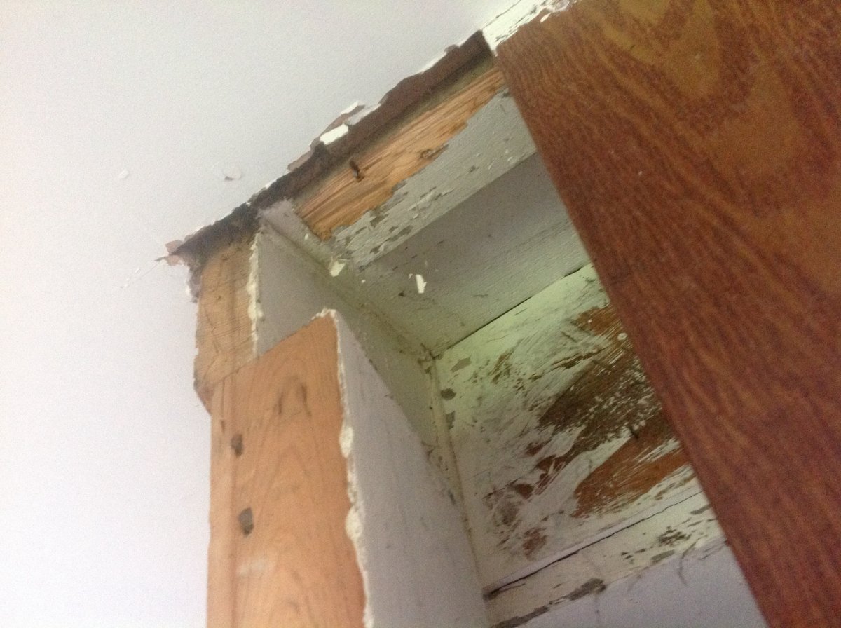

Hi all,
I went to attack it, but after removing the sides, i got scared to remove the 3x3. Do you still think from the new images that the stairs will be ok without it?
John

The strings of the stairs will be supported against the floor trimmer (beam) at the top, so they are not suddenly going to fall
when you take the post out.
As before, think of your stairs as a wooden ladder. A ladder justs rests against the wall at the top - it isn't supported by a
prop against the wall as well.
That 3x3 will have been put in after the stairs were fitted, and is just to form a corner for the boarding and door.
It appears to be cut on an angle at the top. That is probably just to fit under the string. If the post was structural, it would have been
cut square at the top, and the string would have been cut level to fit on top of the post. But they would never have supported stairs like that anyway!
Stop dithering and get the damn thing out!!
