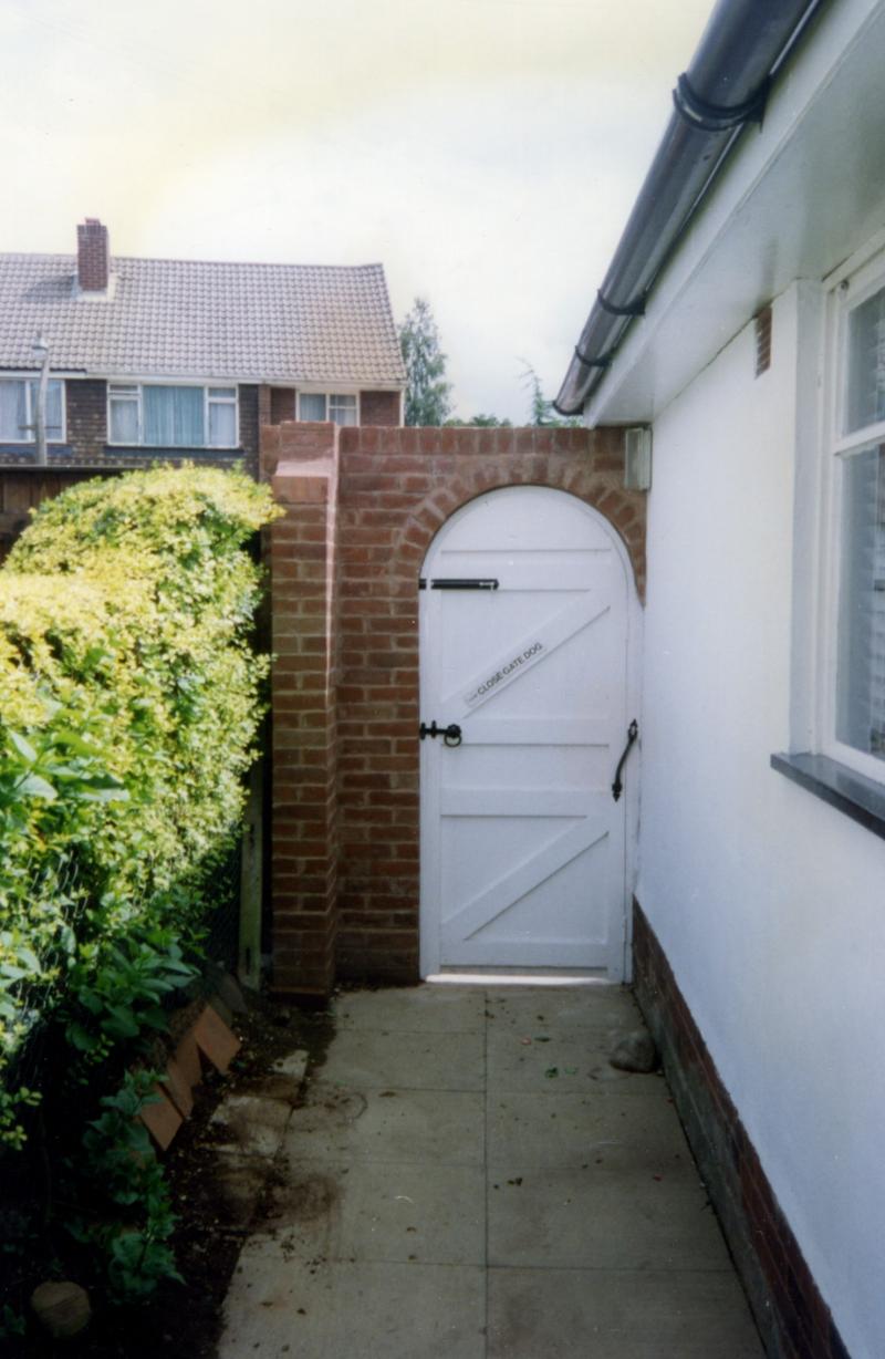

removing top layer of damaged bricks
24 Apr 2013
12
West Midlands
:( Some time ago our side gate was replaced with a brick structure and around top gate (see photo) unfortunately the builder used the same standard facing bricks for the top layer laid on their side. Long term weathering and water ?frost etc have caused the top layer to start to break up. They need replacing with engineering bricks which I have sourced. My problem is to ensure that I have the right tools to remove this top layer without disturbing the underlying structure or the rendering which is on the outward facing part of the structure. Currently all I have is a brick bolster I have a strong feeling in the general waterworks that this is not wot I should use to accomplish this task without rending of garments and kicking next doors cat. advice please for which eternal thanks.
If the mortar isn't too strong then club hammer and bolster would do the trick but work in line with the wall not across it - so start at the fence end and work towards the house. Otherwise it's an angle grinder with a stone cutting disc which will cause less vibration damage to the rest of the structure?
I agree with the above.
But you only have one course above the fragile arch, and the slightest disturbance will mean having to re-build the arch. Go very lightly.
Stay away from the soffit.
Why not consider some coping or capping bricks instead of what you have. Dont try to match-up, go for a contrast and make the top course a feature.
